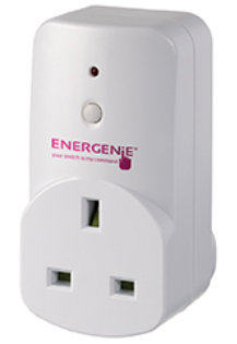

I have a campervan that isn't used a lot during the winter etc, but I do use it now and again. I have recently replaced the starter battery. (No leisure battery at the mo) Normally when not in use, I charge the battery with a charger ever so often just to top it up. The charger is set up inside the van with the power cable running into a socket in the garage, so can be left set up permanently. I have recently got some smart plugs that I can set timers etc. So..... my idea is to set a routine where I can automatically set the battery charger to to come on at a certain time and go off a certain time. My question is, how long and how often should I set the charger to come on just to keep it topped up? I have tried solar chargers and they are rubbish in the winter. I could just disconnect the earth from the battery, but like I said I still use it now and again and that would be a pain in the arse and it would probably still lose voltage over time anyhow. Any advice would be fab!

If that is a voltage controlled charger, as mine is, then I have mine coming on for 15 minutes every day, previously via a plug in time clock, but now on an Alexa controlled Smart Plug. My car has a total discharge of 20mA, whilst parked, which equates to around 0.5amp hour per day - 15minutes on a charger, will more than put that back in the battery.

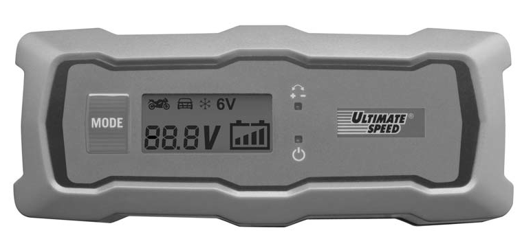

Lidi and Aldi do from time to time do chargers like this ChargerA.jpg Ctek do a range but the price is a lot higher, seem to remember last one I got from Lidi was around £15 the Ctek MXS 3.8 is just under £40 from internet, looking at £44 for the Ring 6V/12V Smart Car Battery charger from Halfords.

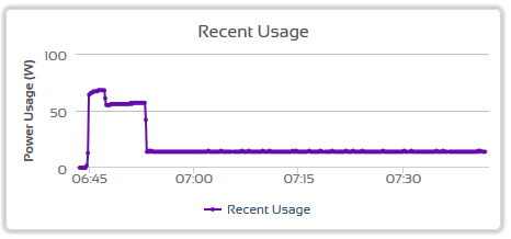

How long a battery needs charging varies, and I have used one of these Energy-monitor.jpg to monitor the way the charger works, and putting the batteries off caravan on charge at just 0.8 amp using the under 12 Ah setting, and it has dropped to the 0.1 amp setting in well under an hour. Typical graph for a discharged battery charge22-4-20.jpg the 3.8 amp charge rate is very short lived, the 3 amp is not much longer, but the 0.8 amp can last for days, before it drops to 0.1 amp, this is because the lead acid battery simply can't recharge fast, it takes time to absorb the charge, before the smart charger I would use a fixed voltage power supply at around 13.2 volt.

If I talk about the Lidi charger, the rest do some thing similar, I have two selections, under 12 Ah and over 12 Ah (plus 6 volt but that does not interest you) in under 12 Ah it will charge at 0.8 amp until volts hit 14.4 volt then it will drop to 0.1 amp and when at that charge rate it hits 14.4 volt it switches off, and it will stay off until the volts drop to 12.8 volt. In the over 12 Ah mode it starts at 3.8 amp, and steps down to 3 amp and 0.8 amp and finally when again it hits 14.4 volt drops to 0.1 amp and when the voltage drops to 12.8 volt will return to 0.8 amp charge rate.
So if I monitor it the voltage seems to remain at 12.9 volt 98% of the time, when it turns back to 0.8 amp charge rate it only stays at that rate for a few minutes, and if I did not have a monitor I would not know it had gone to the 0.8 amp rate, even with a large 90 Ah battery in good condition it only returns to 0.8 amp for around 5 minutes.

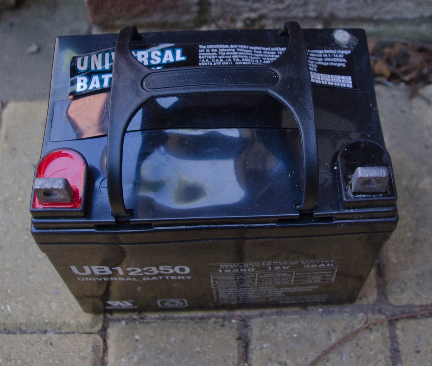

The Lidi charger will only return to 0.8 amp, and will not restart charging after a power cut until you press a button, this means if a cell should go short circuit, then only 0.8 amp so lot explosion risk, the Ctek will return to the 3.8 amp output, and does not need you to press a button to start it charging, so is liked by caravanner as will work as stand-by charger if built in one fails, but should a cell go short circuit then more risk is involved, this DSC_3937.jpg was the result when one cell when short circuit with a pair of mobility scooter batteries 35 Ah AGM with a 3.5 amp charger, they were left on charge in the garage as done many times before, and normally the stage charger would have switched off once charged, but shorted cell resulted in it did not switch off, this is why I do not use the caravans built in charger when it is stored, can you think what a 35 amp charger would do? Cells don't often go short circuit, and the smell soon tells you when they do, bad eggs smell, so when your around the battery you will know, but if not visited you don't know, and you can see the result.
Warning hydrogen burns with a blue flame very rapid, and if a spark does ignite it, it will expand faster than battery vents can handle, so the casing fails shooting bits of plastic and acid out, i.e. it explodes, wear glasses, don't smoke, and have water available, and don't work on your own. Some one pouring a bucket of water over you could save your eyes, so always have some one else around when working on batteries.
