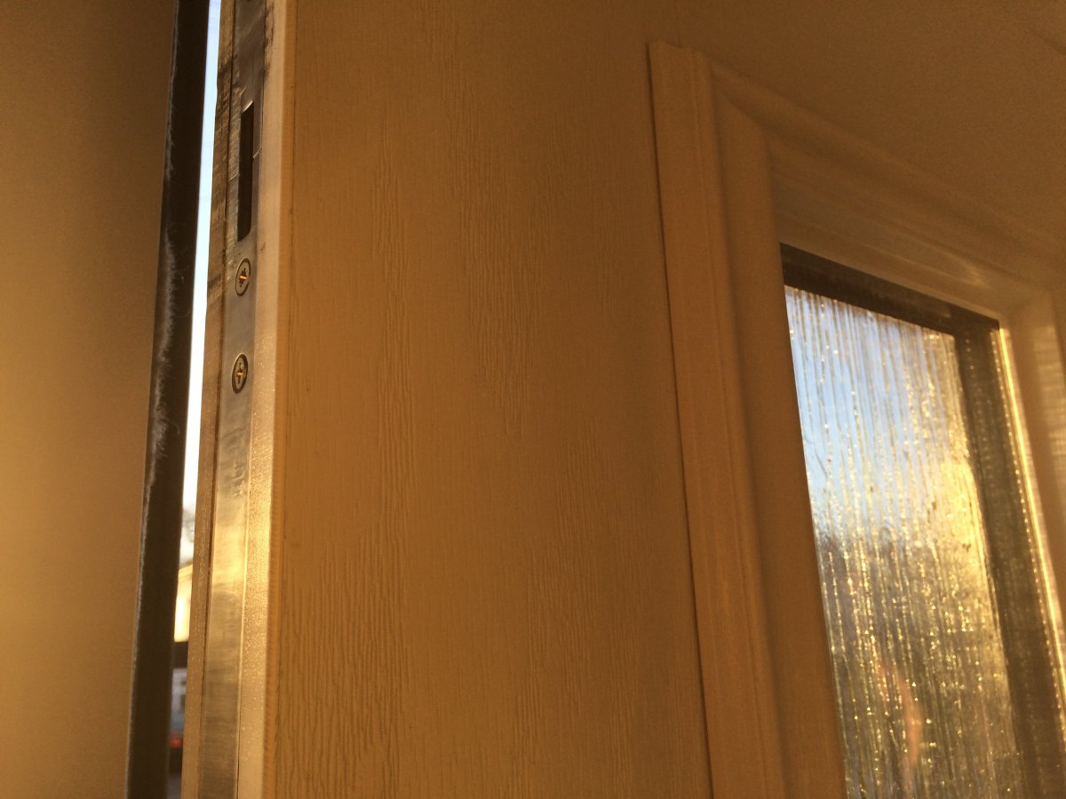

Hello,
I had a Veka composite front door fitted just under 3 years ago. It is a front door with 2 side panels (with windows). All came as a Veka package from installer (i saw the labels so know it is genuine).
The door was a tight fit to start and was told it would 'loosen up'. Now, a couple years in it is really annoying as it seems to be getting worse. I can see the door just clip the frame when closing but cannot see anything loose that tightening would fix.
Fitter claims adjustments or installation problems are not covered by warranty after 1 year and they will not come and assess. They are FENSA and I kind of expect better. I went FENSA and bought a good brand door and just did not expect this so soon. Am i being unreasonable to expect this fixed by the installers? Should Veka composite doors 'swell' or warp?
Thanks,G

What is actually tight? Closing the door, Lifting the handle, Turning the key etc
Can you take some pics of the hinges and latchs in the frame and one of the whole door/sidelights from the inside.
When the door is closed is there a fairly even gap all around the door to the frame (around 4-5mm)?
Adjusting may well be all it needs, if you could post pictures of the hinges and where the door is catching, whether the top middle or bottom on the lock side

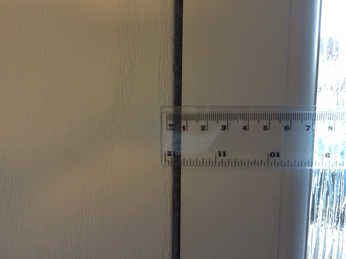

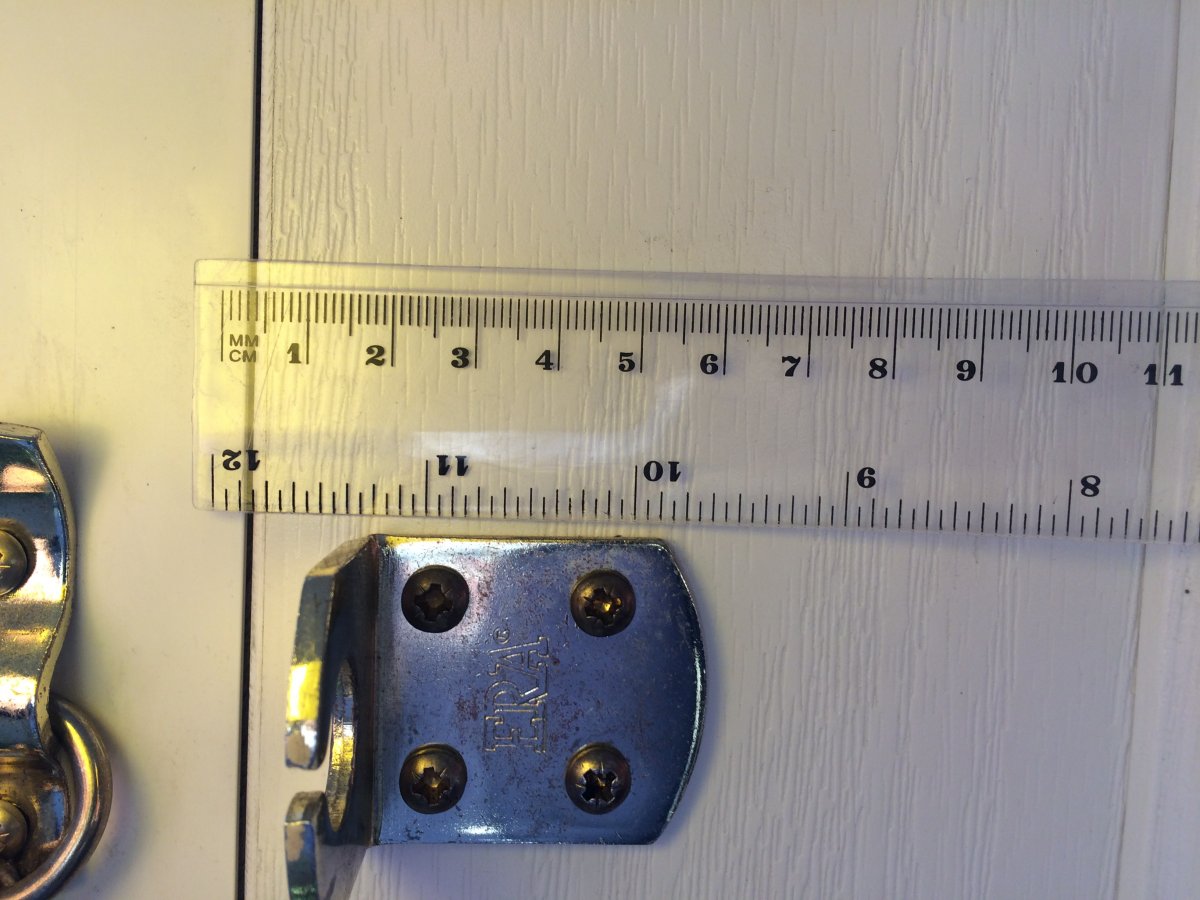

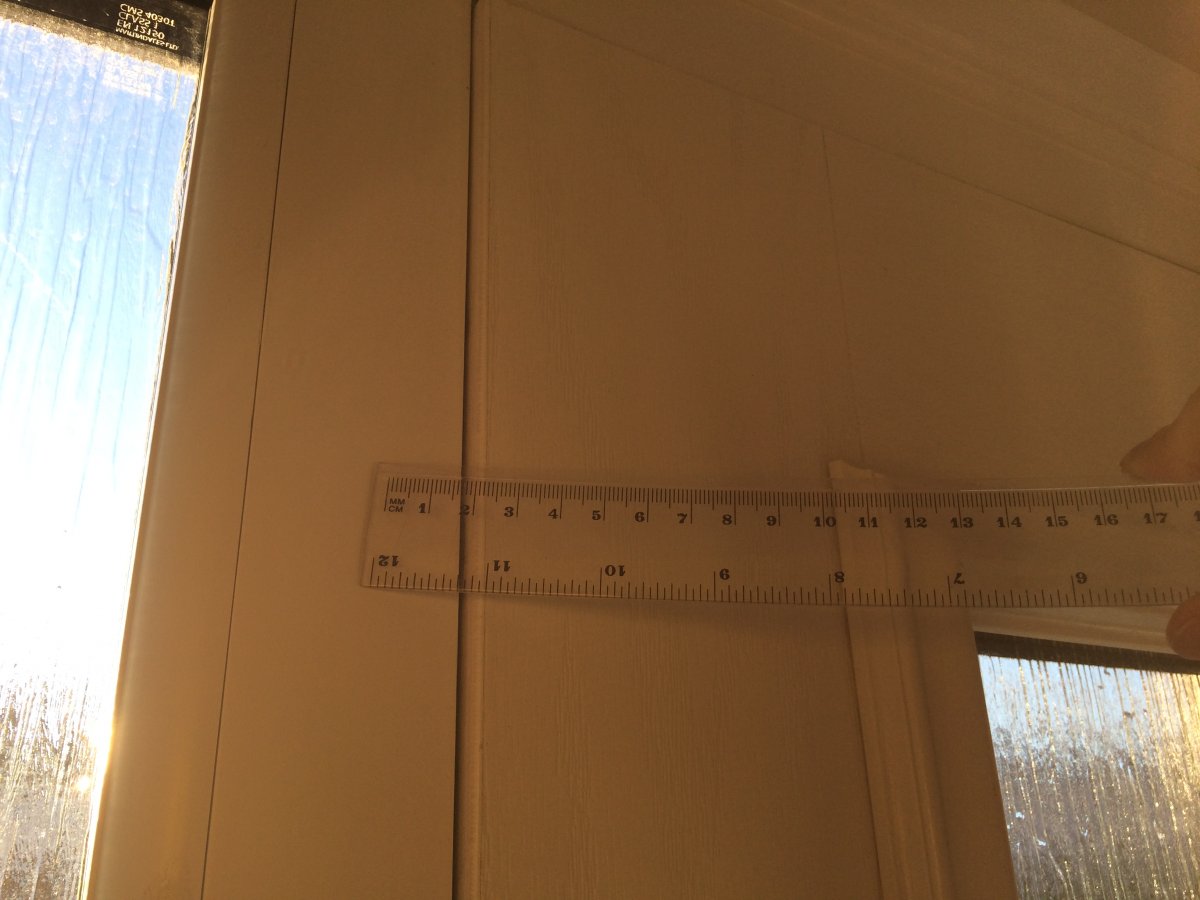

The door itself is tight - it catches mostly at the top when closing - clipping the frame. Lifting the handle is mostly fine though it needs a slight push/tug to line up the security bolts as the door sticks out a bit (see pics). In answer to the questions:
- The gap around the door frame is not an even gap - on the hinge side it goes between 4-6mm but on the closing/lock side it is about 2mm.
- warranty I was told it was 10 years but when i finally received the documentation on one or two things it was 10 years (welding, distortion, glass seal) but most timed out after 1 year or so.
- don't know the insurer - will have a look if there is one.
I am starting to suspect the fitter measured wrong and tried to cram it in. But don't understand how that can be with the side panels all made to fit. I take it FENSA etc don't care about this stuff?
Worse - does that also mean it is not fixable? Have to replace the whole thing?

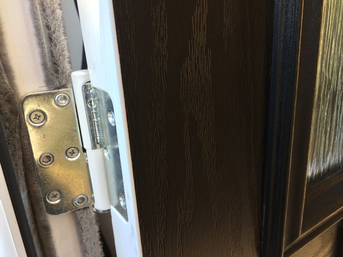

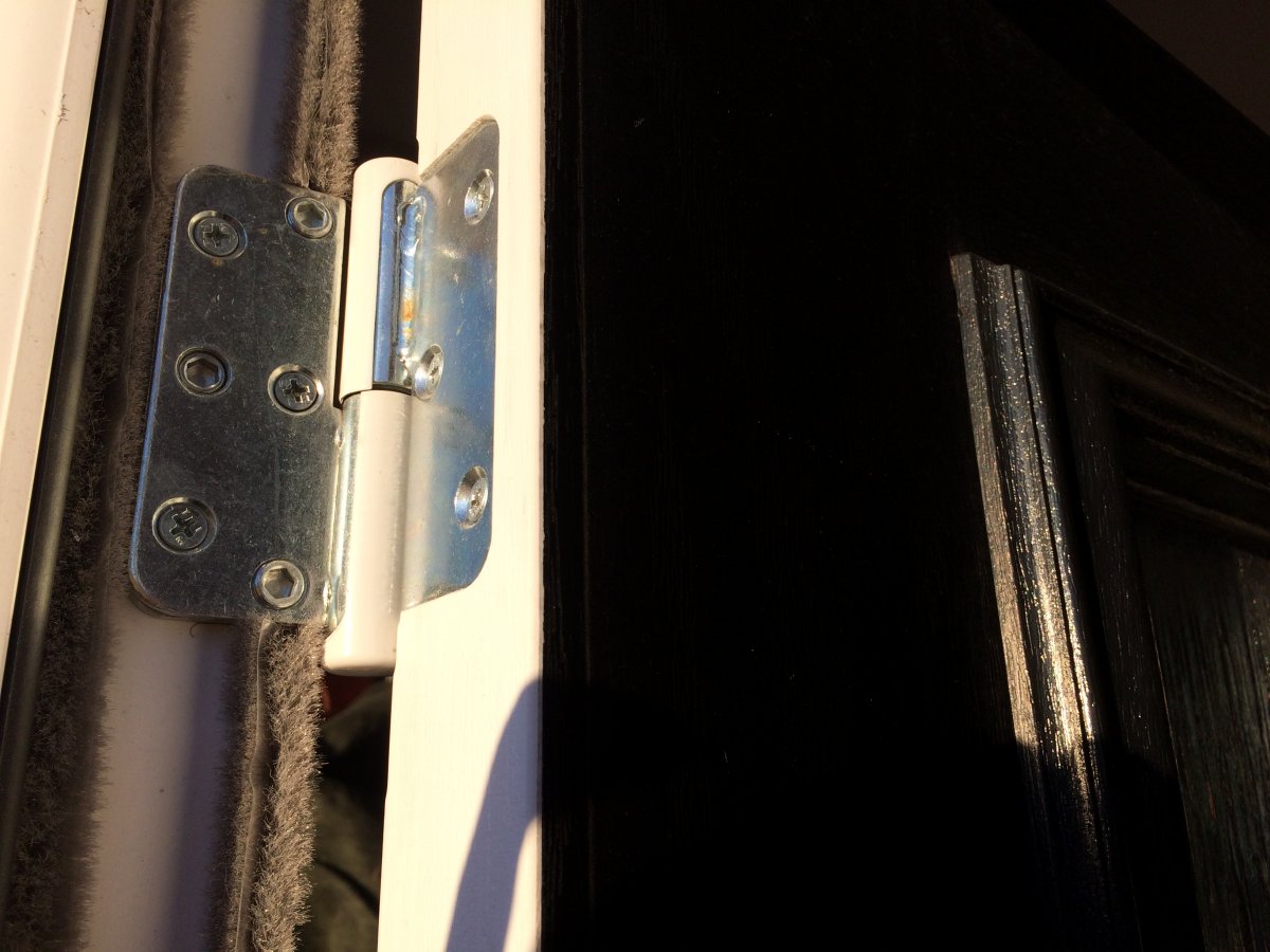

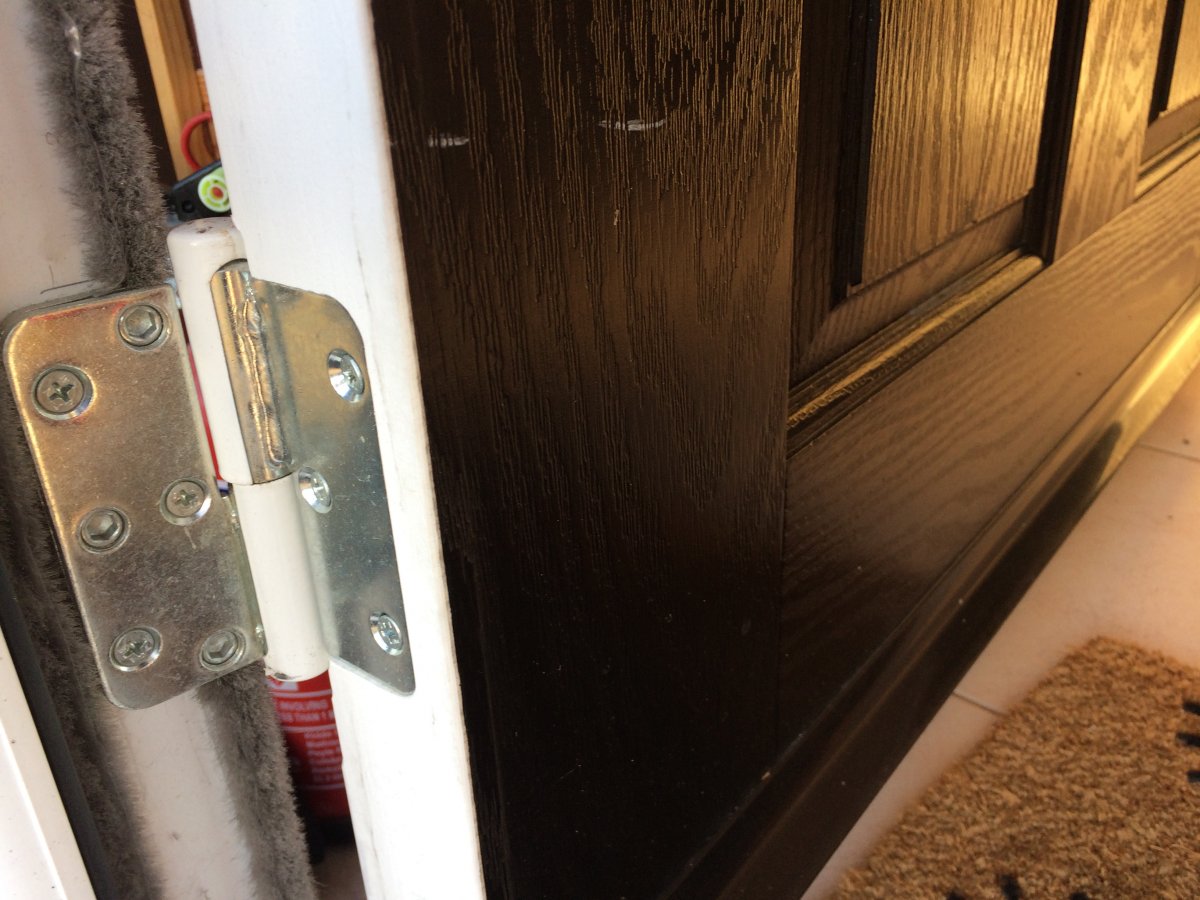

Again I'm unfamiliar with those hinges (I have seen similar) but I expect they are adjustable, I expect the plastic capping on the hinges just slides off, If you can pull the caps off and take another pic.
The door looks too tight on the handle side, Hopefully it can just be adjusted over.
Very worst case scenario assuming they had measured the frames tight or the door frame is fitted badly out of level/bowed then it would most likely be possible to remove and refit the frames (possibly with having to cut the ribs off the edge of one or both sidelights). Probably a days labor for a good fitter to do. Thats very worst case! It should be adjustable assuming it is not already on max.

As for the OP , Fensa won't care one iota about the fitter not coming back out unfortunately. As Gazman says though , I reckon those caps pull off and there may be some adjustment screws, again not a hinge I've seen on a composite door
Not a hinge I'm familiar with but it looks like the 3 Allen grubs tighten in and stand the hinge away from the frame once you've loosened the Philips screws but it looks like they're backed right off
We have got similar hinges to yours on our windows and front door- ours have more axis for adjustment though. You should be able to slip the white cap up and get access to a bolt (Allen or Xex) to allow some height adjustment.

The problem is now sorted and for your time it is only right I would update you all on the eventual fix.
Seems like poor initial installation.
The hinges were adjustable with a hex/allen key but they had been adjusted already to the maximum. The solution was removing the metal 'packer' located behind the hinges (removed the upper hinge packer). I would have preferred not doing that as it appears a little less secure (the hex bolts made it seem like there were lots of screws holding the door in). But the door closes easily now!
Just loud now due to the plastic that lines the insulation fibre/cloth around the edge/rim.
Thanks guys, let me know if you would like a pic.
Total bodge up, the aluminium coupler is there for a reason.
I'd request for the door to be refitted!!
Was this a Veka approved installer who advised on this?
Not sure it was the coupler removed DH from his description, Sounds like it was a shim of some sort behind the actual hinge. Still not the correct way to do it, as the door should have been fitted with some adjustment available
