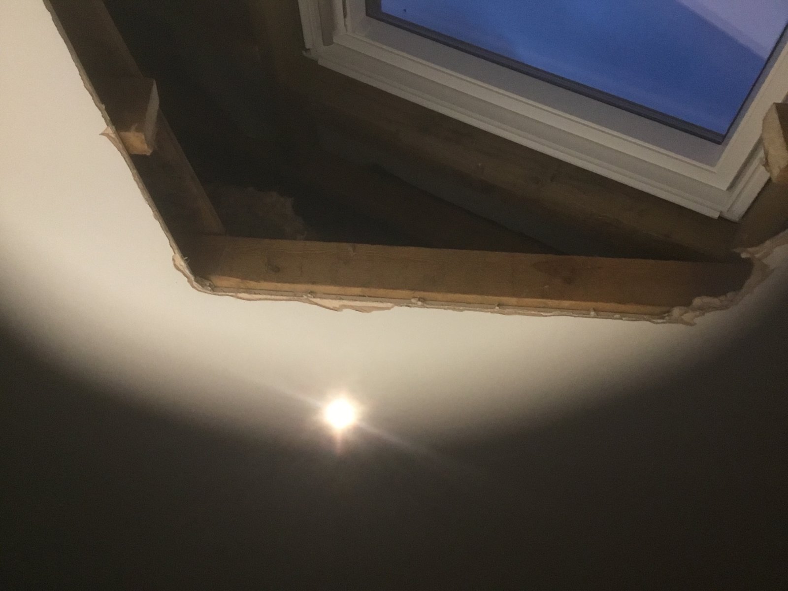

We have had a velux put in, nd carpenters coming to make tunnel. However we have to put the insulation around it. This has gone into a lean to pitched roof. Building control want to see the insutlaiton and have mentioned 140mm,
We can’t get our head around this. Do we put 140mm of rockwool up on the sides and tack onto the wood, or use masking tape to fix, then plasterboard over the top, slotting into the grooves? Or do we use that Celotex stuff, confused,

Hi, to be honest they aren’t that interested. This is an old lean to roof. 4 metre by around . It had 100 rockwool in the rafters so they asked for 200 to be put over top, and they asked for 140 up around the sides of the lightwell. We want to do it right though. I have seen pics of the membrane, behind the plasterboard. BC have suggested rockwool, so we thought we would just use some of the 200 we have left and try to cover as much of the sides as possible. But just dint know how to attach the rockwool to the wood struts of the loghtwell to make sure it doesn’t fall down after we close it up. No access after, it’s not a loft hatch.
Re ventilation Bc said allow 50mm near the eaves, it’s a single story lean to, so fairly easy to see. Velux is right on the edge. So can’t get much insulation in that side. I just don’t want condensation or the insulation falling out after we seal up,the plasterboard.
There’s a pic,

See what you mean. Pity they had not installed the Velux a bit higher up the roof I think. The insulation is between and over the ceiling joists which are the horizontal timbers, but they have cut the ceiling joists without trimming the opening with joists !
Perhaps one of the more practical builders on here could advise how to support the quilt insulation on the sloping /vertical sides of the lightwell ; but how do you get access to install the insulation.
