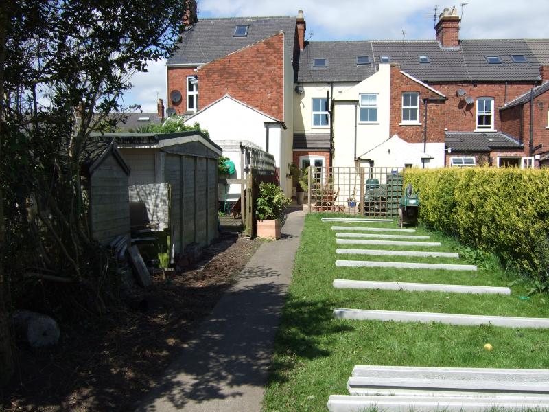

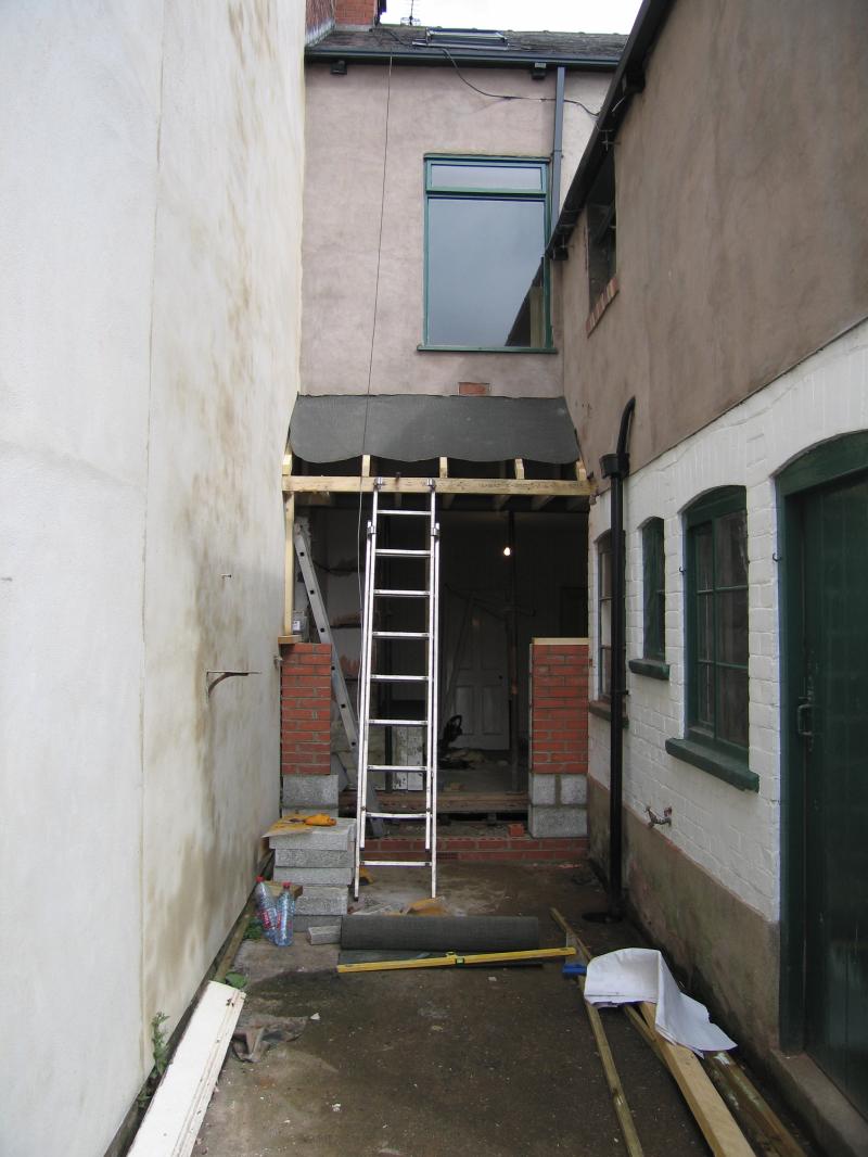

Hi guys,

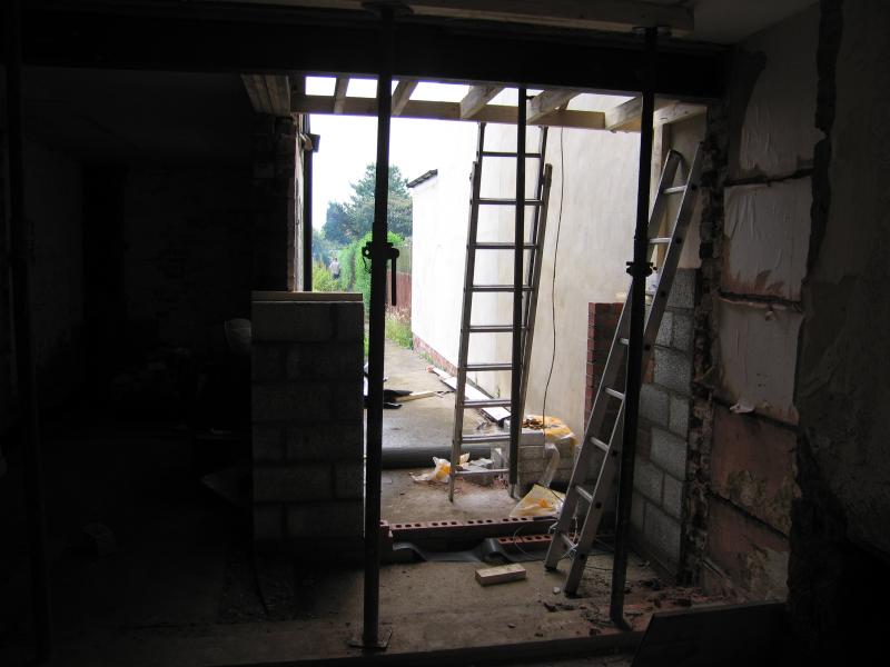

I have attached some photos i hope. The photos are ones i got from the builder he did the house prior to us buying it. From the garden photo you can see the extended section to the back of the house with the patio doors. The inside is all plastered and the steel also plastered etc. What i want to know is it possible for me to put a velux in this and remove the plaster inside and re plaster board it so you can see the pitch of the small extended roof. I want to do it because the room is reallly dark and the velux will offer a bit more light. I assume i would have to redo the wood joists etc but is this a job that can be done.

As I see it, you'll really only be illuminating the little extension and a liitle way into the room, inside the patio doors, due to the lintel over the patio doors blocking any light entering the room.
This lintel and the brickwork above it is really unmovable without a lot of expense.
But it's certainly doable. Don't forget you'll have to construct and pb the light well under the velux.
Seeing the roof construction, then it appears possible. However, as the roof is only 4 courses, then you are unlikely to get much choice in the size of window you could install. Being so small, it will not give that much extra light, as stated, especially given the size of next doors extension.
Thanks for the reply, I assume on the photo's you can see the the wood timbers which run horizontal from the front timber into the steel joist at the back. Can they be removed and just have the angled timbers going up into the brick work as the structure allowing from the inside just having a pitched angle plaster boarded.
The room is very dark and just thought even a bit of light is better than nothing and is it a difficult job for a builder.
I assume a builder could make the roof to take the velux and then strengthen so that i do not need the horizontal timbers in the photo.

I don't think you could remove all ceiling joists as they appear to be supporting the front of the roof - might be wrong though!
