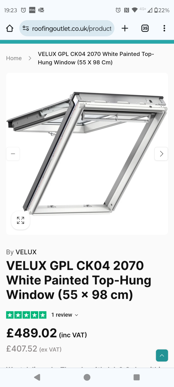

Regardless of this, given that you've cut two rafters I would try to add a additional 3x2 at either side - as the velux isn't quite at mid span it should be ok - or send velux a sketch - they might check it for you (but they might also try to sell you a shorter window!).
