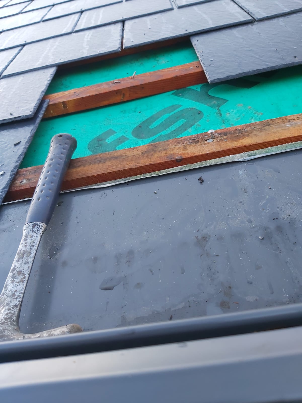

Velux Window wet patches
Can composite tiles cause excess condensation?

cement fibre slate, not my favourite product but they are usually reliable. Batten looks pretty wet . are there pictures showing ridge detailing?

That aside,the moisture appears above the underlay then finds its way around the velux by incomplete underlay fitting.
But as the underlay is not the source of weather proofing . We need more info, finished ridge detailing pictures and the measurement of exposed slate bottom of one slate to the bottom of the next .

There should not be that amount of moisture getting to the battens. On to the underlay
Exact pitch will be required , it's not 45. But looks ok

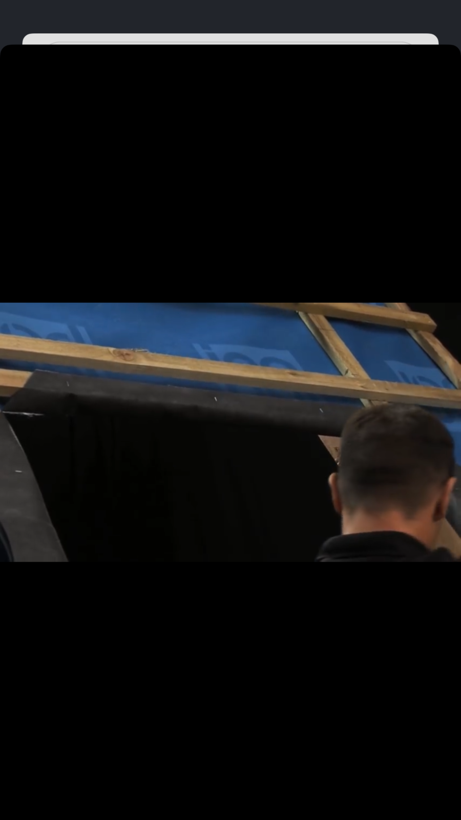

I think also after researching and seeing how velux’s are fitted that it’s the insufficient fitting of the underlay as it should wrap around the bottom batten and mine doesn’t. 5635DC87-CDD9-41FC-803C-4319944AE5B6.pngThis is the correct way
2F5C8F45-A78B-448E-AF18-4BF3CA792F6C.jpeg This is mine and it doesn’t look like the breather membrane has been lapped over the batten.

Yes I can see the underlay isn't dressed correctly.
But the point here is the underlay is not the main source of weathering.
You need to nail the source of moisture not just rely on the underlay which won't last that long , even a decent one like yours.

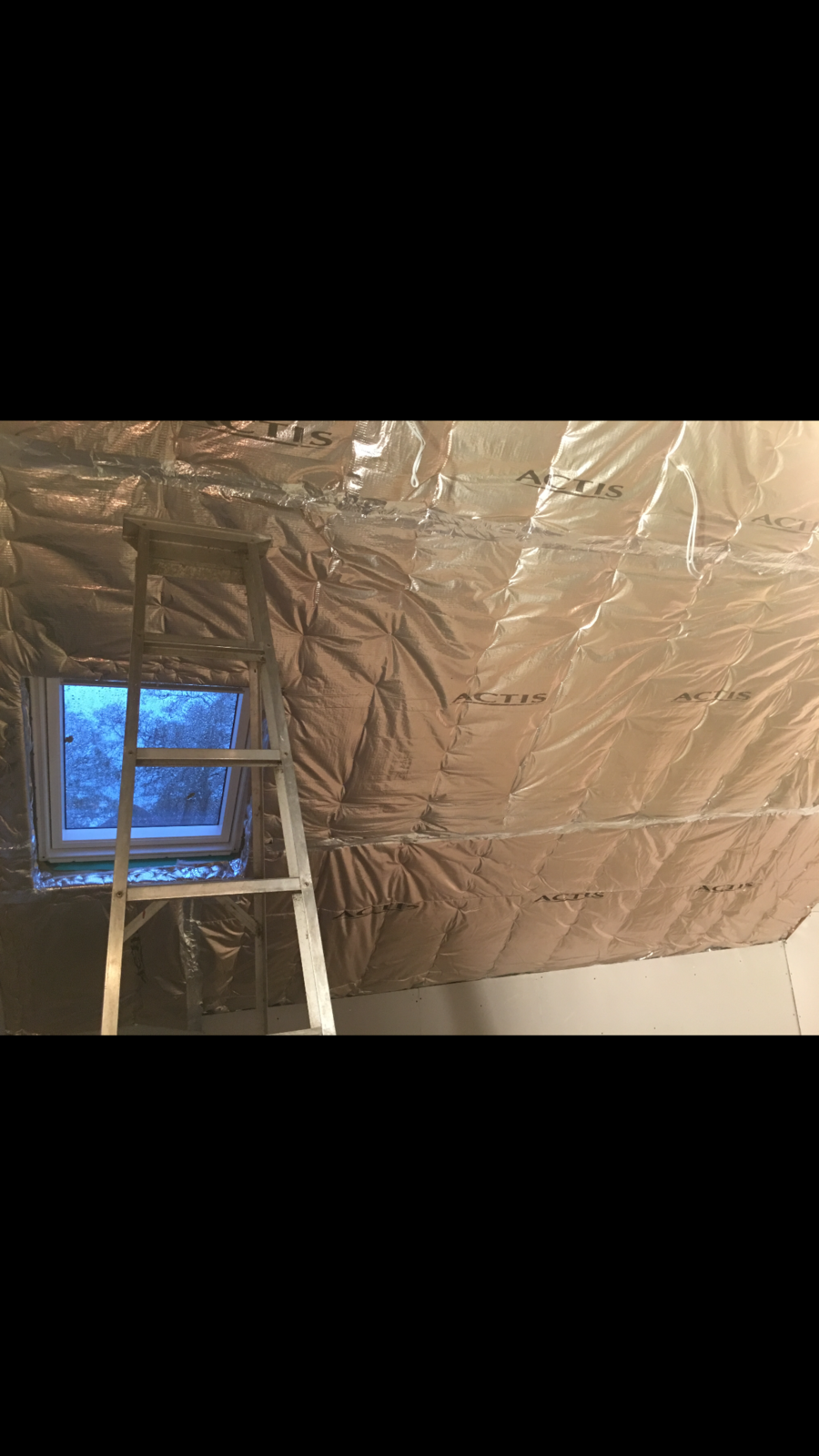

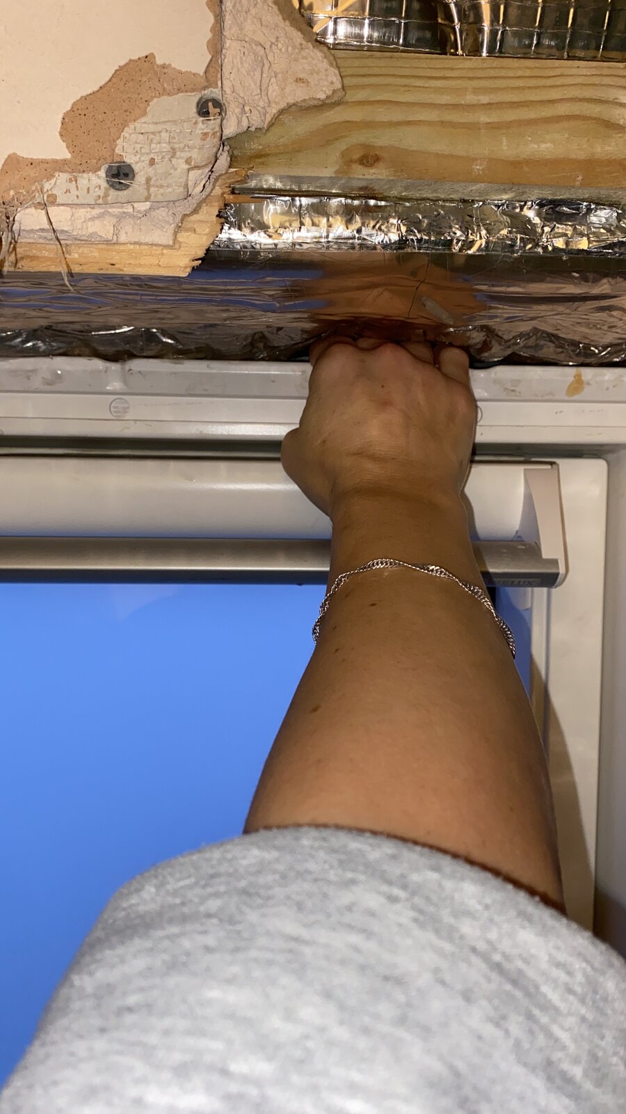

I’m back on this forum as my nightmare damp patches are back, nothing at all in the summer (warmer/mild) weather or when it rains but now it’s getting colder I have my nightmare back. The damp patches only occur when the weather turns cold, I’ve had a BFX collar and transverse drain fitted to just 1 velux to see if it makes a difference and I’ve still got the same problem. We have stripped away the plaster around 1 velux window insulated around it and if I push my hand up around the head of the velux the water is piddling down my arm. I’m at a total loss as to why this is happening, I’ve had the velux technical out/ my roofers out and a surveyor out all at the same time, and the conclusion they came to was that I have a cold bridge. The BFX collar and transverse drain should have stopped this surely as that is what the velux technician recommended.
Has anyone else had this problem at all and managed to rectify it? The insulation we used for our roof was Actis Hybrid and a vapour barrier blanket stapled over the top if that’s any help , all Actis.

We had a reputable roofing company supply the roof materials along with the velux’s, we didn’t have a project manager as such we purely relied on each trades professionalism and expertise for each part of the job. We did our own insulation with guidance from Actis themselves, they also came out to check all the insulation was installed correctly, also this is only happening on one side of our house the other side is absolutely fine, which leads us to think that it not the insulation causing the problem. I’ve uploaded a photo of me sticking my hand in the area where we have ingress of water/ condensation also I can feel a metal rim around the edge of the velux surround where it sits inside the rafters, the metal is drenched.
