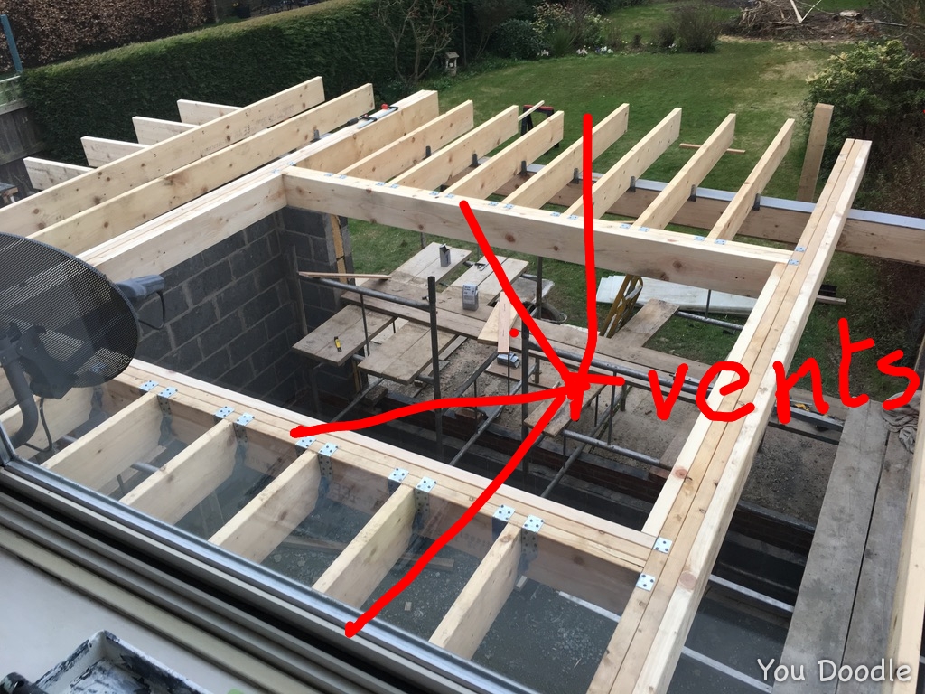

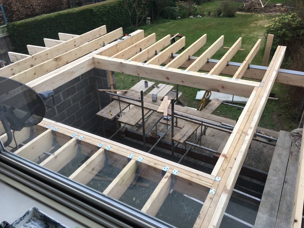

I'm in the process of building a 5m x 4m extenstion with cold deck flat roof and 3m x 2m roof lantern. It's occured to me today that many of the roof timbers between the roof lantern and the adjoining wall of the house will not be ventillated and the other timbers will only be ventillated from one end. There will be continuous soffit vents on all three sides so I need to find a way of creating a path through the blocked timbers.
The only options I can think of are:-
1) Notch the joist (200mm joist so only 30mm notches allowable)
2) Gaps between the firrings (supporting 18mm ply felt roof). I'll be using firrings from 18mm at the outer edges to 67mm in the centre.
Does anyone have any thoughts?

Thanks! That is what I was looking for, I just didn't know it existed! Cheers :-) It solves most of the problems, but I still need some sort of cross ventillation between the joists around the roof lantern to allow air flow through.
You have a flat roof abutting a wall on one side presumably, so your joists should be running in one direction, so you have vents either on each side or at the abutment and the other end, depending on whether your joists run side to side or front to back, no need for three sides of venting as mentioned. So on two opposite sides of the rooflight abutments you have additional vents, I don't see the problem.

I haven't yet. I planned to have soffit vents on all three sides to allow ventillation to the eaves overhang dead spots (plus now the abutment vent). Is that not necessary?

The problem is air flow. You don't get proper ventillation with just one side of the rooflight abutments vented.
This pretty much shows what I was thinking, but I don't fancy notching the joists - I'd rather have gaps in the firrings.
Yes, you will have to see if a suitable vent can be sourced that lends itself to being fitted on the upstand of the rooflight, or abutment if you like, there are a few abutment vents available, the devils in the detail!
