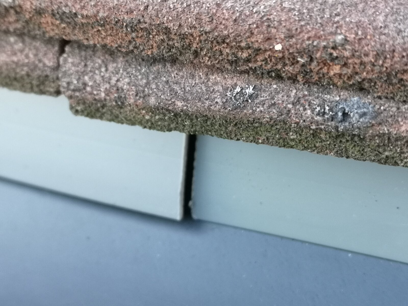

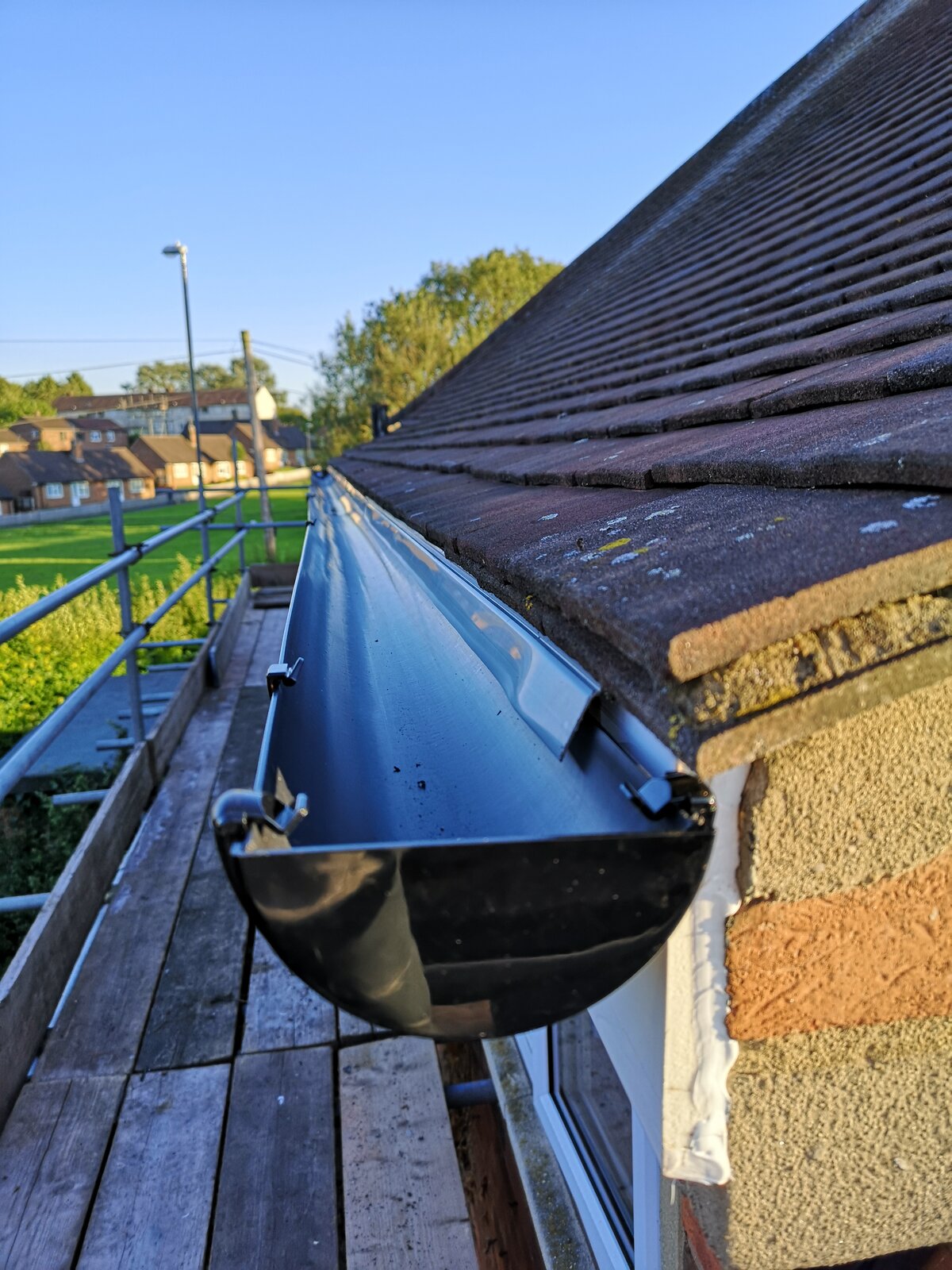

Installers of what is there (only just finished) have left me with a real mixed bag and for the most part it doesn't seem great.
As for the "as long as there was a waterproof felt edge" well, hopefully the attached images will work and show that they have left these felt support trays which I guess hope to help the water run into the gutter and make up for the lack of any tile overhang across the first part of the gutter in most areas, but it seems that only on one side of the roof the felt is on top of these trays (as I believe it should be) sometimes the felt is below them (?!) and sometimes in shoving the tray in (none of the trays are attached to anything, just shoved in) they seem to have shoved back and wrinkled up what remained of the existing felt so it dips and rises wrinkled back behind the tray to give water somewhere to pool(?!!). Also as the trays finish about where the tiles do due to the lack of overhang there seems to be water wicking up between tray and tile (after a shower, push the tray down a little to break the gap and water pours out) and as the second image should show there's little on no overlap of the trays so water doesn't have to work hard to find a route to bypass the run to the gutter. Starting to feel the lack of ventilation with this fitting is the least of my problems...
