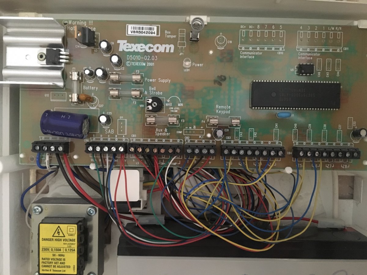

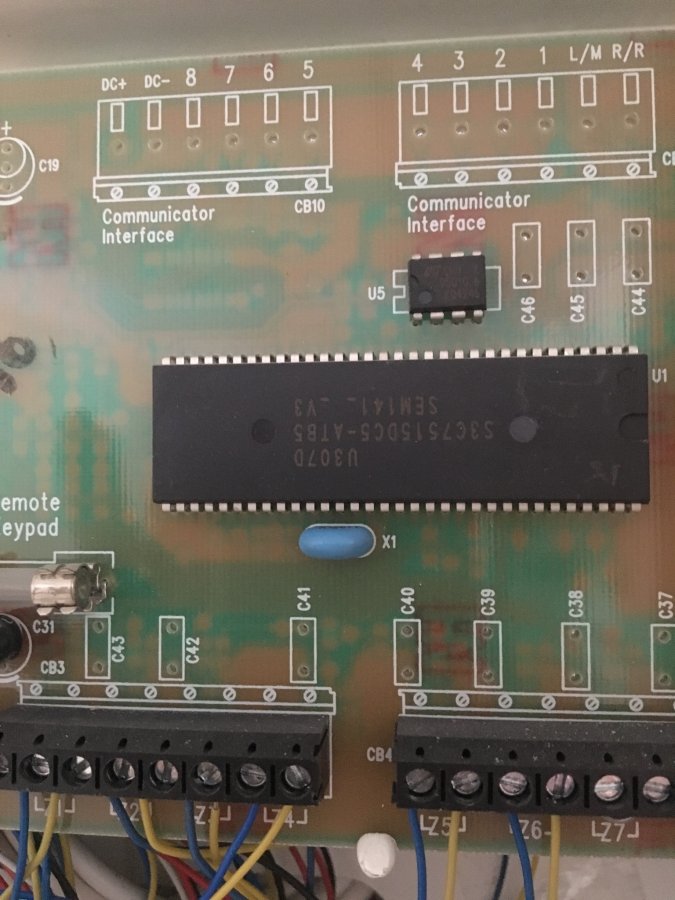

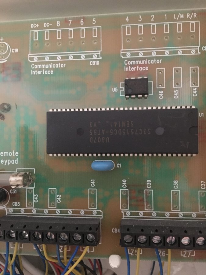

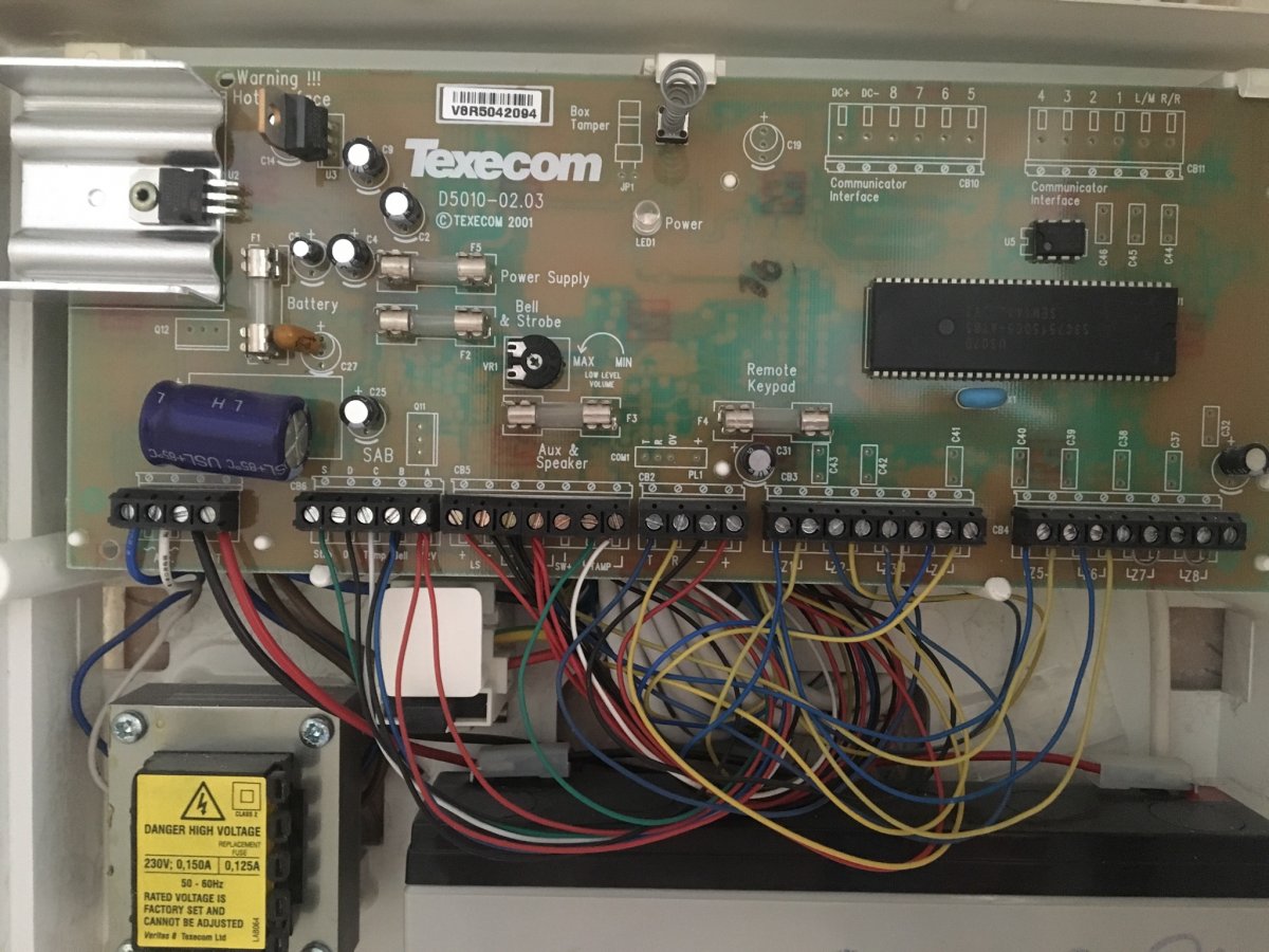

Thank you so much for your help. I have opened the panel box but not really sure what to do.
I took two photos which I have attached. Maybe you can see from the photos which is the wire I need to link out
Thanks again, much appreciated

You have a device on zone 5.
To link out zone 5 you need to put a link across z5
Zones 7 and 8 are linked out ,so all you need to do is put a link like z7 or z8
Then that should let you set the arm.
You could then spend time on finding out what is on zone 5.
If you follow the zone 5 wire back does the red and black go to the aux volts,if so you have a movement detector to find.
If not it could be a door contact or panic button that could be pressed in ?
