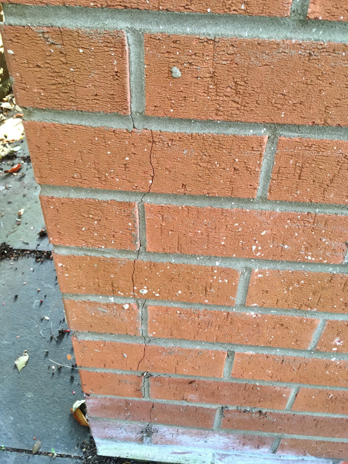

Hi All,
Some advice will be appreciated on these cracks I've spotted on a house we are intending to buy.

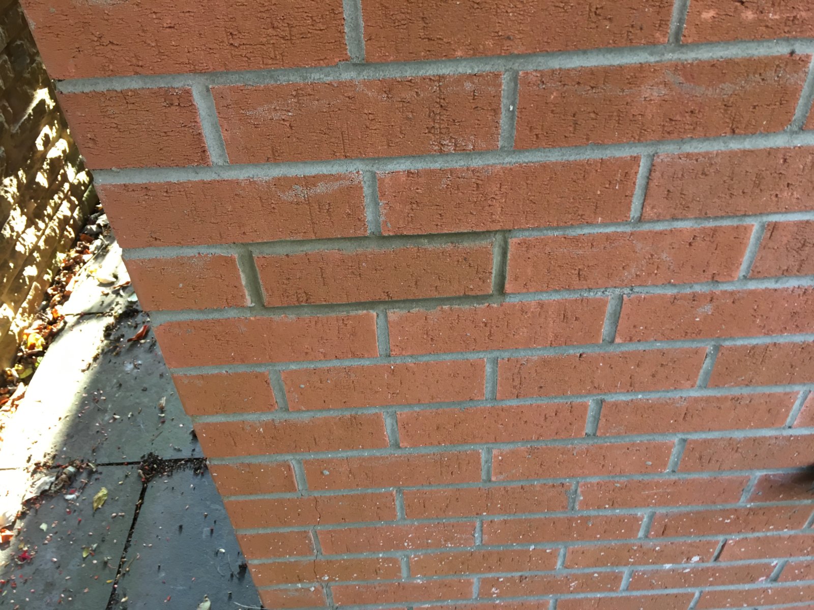

The house is built into a slope, these cracks appear at two corners of an extension built in 2000.
I'm a bit concerned something serious is going on and would appreciate second opinions before getting a structural survey and pointing them to the problem. When I was taking the photos I didn't spot the difference in colour shade of the brick either side of the crack.
The crack which shows the white brickwork below does have a reasonable crack on the inside but about 1ft away from this crack. As far as I can remember the crack doesn't go through to the damp proof layer and neither crack is higher than 6ft. It just stops.

second last photo looks like someone's had a brick out higher up. but cracks opening at ground level then petering out are due to movement starting at ground level. could be as simple as shrinkage due to heating up and cooling, this can happen on a longish wall.

there seems to be a surprising amount of white salt deposits or lime at the bottom of that wall. I wonder if there is a water leak that's softened or washed away the ground under the wall footing.

they are small cracks, only a few mm's typical of thermal movement cracks so not usuly significant.
however, the cracks both come near outside corners, and they are more or less mirrored inside the extn.
the extn is also on a slope.
in the second pic the mortar bed seems to have lifted indicating that perhaps the brickwork below that bed has dropped a little.

From images posted, looks like Thermal, end of a very hot summer Etc. does the wall on the left hand of the image [the one unseen in the images] face South or is it exposed to prolonged sunlight?
How long is the [unseen] wall ? is it about 4.m?
What could have occurred is that the unseen wall has been heated by the sun and expanded? depending on the brick, some brick will expand at a much higher rate than others.
OK the wall has cracked. but? they have both ends cracked in the same place, very close to the corner, and vertical, if you consider it, the [unseen] wall appears to be pushing the side walls, causing vertical crack to form in line with the expansion occurring on the wall being heated by the sun?
If you look at the width of the vertical crack, it is [reasonably] uniform in width top to bottom? the dimension from the corner to the crack is near enough the same width as the bricks on the unseen wall, again pointing to thermal expansion?
If it were to be Subsidence of the corner? then, there will have formed a diagonal crack, not vertical, and the crack will be much wider at the top of the crack diminishing near the base of the wall. Any such diagonal crack tends to be about two to three meters in length [measured along the crack] and such diagonal cracks are generally at [roughly] about 45 degrees.

The first two pics are on a west facing wall so the other side is south facing. The length of that wall is about 12m but it has an expansion joint approx 8m along. The face you can’t see is about 1m before a bay window (you can see this in background).
The other wall (white at bottom, replaced brick) is north facing and shaded. This wall is about 4m but has big windows along it, approx 50cm up. So the crack goes up the pillar which is approx 40cm wide.
I suspect that corner has sat in water and the patio doesn’t drain away properly (lots of white bricks and some faces off from frost cracking).
Assuming it is thermal cracking, what can be done to rectify it and stop it getting worse?
It's cause by expansion of the brickwork. This can result from 2 causes; 1. thermal expansion of a long stretch of brickwork, particularly south-facing, or 2. initial expansion of the bricks soon after construction (bricks are bone dry when they come out of the kiln and if they are built in soon after manufacture, they gradually take up atmoshpheric water which causes them to expand slightly).
Whichever the cause, something has to give, and you frequently see the vertical crack at the corner, particularly where there's a short return as you have. It's almost a text-book case of the symptom, and that fact that it doesn't extend below the dpc bears this out.

No worries though, Tony has nailed it. That is a text book example of thermal expansion cracking. Provided there is a reasonably long run of brickwork to that wall.
