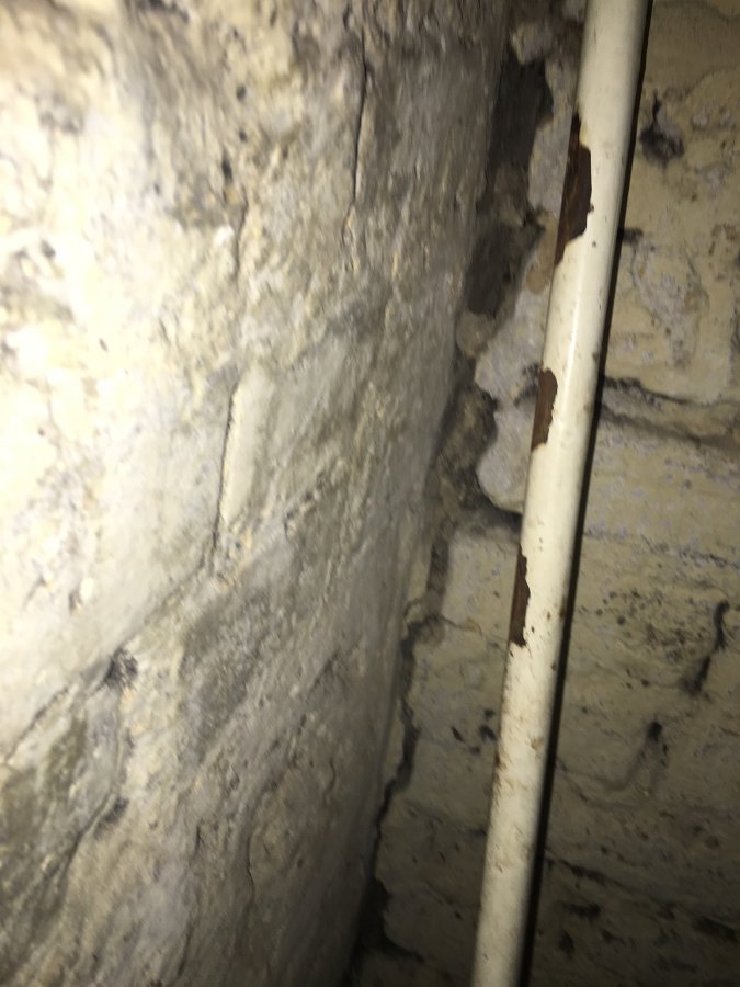

Hi Everyone

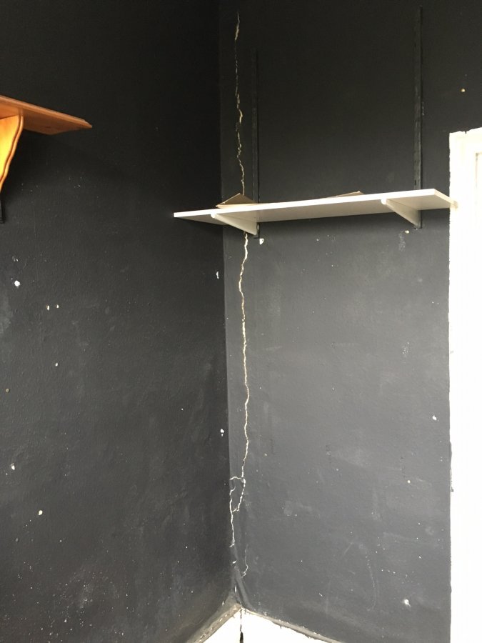

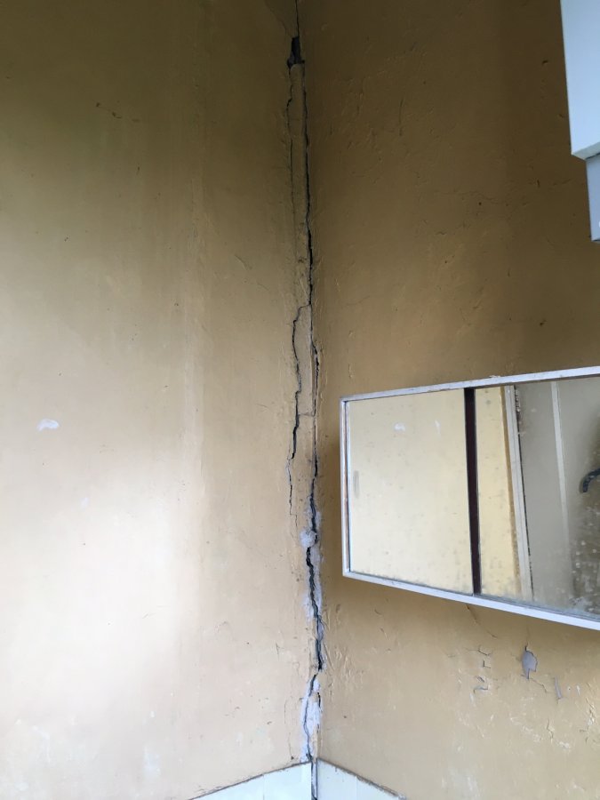

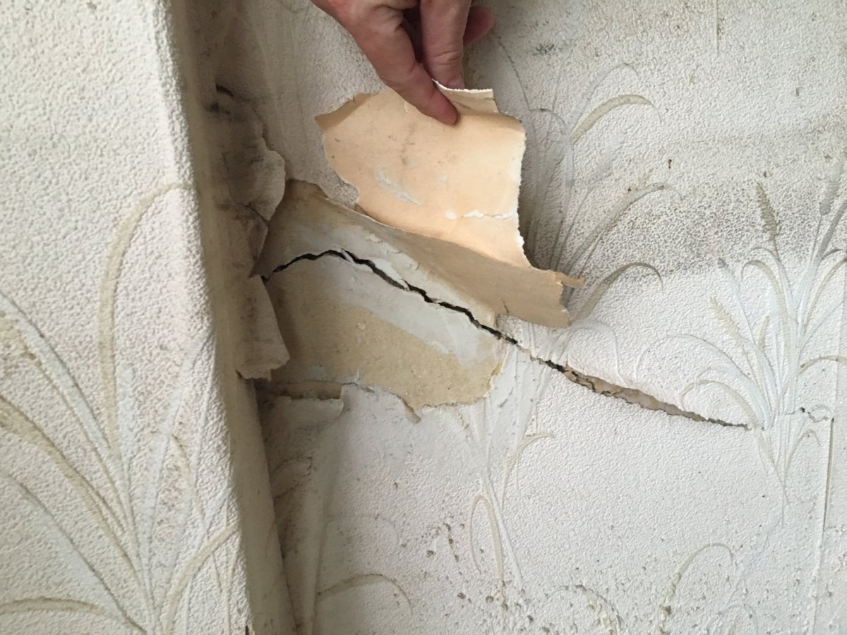

Considering buying a period property which has a number of large cracks running from floor level to the ceiling along the corners that join the external end of terrace wall.
The cracks have appeared or at least worsened since the house was decorated I'd guess in the 70's.
The cracks are up to 15mm in places and appear along the bare brick in the under stairs cupboard, in the bathroom, at the top of the stairs and in the box room - all of which adjoin the external wall.
The stairs which run along the exterior wall also seem to have separated slightly from the wall.

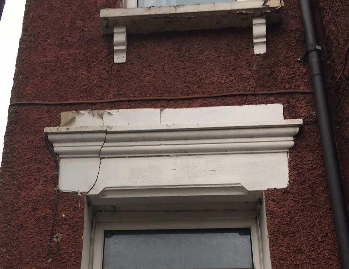

The stone lintel above the front door (also on the side of the end of terrace wall) also has a crack running through it and is clearly broken through.
Has anyone experienced or seen this before? It doesn't look to be typical subsidence as there are no visible cracks on the exterior of the wall and it definitely hasn't been patched (the house has been empty for quite some time).
The picture of the bare brick is from under the stairs and seems to show that there has been a separation between the exterior and internal walls.
The other end of terrace houses on the street don't seem to have had their walls tied and are all of a very similar age/style.
Thanks in advance for any thoughts.

Once you start getting broken lintels, you definitely know you've got movement of some sort. If it's in London, and built on clay, then it could just be general movement, but just because you can't see any cracks on the outside, doen't mean that you don't have a problem there. Is the pebbledash on the outside the same as the other properties, can you spot any differences. The outside wall could be coming away, and they've patched the outside, but not got round to doing the inside.
The side wall can be underpinned, but you might need to tie the side wall in to the front and back walls with helical ties, and I'm not sure if this can be done from the inside only, as you'd ruin the pebbledash if you did it from the outside.
You need a structural surveyor, and then the cheek to put in a hell of a reduced price.
