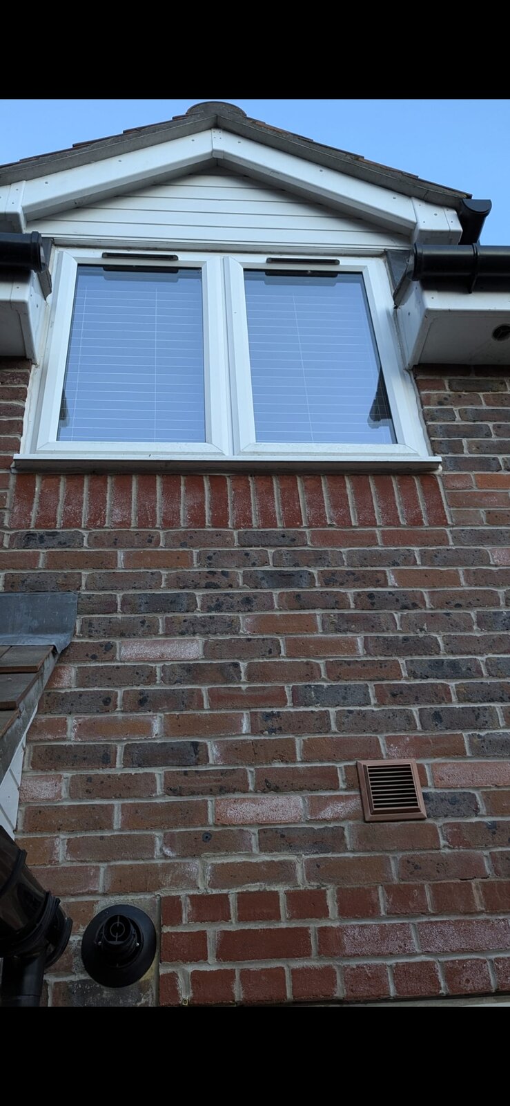

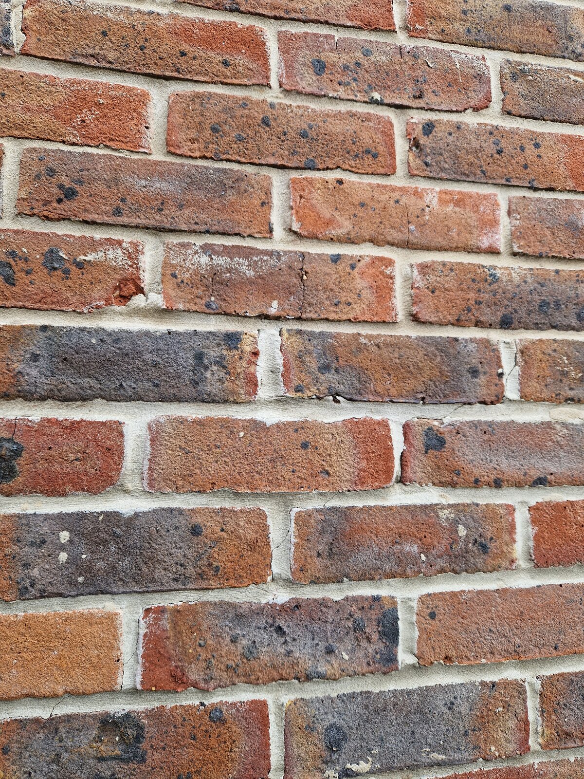

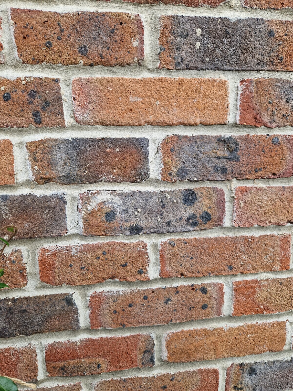

EDIT - I've also noticed a wider crack on the exterior of the downstairs window and a hairline stair step crack on the ground floor exterior. Images attached.

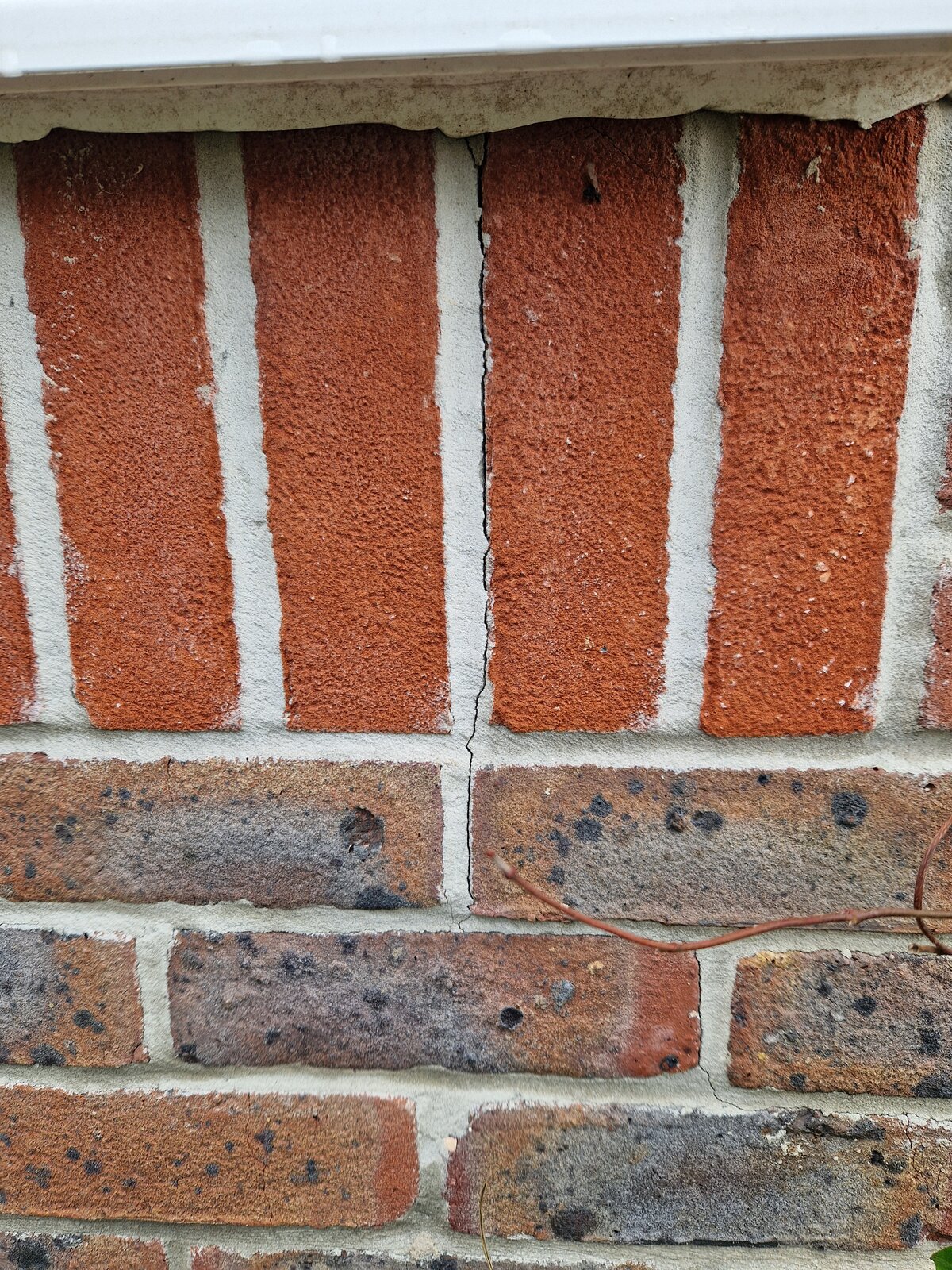

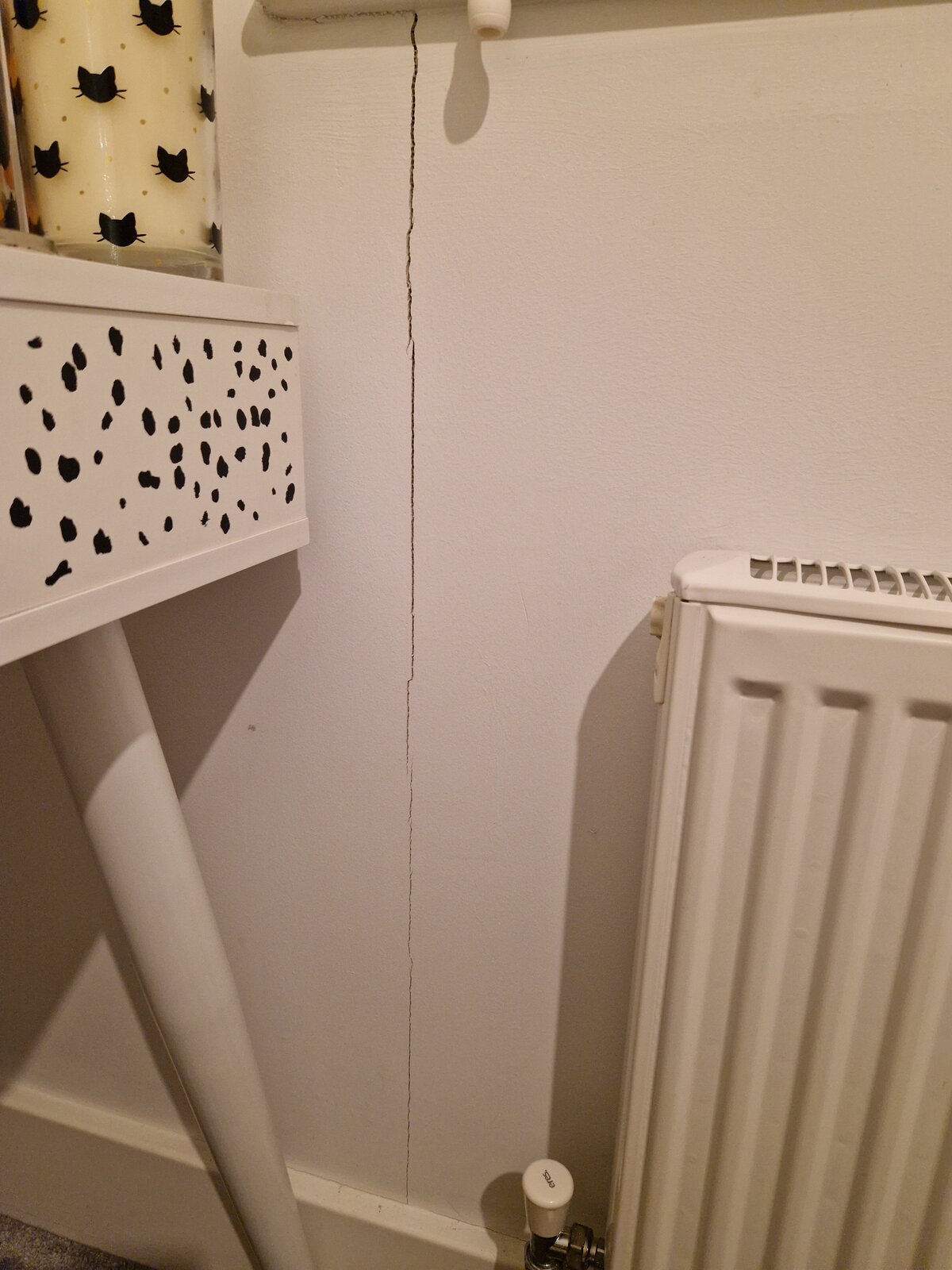

I've already booked a structural engineer to take a look, but I'm curious about your thoughts in the meantime as they can't come for a few weeks. I have a crack in my front bedroom underneath the window. The top part is about 2mm and has been there for a few years. However, since at least April '24, it's migrated downwards.

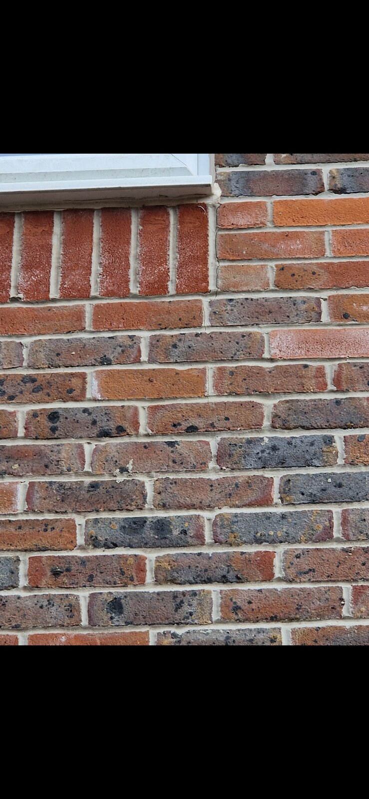

I've only recently noticed the crack on the outside, which looks like it's in the same position under the window on the right-hand side (directly below the outer part of the window). It's only a hairline crack, but both together worry me.
Little bit of context - the house is a 6.5 year old mid-terrace newbuild built on clay soil. My neighbour on the end has just had remedial works completed for subsidence (caused by neighbouring bushes which have been cut back. She's also had a trench dug out next to her house and filled with copper sheeting and gravel). I had someone out at the start of last year who said I didn't have subsidence, but the cracks have since got worse. Is it possible that her subsidence is having an effect on my home?

externally: it is correct that diagonal stepped cracking can indicate subsidence or heave as clay can do both, if you think about say one corner of the house foundation dropping you can imagine how that would crack the walls diagonally.
however its so insignificant there its probably impossible to distinguish it from thermal shrinkage or settlement.

You need to identify which photos are which! That first photo, might that be the front bedroom you mention above? Is that wall plasterboard/if you tap it does it sound hollow? If so, that is just poor quality plaster boarding. Fill it, paint it, and forget about it.
The cracks outside, are just tiny cracks, natural settlement, nothing to worry about.

Image 1: Crack inside the front bedroom (plasterboard)
Image 2: Crack on the other side of the wall (front bedroom) in what looks to be the same position as the crack inside
Image 3: A closer look at the crack (same as image 2)
Image 4: Crack in the exterior beneath the downstairs kitchen window
Image 5: Example of stair step cracking in the exterior of the house - to the right of the kitchen window
Image 6: Same as image 5

Hi NyBurger - I'm a structural engineer in Abergavenny - https://www.johncranna.co.uk/ - and looking at your photos I'm quite sure that it is not due to subsidence as they do not increase in size along their length, are not matched outside and inside (I don't think) and don't seem to form a path from ground to eaves. More likely to be a thermal movement problem.
