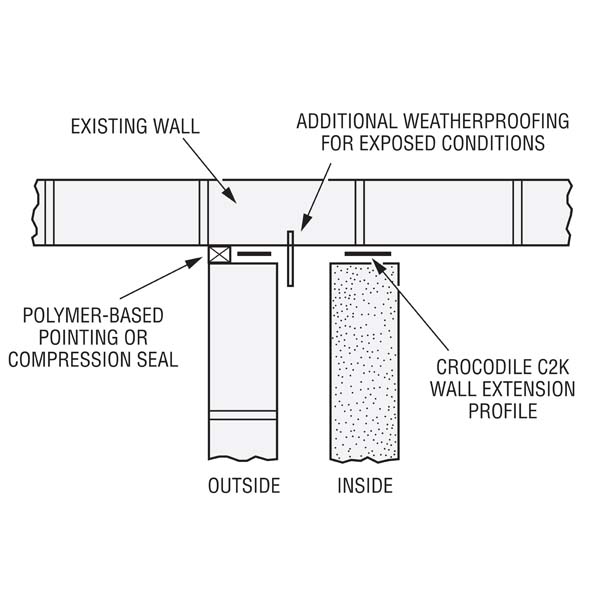

@^woody^ if I cut it 1 inch deep and place 4 inch dpm inside slot, add clear silicon to keep it in, then fold it inside new cavity would that suffice?

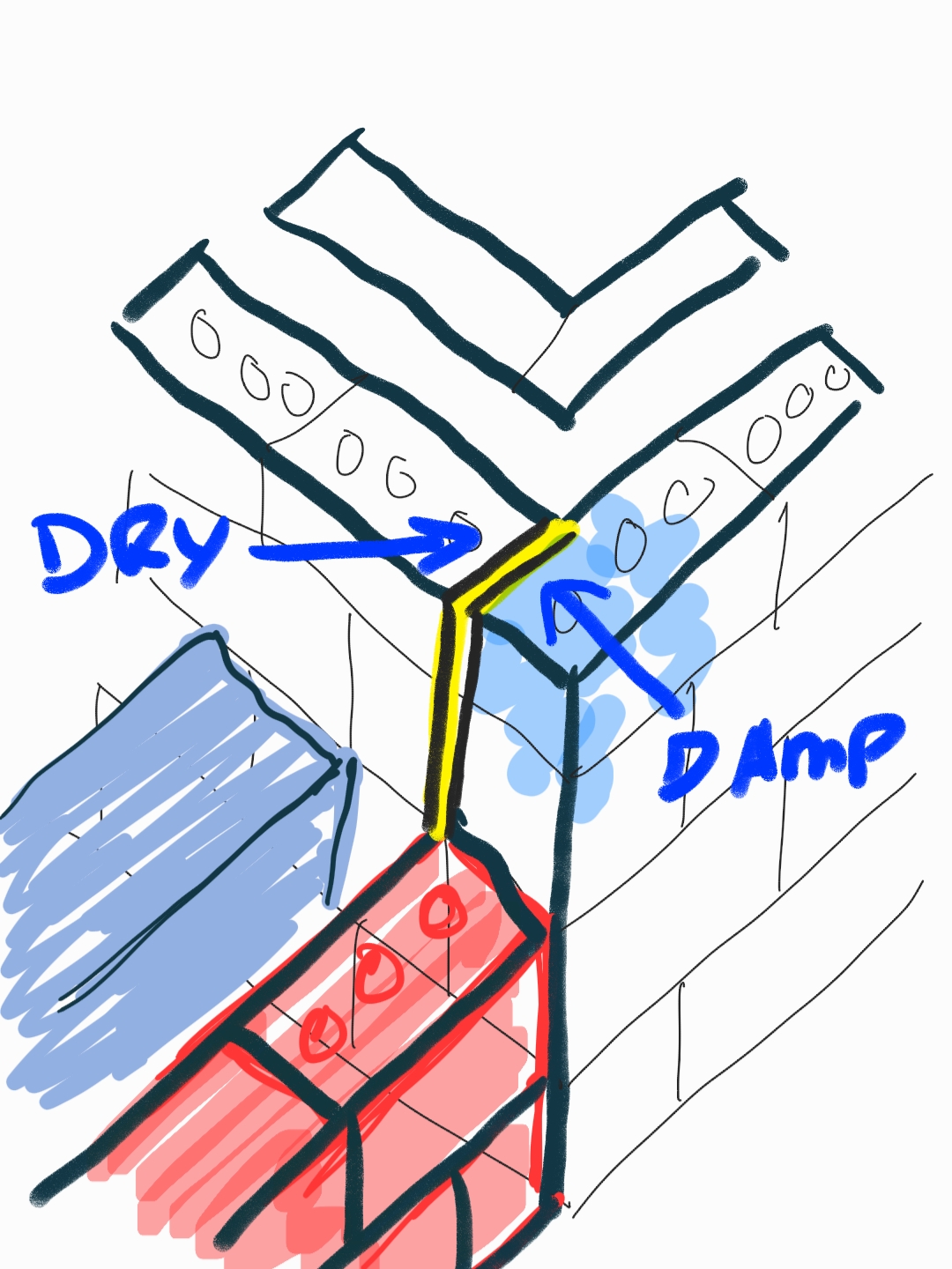

Like this

How about this @^woody^
Prefer not to cut 4 inches in wall. :)
Where is that drawing from? It's wrong as there is a direct path for moisture in to the new internal wall. Yes it may be less work but it's doing jack, you may as well not do it.
The alternative if you don't want to cut, is to just coat about 400mm of the external wall with a water repellent. But this is not the best thing if the part of the wall gets the weather, only good as an option for relatively sheltered walls

These days its pretty normal to cut out a 50mm slot so the cavity continues -that creates a thermal break as well as a vertical DPC.
cutting just a 1/3rd of the way in is an option, but in porous brick it may not stop horizontal movement of damp.
your other options include damp proofing the wall, fittings battens and foil backed plasterboard, using render base coat with SBR and then multifinish....bascially anything that avoids bonding plaster which is hygroscopic.
