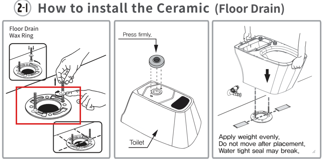

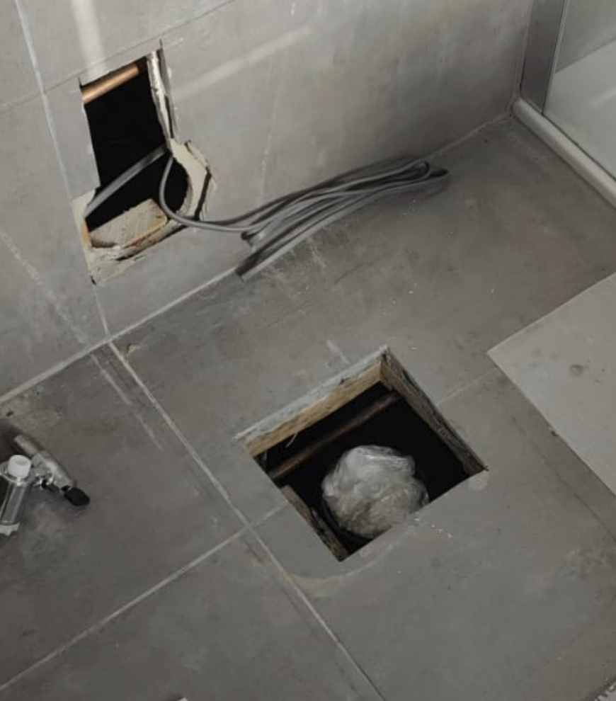

Have a toilet draining into a 4" soil pipe
It's a vovo TCB-090SA and it comes with a wax ring but it doesn't come with a toilet or closet flange (because these are often solvent-welded to the soil pipe). They assume one is already there.
Where can I pick up one of these pieces in red quickly in the UK? I see them on Amazon/eBay but from the USA mainly.
How do we normally connect these toilets to the soil pipe in the UK, if we don't use toilet/closet flanges?

The issue is they have ridiculous lead times of 2 weeks +
Right. Do the installation instructions mention WRAS?
No, they don't. But the installation can be made fully compliant with Water Regs through the addition of a type AB air gap. Similar care should obviously be taken to adhere to UK electrical building standards. This post isn't really about that though.
