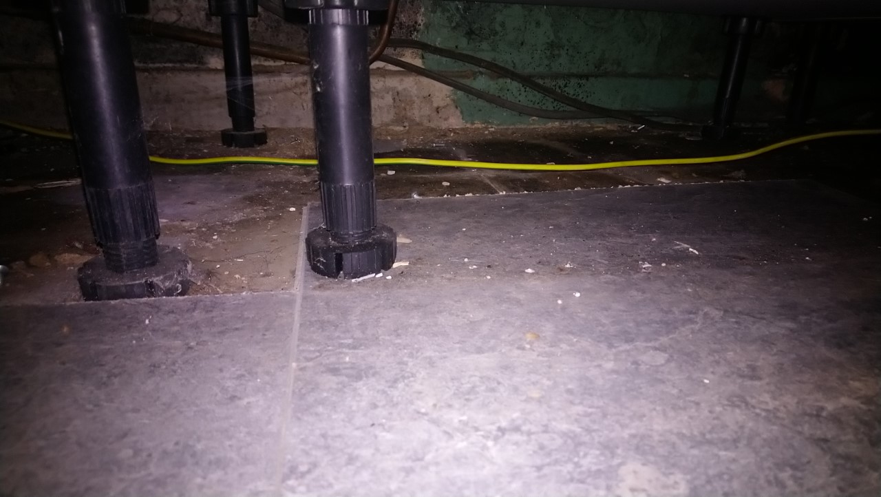

Hi Guys,
Please find pictures attached. (sorry my phone doesn't allow me to upload pictures on this site so I have so send them to my computer)

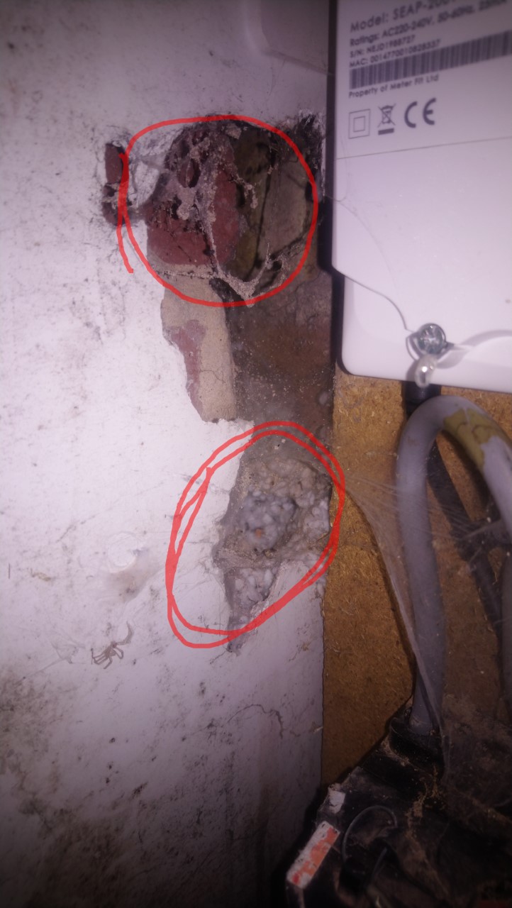

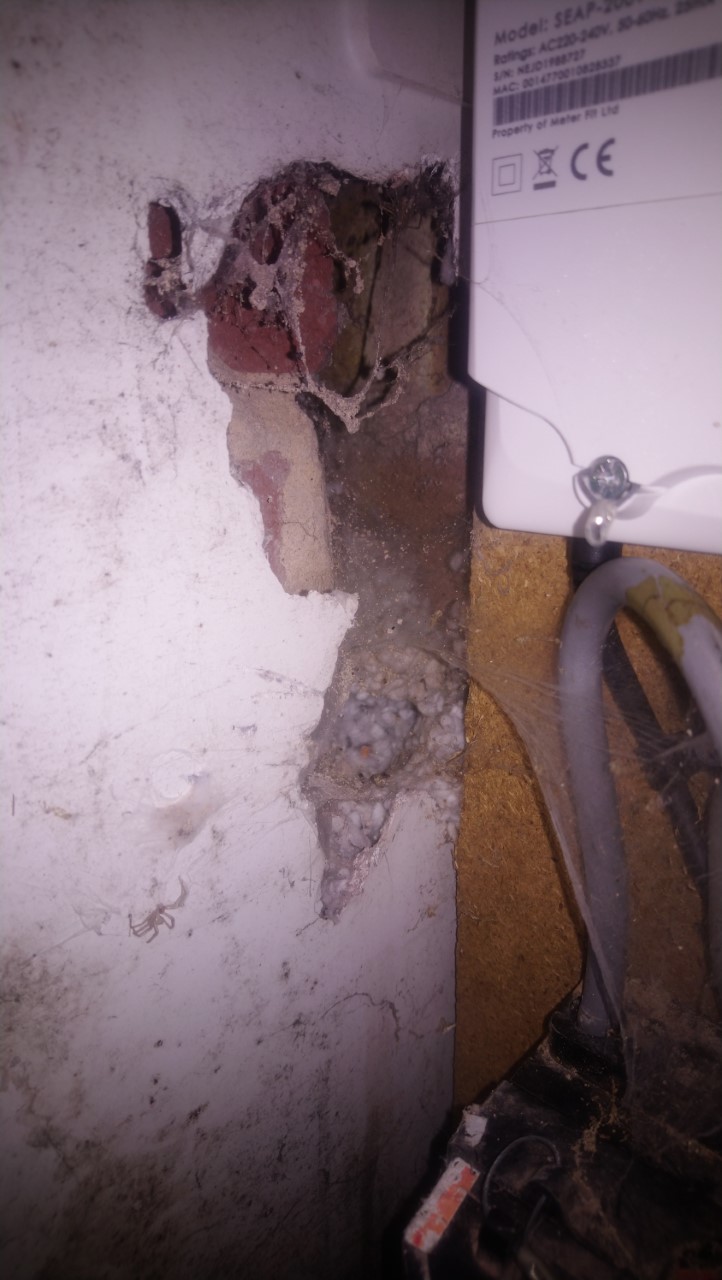

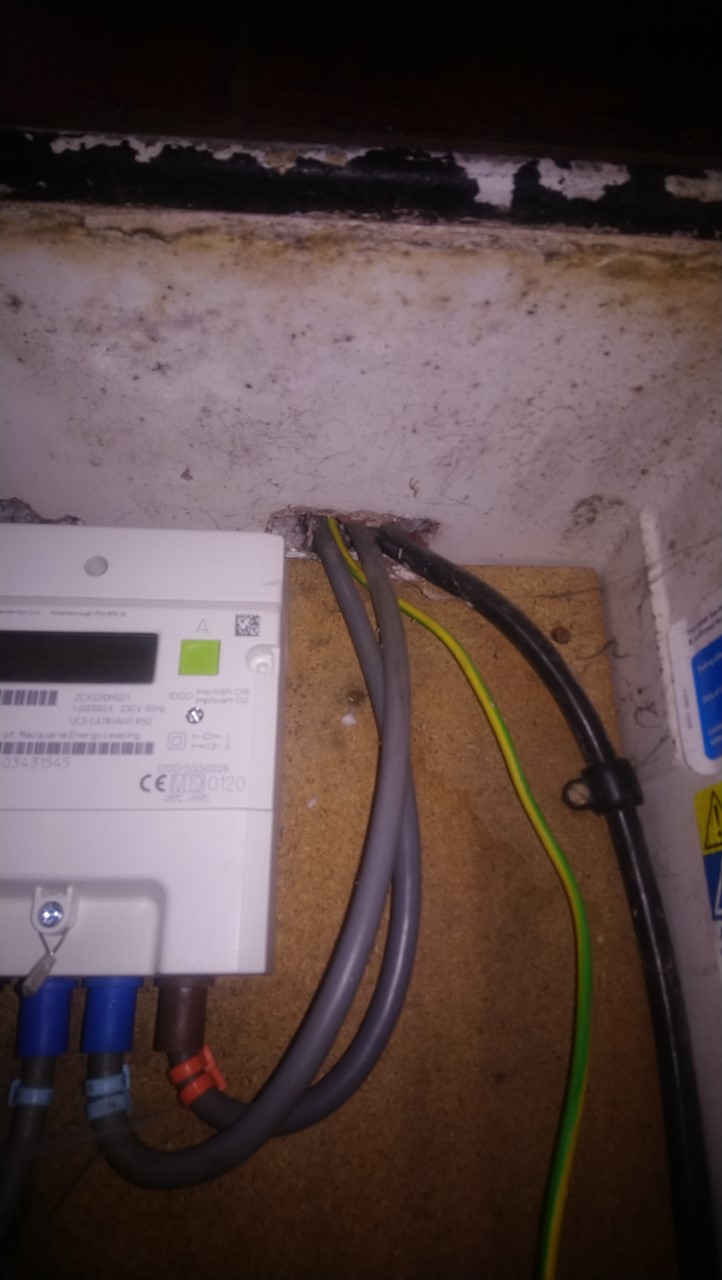

Please see the image with the red circles showing red brick in the top one and in the bottom red circle what appears to be the Instafibre White wool I presume. you can see where the installation of the electric and gas boxes recessed in or maybe more recently where meters have be changed and someone decided to smash things to bits and not fix it...
Could this be the issue and how can it be repaired please?

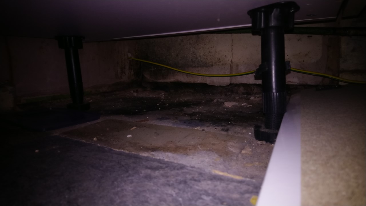

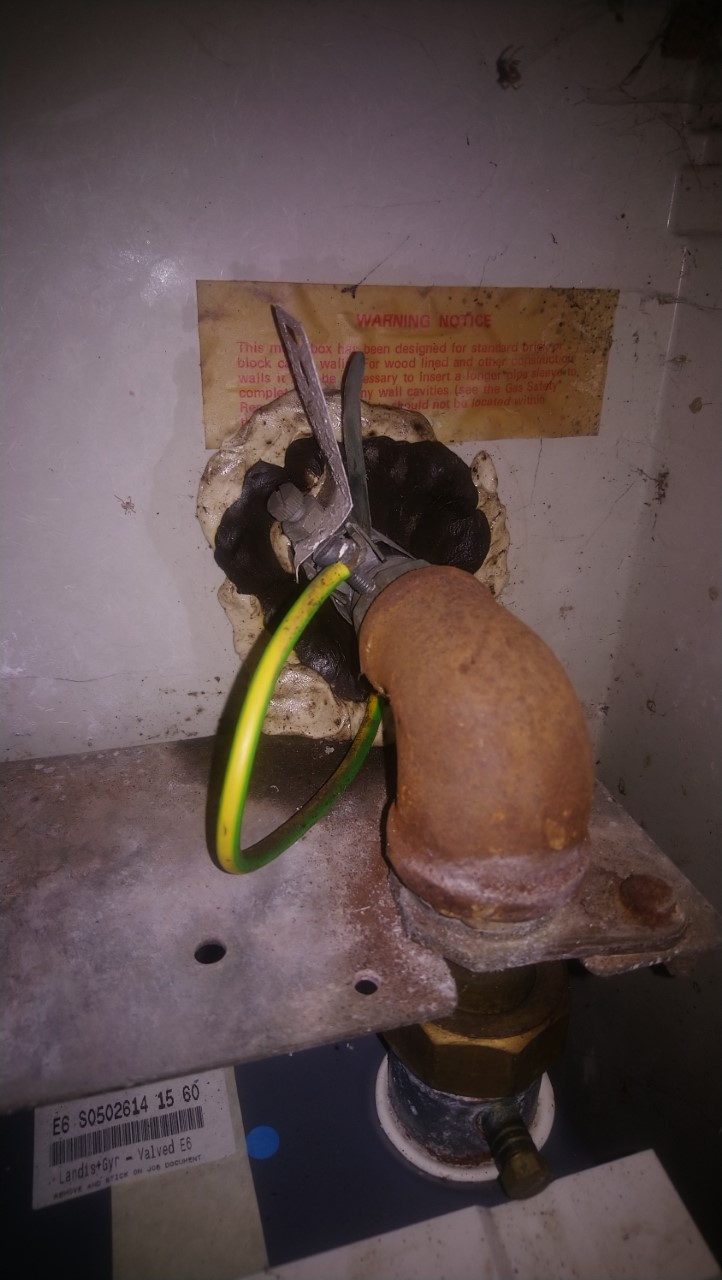

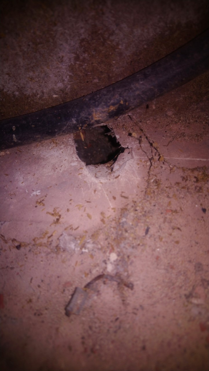

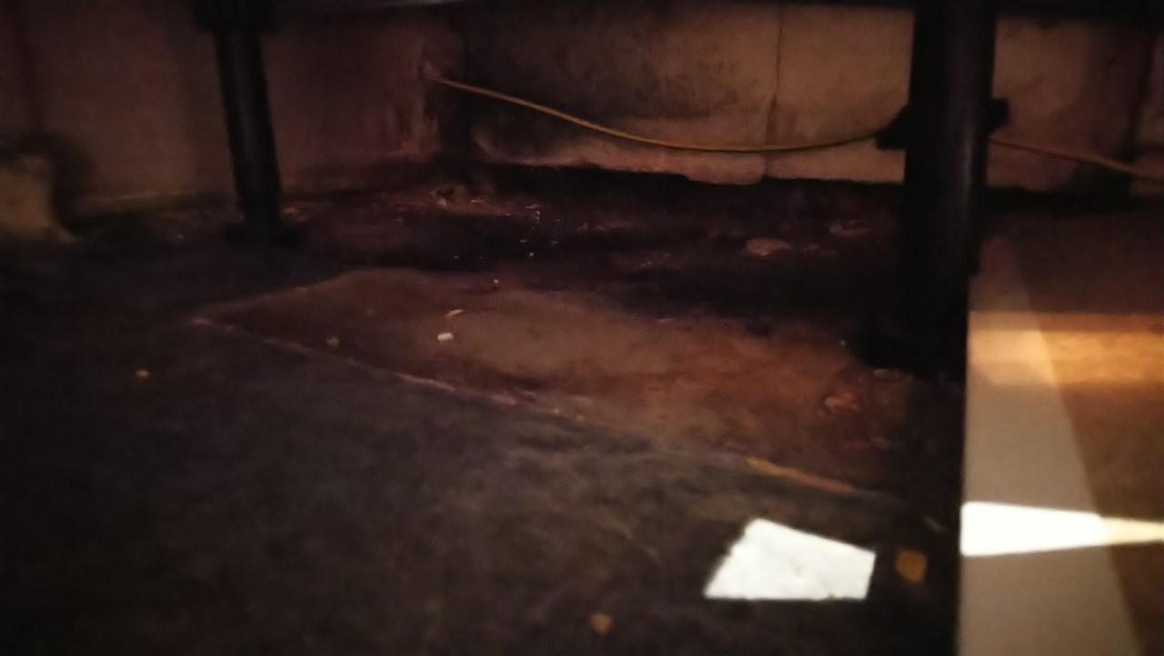

Please also see pictures of under the kitchen units .
I welcome you thoughts and comments and advice
regards
ian

those holes in the wall are presumably draughty
you can pack mineral wool (loft insulation) into the cavity and build up the hole with S&C mortar (several layers or it will slump). Verify the wall is not damp as loft insulation is not treated to repel damp.
the floor looks to me like it might be chipboard. Are you sure it is solid?
It's hard to determined where the drafts are coming from as the damage you see is on the exterior brick and inner leaf.... Its also presumably compromised as these pictures show the recessed exterior meter boxes.
You mentioned chipboard? ... The pictures show images of inside the exterior meter boxes and under the kitchen units...
Apart from the obvious by checking if it's wet, how can I source dampness that might be hidden else where?
Thanks.
It looks as though there’s not much, if any gap between plasterboard and floor on one picture, which won’t help with damp/moisture.
So it's not freezing cold... Room temperature would be nice.
