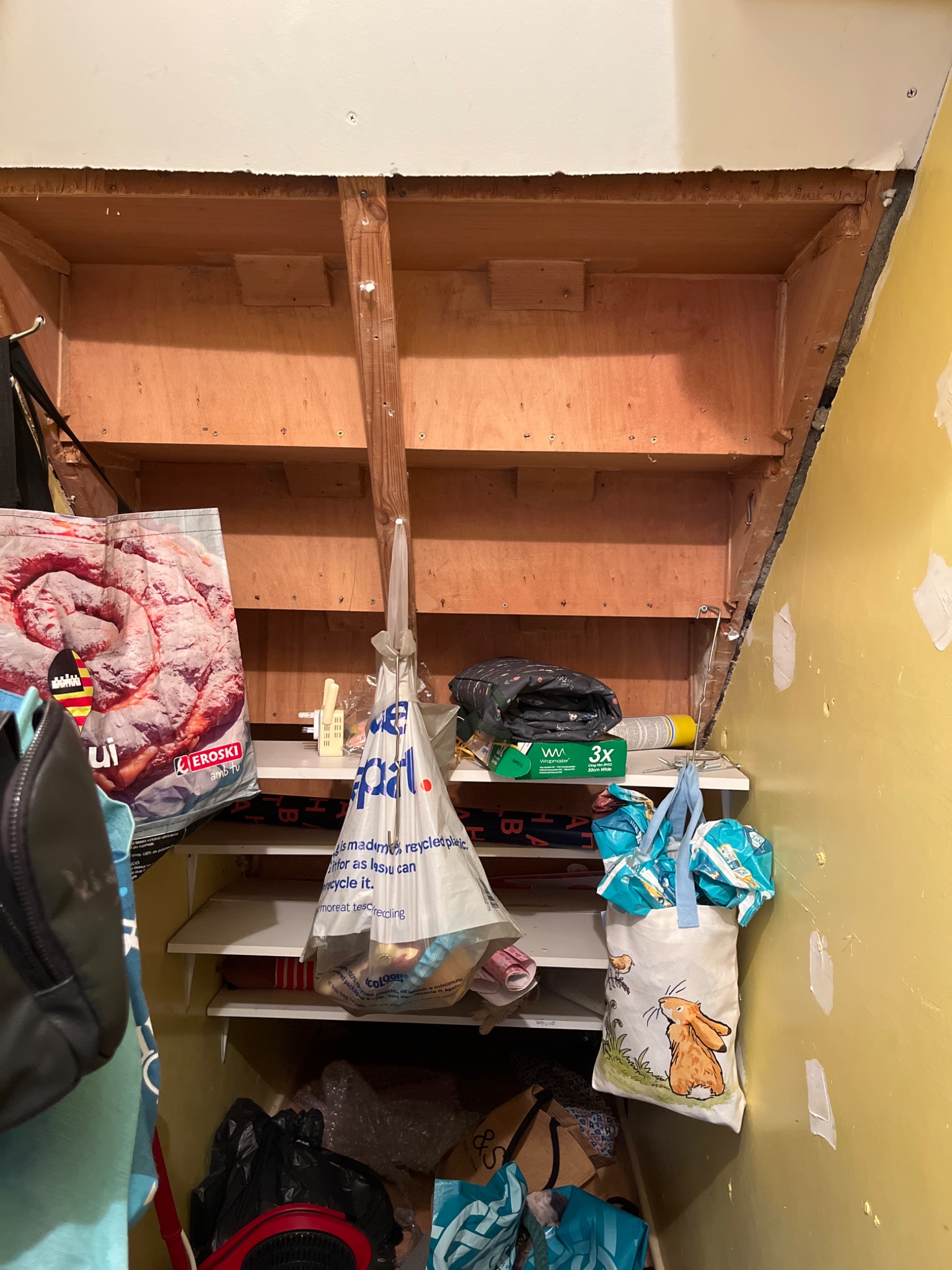

I am wondering if there is anything I can to to fix my creaky staircase. Every single step makes a huge creak. I have access to under the stairs as seen below (please ignore the mess)

It involves hammering in the wedges further and / or fitting more blocks where the tread meets the riser.
