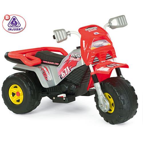

i bought my son a 6v electric ride-on car (similar to the pic below). It was second-hand off ebay and he loves it. However, it is soooooo noisey. Im sure its noisier than is usual for these toys. The women selling even said she was getting rid of it becuase it was too noisey for her daughter.
Is there anything I can do to decrease the noise? It seems to eminate from the wheel that does the powering. It was only a fiver so im not too bothered but i think we are going to be public enemy number 1 this summer if it stays so noisey!
