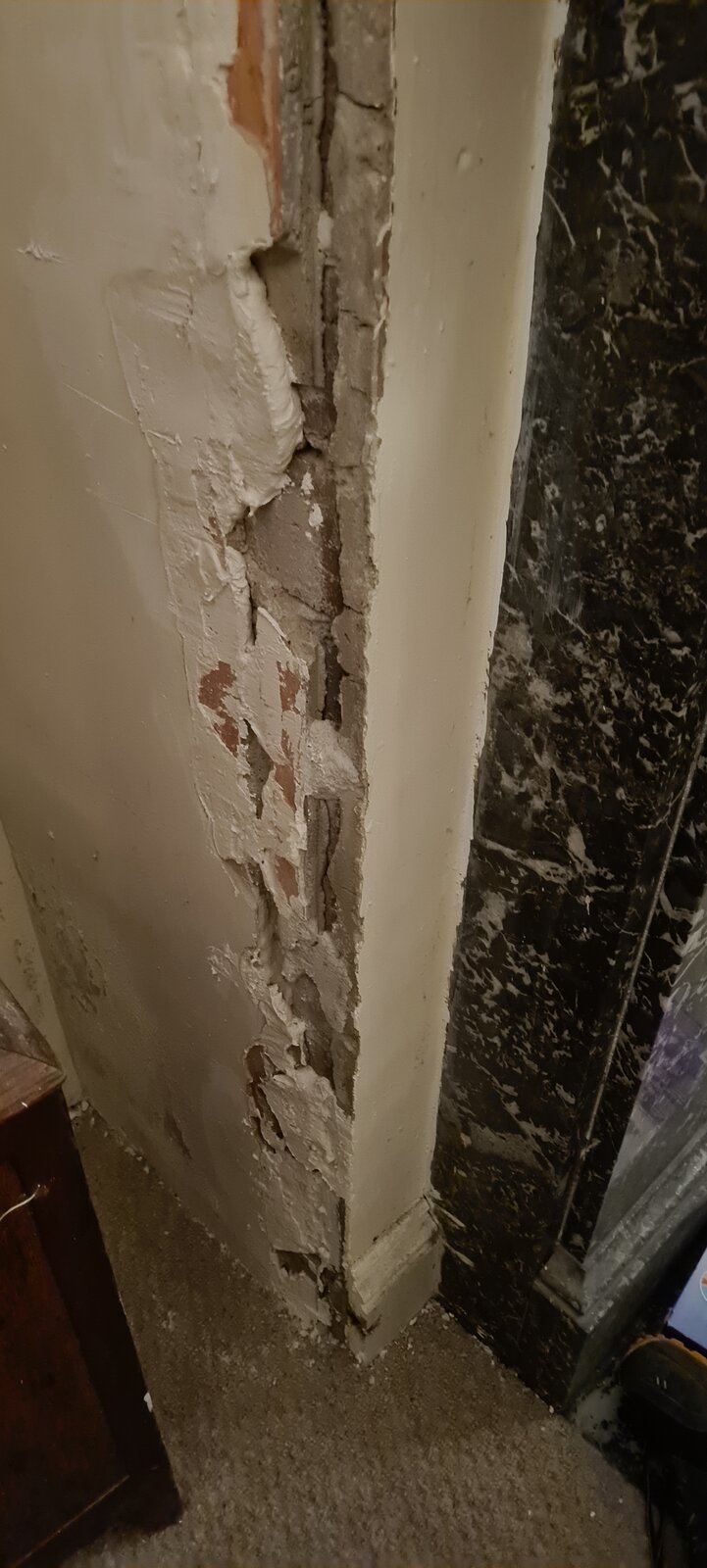

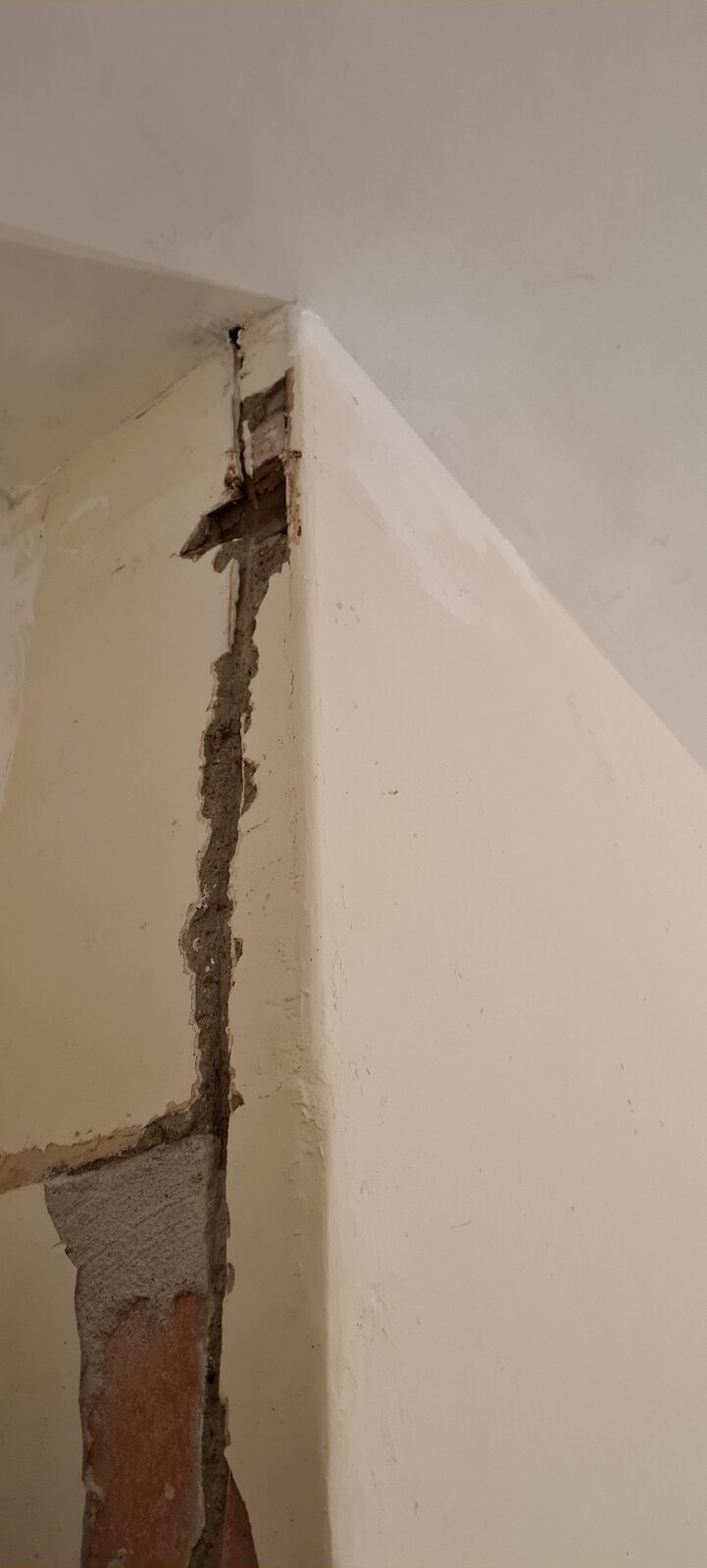

The wife has booked a painter to come at weekend but there is a bit of a mess in the corner of the room that needs fixing and I can't get anyone to help before weekend.
So the plan is to remove the old wood corner bead at the top. Chuck some bonding coat on and then fasten the corner bead on and finish with multi? Or do I pack the corner bead out get it square first and fasten first ?
I have only done small areas and never done a corner repair but it can't look much worse.
So I'll have a go at heaving the plaster on the wall before the painter wiggles his brush while drinking tea....

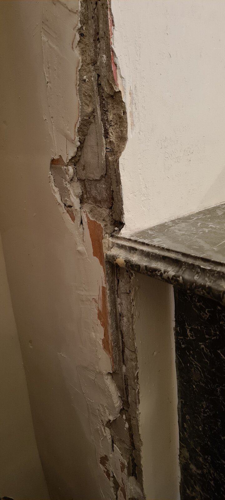

What floor are you on - is that a chimney breast corner?
You will need to remove the short piece of skirting and the round wood corner bead.
You will need a length of angle bead cut in two pieces - one from below the worktop or mantle piece almost to the floor and one from the worktop/mantle piece to the ceiling.
drop plumb lines beyond any damage on both sides of the corner and hack off all the plaster that remains in between the plumb lines.
Fix and set the two corner angle beads using dabs of whatever plaster your using.
Set the bead for a 90* corner
You'll need a level and a couple of straight edges.
Now Leave the bead alone until the dabs set firm - then take up suction and begin filling in.
Be careful not to disturb the bead.
See youtube for lots of helpful plastering vids.

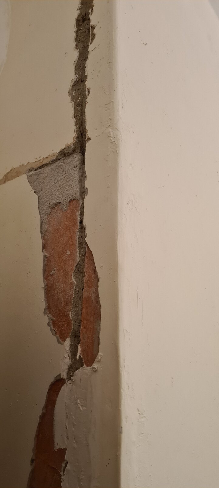

Theres what looks like damaged plaster lower down and further back on the left hand wall - without pics i cant tell what kind of damage it is.
chop it all off , stick a nicely cut plasterboard directly to the brickwork and fill the corner out and sand it back.
Thanks. It's ground floor and yes it's corner of a chimney stack. I hadn't thought about adding plasterboard but that will be much easier to get a level finish i imagine. I might well do that.
I have a couple of levels I was going use. I don't have anything to drop a plumb line from or would you just put a screw in the ceiling and drop it from that?
The damaged plaster on the chimney breast side wall and the back wall would most likely be hygroscopic chemicals that have come through the brickwork from the soot in the dirty flue - its possible that on the other side of the chimney breast the alcove is in a similar condition?
Why not closely examine the walls in the room at skirting level
The modern practice seems to be knock off all the plaster to one metre high or, in your case, to take off all the plasteron the chimney breast side, floor to ceiling and then render with saand and NH lime - do the back wall to 1m high.
For a number of good reasons dont use plaster board eg. if the chemicals can come through bricks and mortar then they can tear through plaster board.
None of this will help you solve your original question by week-end but it is what it is. Your choice?

The other side is fine. The failing plaster i am pretty sure is due to a poor repair job from an electrical cable that was almost buried in the plaster . The cable has been removed causing the gaps. No evidence of contamination or anything. I'll have a think. I have some board and dab already so might just try it and if that fails get a pro in to sort it out!
you misunderstand me. i'm not talking about the corner damage but the contamination damage that can clearly be seen further back and lower down on the side wall and on the back wall.
Perhaps you dont realise it but you have been given pro advice!
use plasterboard. stick it with gripfill.
