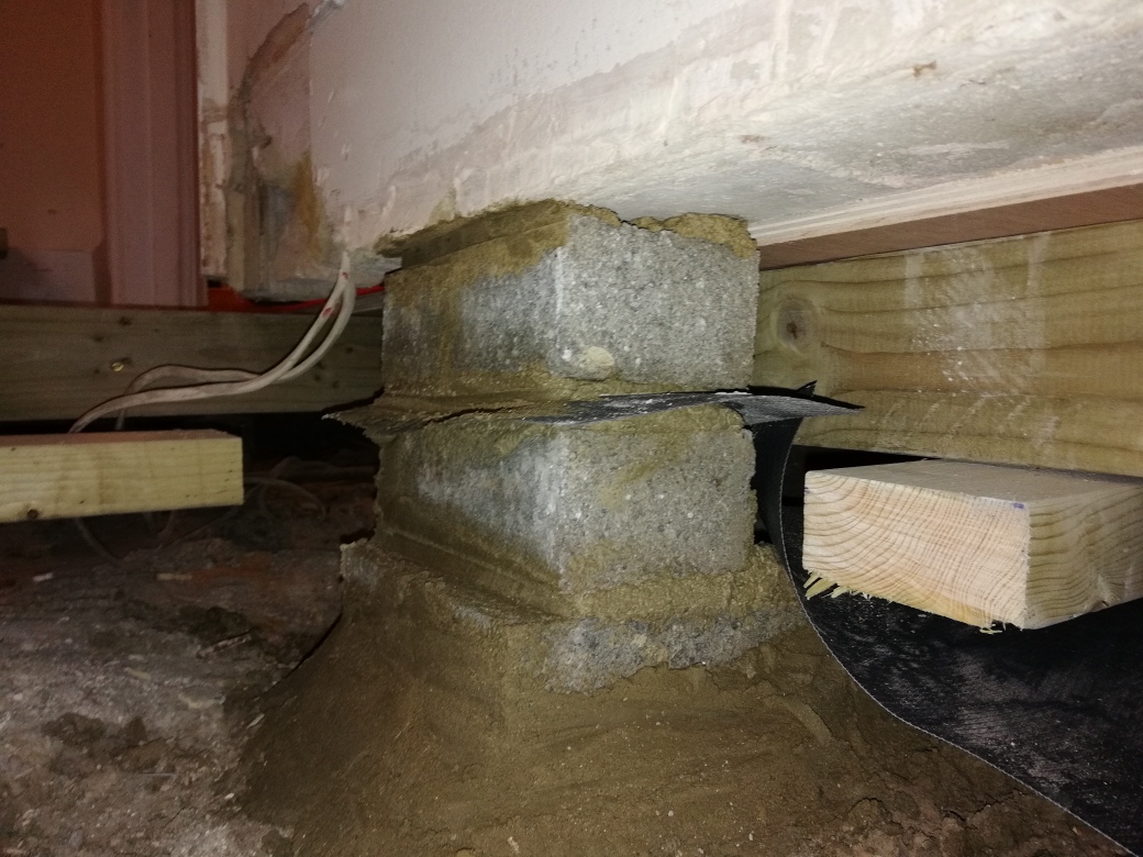

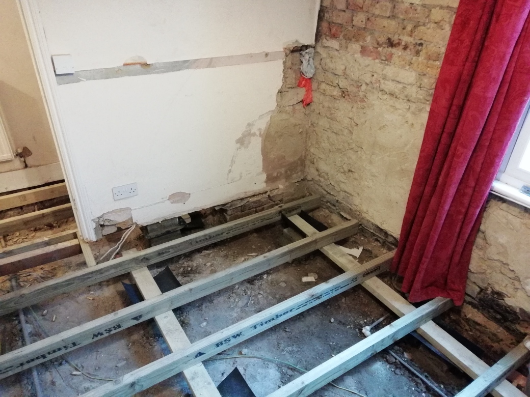

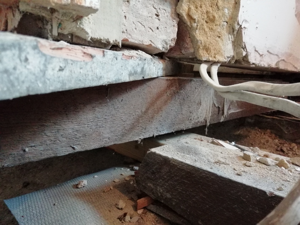

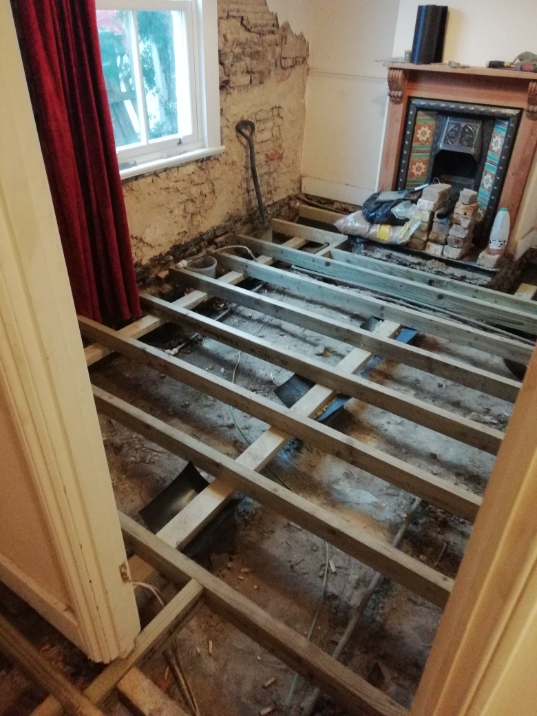

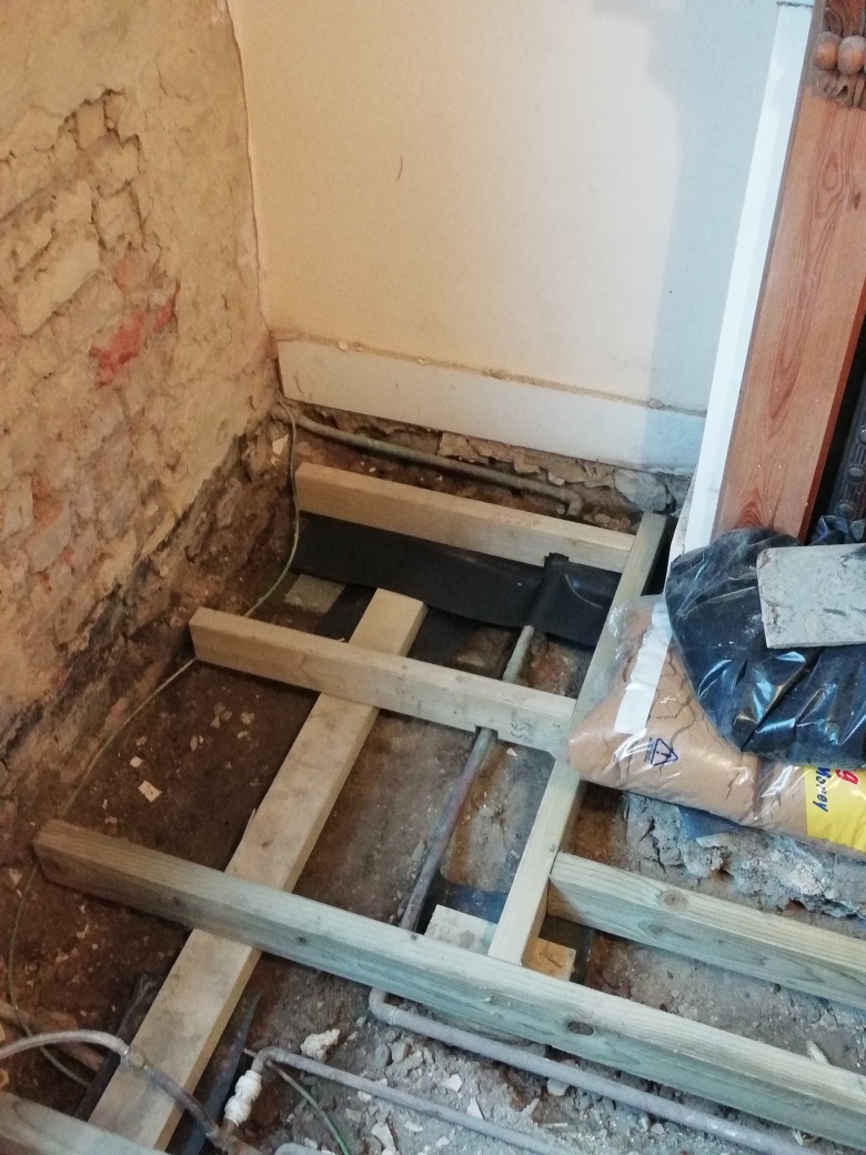

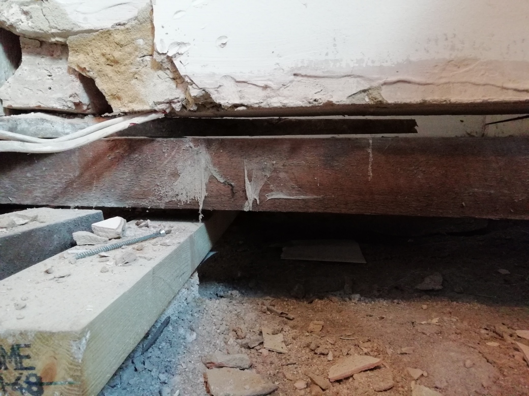

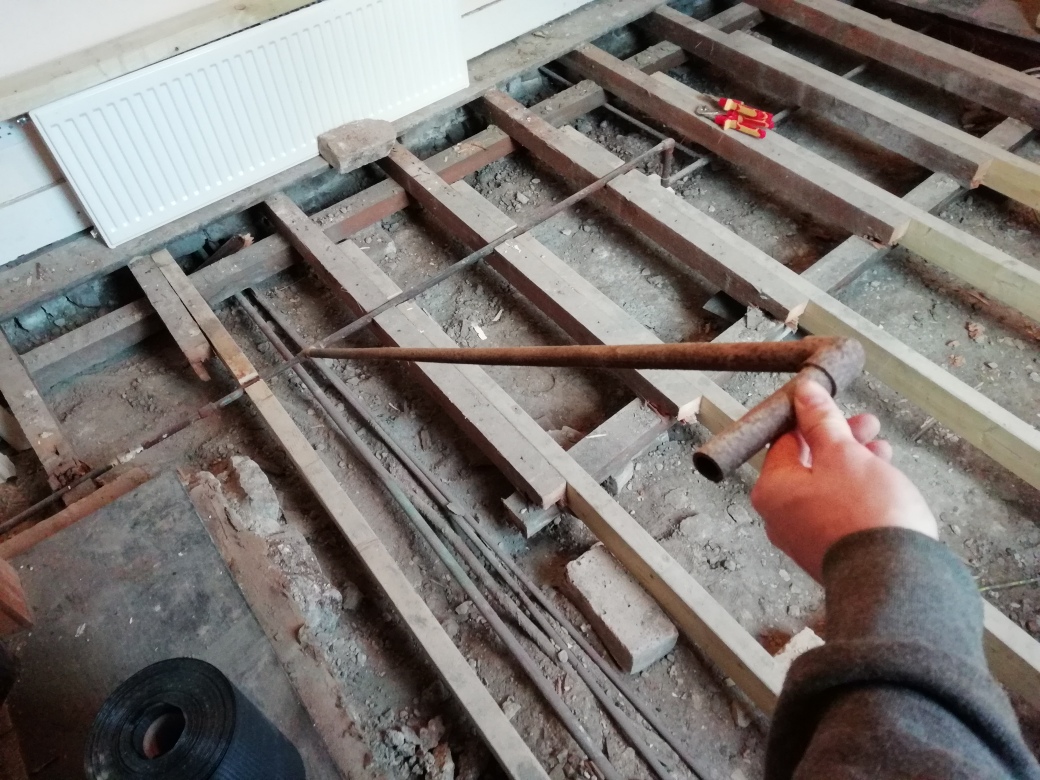

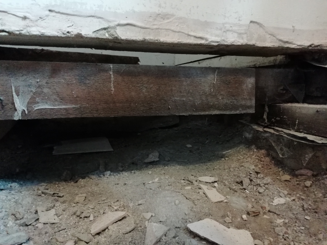

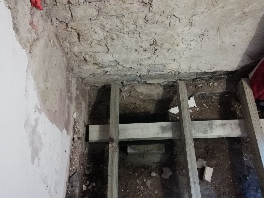

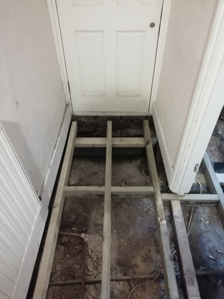

All the original floorboards rotted due to the lack of ventilation from the concrete at the front garden despite having two air bricks. Concrete was dug out and a little concrete put in the front garden for about 30cms adjacent to the sitting room wall. Air bricks have been removed and small round telescopic vents, walls replastered and floor redone.
The whole floor hall and sitting room including original floor and joists were replaced with new joists, bricks to support them set in concrete and Meyer brand ply wood.
The floor joists seem to be too far apart underneath the floor and part of the Meyer brand ply flooring collapsed in the corner to the right of the chimney breast where I had furniture on.
The plaster was completely replaced and a big gap left around the sitting room window sill, which I have been advised to fill with expanding foam filler.
I have been told by some builders to just patch up the floor ply in sitting room and hallway. Another builders advised to rip all up the floor and joists and install 20mm moisture resistant tongue and groove and new joists. Another builder said to tip up everything, install Kingspan over the earth foundations in hall and sitting room and a layer of concrete to insulate the floor. I have also been told to install a vented cap on top to prevent water ingress by the chimney walls.
For the front, advised to put in a concrete slope to stop rain water flow to front wall ground area, membrane to remove laying water away from house, fill front garden area with gravel/slate/shingle.
I'm not sure who is correct as some information and advice is conflicting and all expensive.
I have attached pictures of what is fitted underneath the hall and sitting room floor which is Meyer brand ply - picture to follow of Meyer ply
Any advice would be greatly appreciated.
