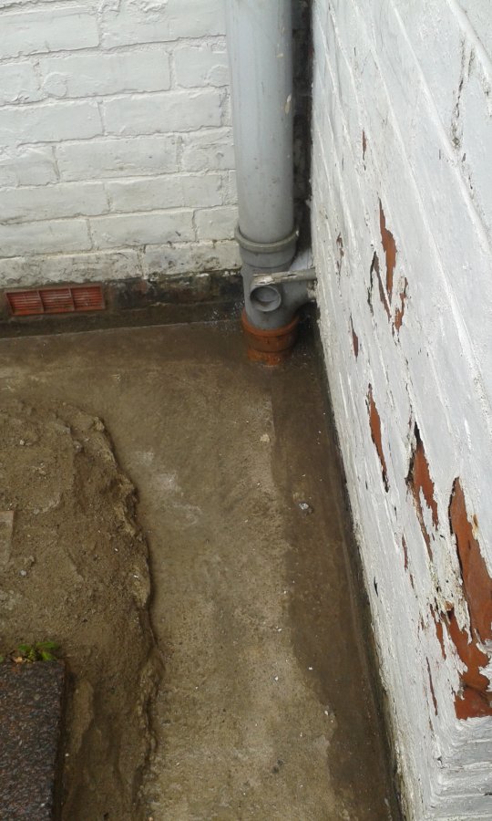

Now I have found a large hole in the concrete seal surrounding a 1st floor toilet waste pipe and its cistern overflow pipe which has either broken away or never been there in the first place. The missing part of the seal is hard to see from the yard as the missing part is between the big pipe and the wall. I assume that this is the main cause of the damp as rain can easily enter the wall cavity and it lines up with the main damp patch inside.

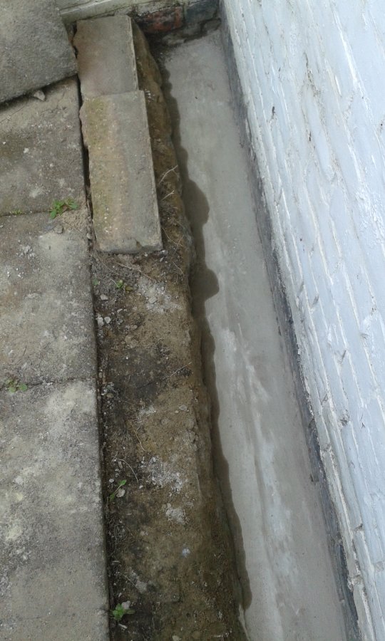

There was also a 'nice patio' where earth was very close to the bottom of the wall which always keep the gap between the patio and the wall dark with damp - I've cleared that back and now the concrete is always dry and light grey.

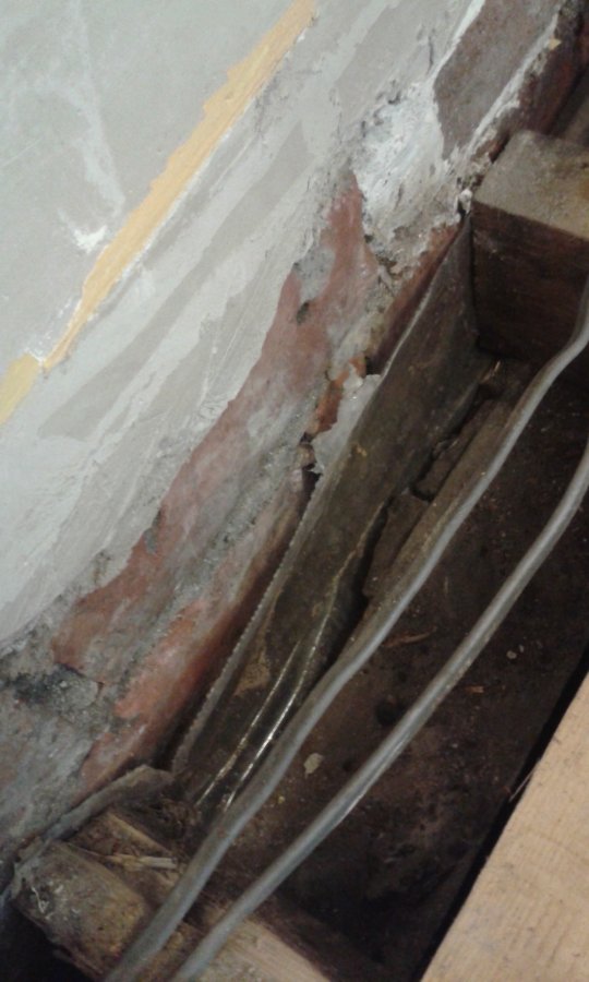

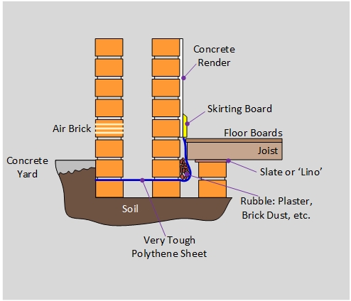

I've taken up the floor boards and determined the general wall construction as shown in the attached drawing and photo. There are some items that I have guessed at, like the plastic sheet jumping beteen the two sets of bricks so if you think the drawing may be wrong please say.
My question is about the general design of the wall and how it does do whatever it does to protect against damp? It seems to me that the plastic sheet is some sort of damp proofing but I can't find any reference to this design on the internet. Can anyone tell me if this was a standard practice and/or direct me to a reference document please? I want to know what I should do if anything to aid keeping the damp at bay. I assume that I should clear all the debris that has dropped down from the walls into the plastic 'bag' (for want of a better word). Also there is one air brick in the wall concerned and three on the other side of the room - should these have air vents on the inner walls of the cavity to let air under the floor? I think that the plastic will block any such air flow.
Was this plastic a bodge that should be removed?

Unless you have opened up the cavity you cant know how things are inside it? It would probably be a good idea to open up the cavity and be certain of how things are inside it.
The ground level is too high could you post a photo of the external wall at low level.
Besides the plastic sheet, can you point out the internal and external DPC's?
The air brick is useless - its the sub-area not the cavity that should be getting through ventilation.
Approx three air bricks would be needed for a rear elevation.
Any gaps around the soil pipe for instance can be filled with a semi-dry sand and cement plug.

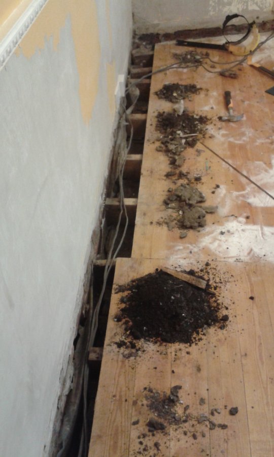

For some reason there is a brick missing from the inner brick course (leaf?) of the wall in question. It is below floor level and while the occupant has lived in the house for over 8 years the missing brick may be the result of someone previous exploration of the damp (I suspect it was freshly covered over when the house was sold). I rescued a good deal of what looked like damp soil from this hole. I confess I haven't looked into the cavity very far - I will do this when I get access again.
The houses in the area are build on a slight hill with the yard upper most - now you mention it I have drawn my illustration by starting off with a 'standard' sort of layout - in fact the yard concrete is higher that the floor inside. I'll change the drawing.
Both the inside and outside brick courses have the twin plugged holes that indicate the pressure injected DPC I believe - I can't see any other membranes, though I might not know one if it bit me!
"The air brick is useless - its the sub-area not the cavity that should be getting through ventilation." I agree that's why I wondered if the scheme was a standard design or if it is a bodge.

The one showing the waste pipe in the corner looks wet with damp but thats just water I had added - it shows the only air brick in the wall in question. The injection holes are in the upper row of the black painted bricks and in the white bricks over the air vent.
The piles of detritis showed in the indoor photos show the big pile of damp/dark 'soil' where the missing brick is.
You can see on one photo that the 'patio' is still leaking water but it can't now reach the wall!

I suspect that the plastic sheet was installed to protect the tails of the joists. They might have had previous wet rot difficulties. In fact, that whole floor might be a replacement floor.
What are the joist tails resting on?
What space is below the joists to the oversite soil? 150mm?
Its necessary to take out a number of bricks to make an access hole to the cavity.
Injected DPC's are a waste of time in my book - especially when you have bridging from the high ground, and perhaps inside the cavity.
You have created a channel against the yard wall but where is that water going to drain to?
To simplify: Membranes are in sheets - DPC's are in rolls about 100mm wide.

"I suspect that the plastic sheet was installed to protect the tails of the joists. They might have had previous wet rot difficulties. In fact, that whole floor might be a replacement floor." - This comes back to whether or not this plastic sheeting is a standard building technique - would it have been done when the house was built or is it a definite modification in the past 100 years? I suspect the injected DPC is later given the general technology. There is a section of the floor in the corner adjacent to the wall that has much wider floorboards than the rest and I so I guess that these must have been replacements at some point since there is a definite join 'line' across one of the joists, but of course when and why is a mystery.
"What are the joist tails resting on?" - The joists are resting on low brick courses, one course pretty much at the end of the tails. The joists seem to be isolated from the bricks by either thin slates in some places or what seems to be Lino in others. I say lino in that it is the same thickness and breaks in the same way as Lino.
"What space is below the joists to the oversite soil? 150mm?" - The joists sit on two rows of bricks so probably a bit more than 150mm. I note that the soil under the floor is quite dark, next time I get in I'll collect some and see if it is damp.

"You have created a channel against the yard wall but where is that water going to drain to?" - The wall meets a smaller wall at right angles, at the end of that wall is a drain - I plan to angle grind a very small slope in the concrete floor along the length of the wall to lure the rainwater away from immediate contact and hopefully to slope gently to the drain. I have monitored the way the water stands after a few bucket fulls of water and while it does not run fast, it does drain to a thickness that dries after about an hour.

It is usual to install polythene around the ends of joists after wet rot, yes.

Maybe if you removed the concrete bed from the channel and dug down a little and filled with stones you might create a kind of French drain?

The cavity might be blocked with debris bridging any inner DPC.
The sub-area needs all the ventilation it can get.
An old house, with a damp patch near some plumbing, when the other walls are not damp, immediately draws the mind to plumbing leaks.
It is quite normal for the old salt-glazed clay gullies, bends and pipes to be cracked and broken in the ground, especially at the bends and sockets, and for the water supply pipe to be leaking.
