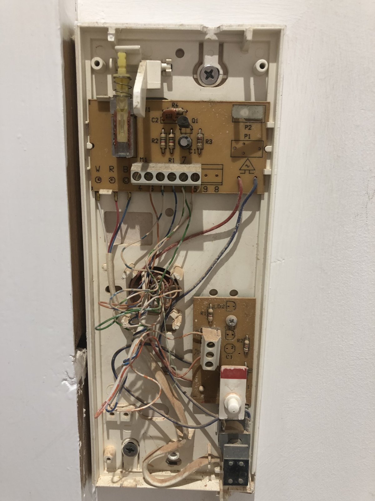

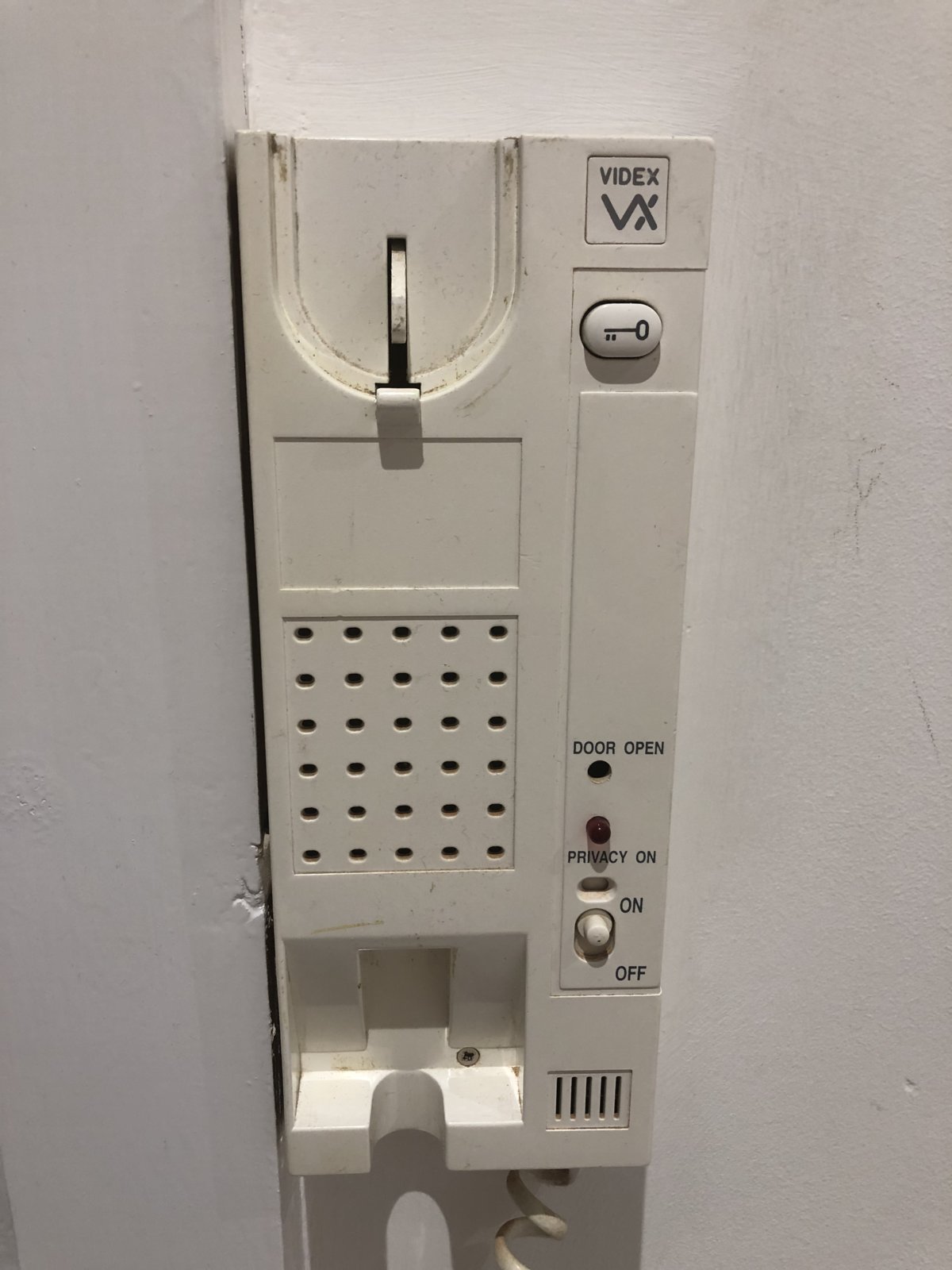

I have moved into a flat with a Videx intercom system.
The handset looks really scruffy and old and has old cello tape wrapped around it.
I would love to replace it with a newer model but which one???
I’ve attached a couple of pictures of the inside and outside if anyone can help me!!

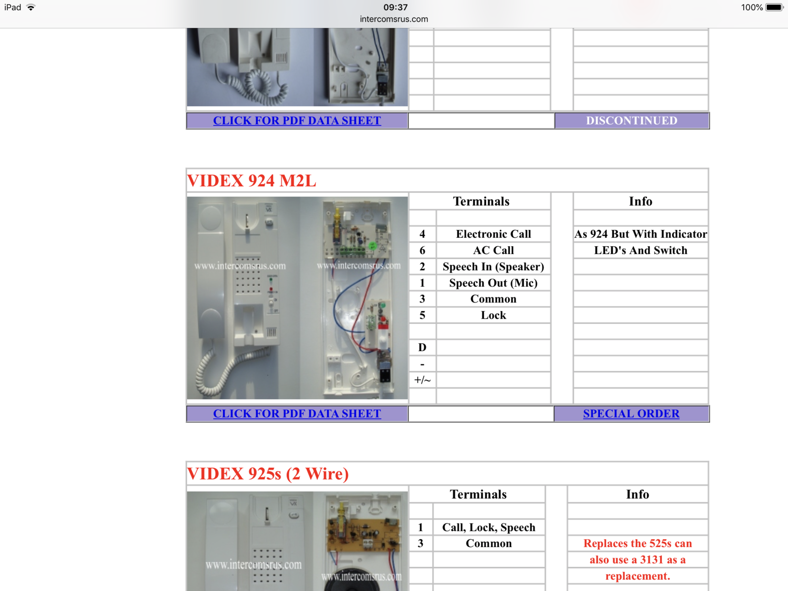

869B5C56-C64D-481E-84C3-C5F47323B31F.png The model number is normally on the back of the unit , have a look then go on “intercoms r us” handset finder page
