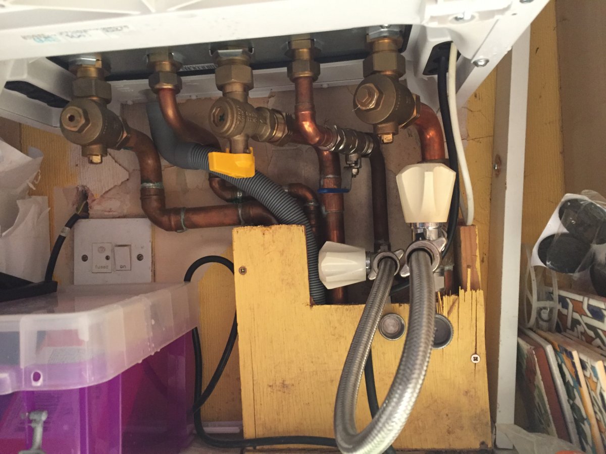

Pressure at about 0.4 needs increasing. Thought loop was obvious - flexible tube on right in photo. Whichever order I open 2 "taps" the tap on left sprays out cold water and pressure does not increase.
Help please.
A wee tighten of the LH winged silvery nut should do it. Hand tight is usually enough.
Thanks. But already tight! Tried it again and got sprayed again! Hmmm
Oring will have split.
Need to open both taps.
For tonite just hold a towel round the joint.
Then call in your plumber or buy a new hose/oring for next time.
How many times are you filling the boiler in the last couple of months?
