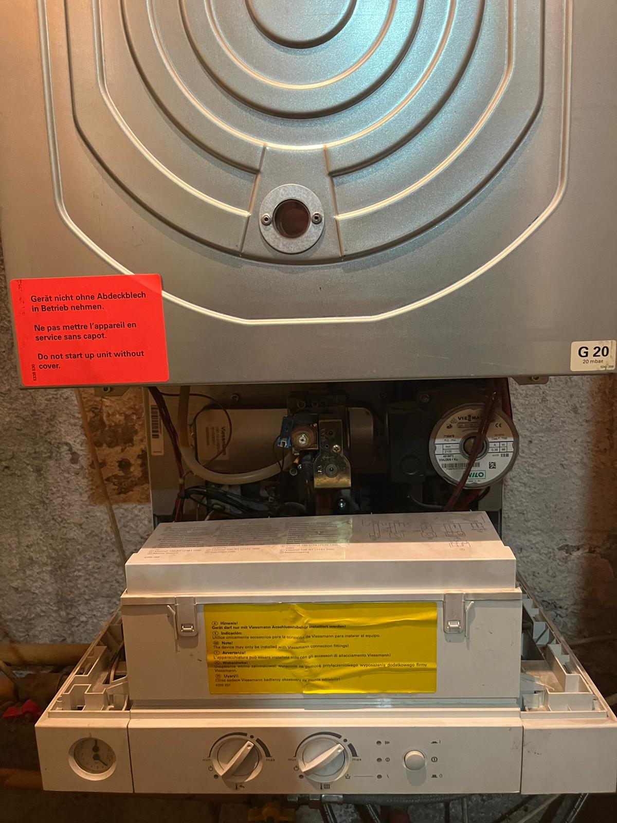

The sound is coming from the pump in the photo.

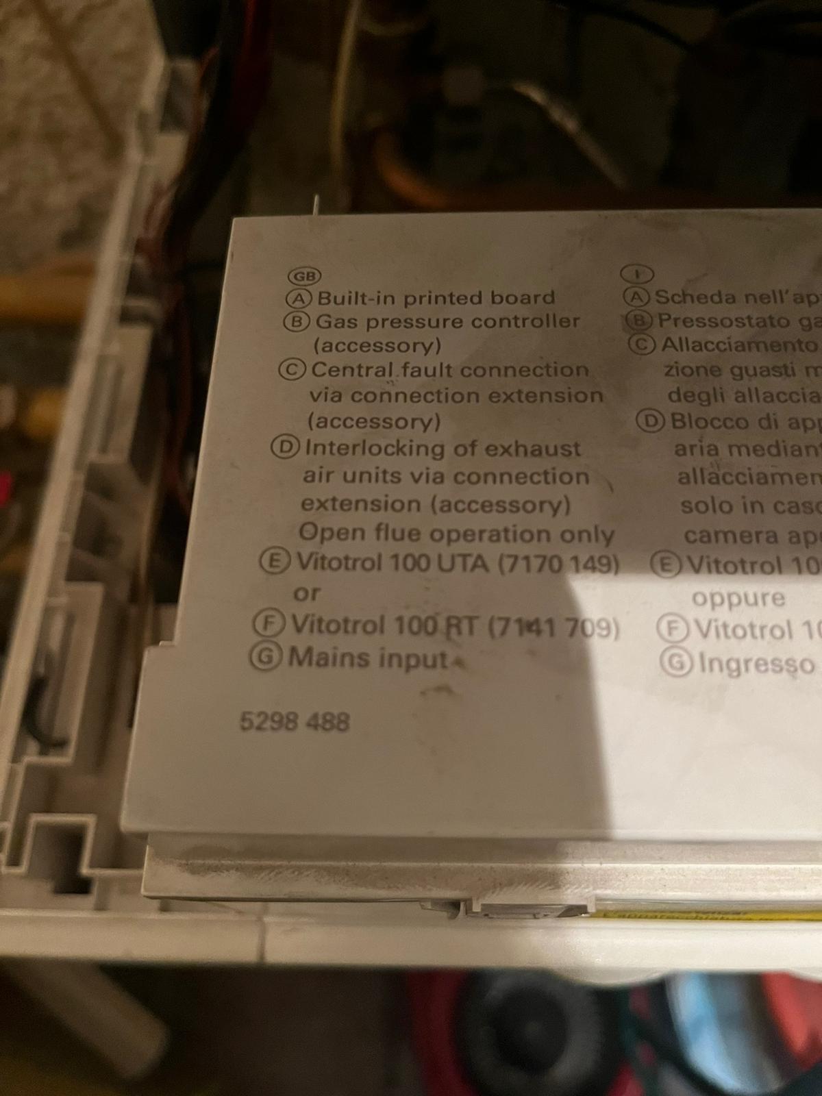

regarding the model im not sure, manual is generic for multiple types on the cover there is just Vitopend 100. This model has no display just temperature and pressure monitor. It came with the house when i bought it.
Whole picture of boiler that might help identify model.
