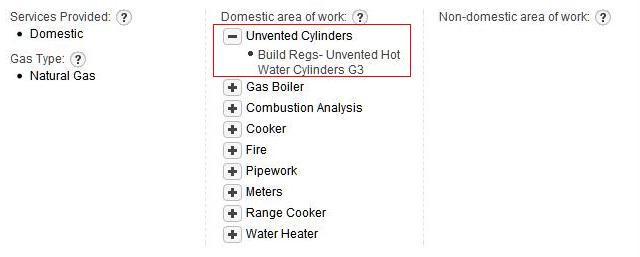

I have checked with the gas safety register and the plumber is registered with them.
He may be registered but does he have the required unvented qualification. This is a sample taken from the register. If the plumber does not have the necessary G3 (unvented) qualification, he is working illegally - the same as if he was not registered for gas boilers.
The plumber has filled in the cylinder benchmark form (but not handed it to me I found it a stack of papers stuck behind the boiler pipes).

I have rechecked the gas safety register
and he is not down as qualified to fit an unvented cylinder
also to clarify he has filled out a benchmark for both the boiler and the water cylinder. neither of these were handed to to me
and you are quite correct that I have not signed the one for the cylinder.
and he is not down as qualified to fit an unvented cylinder.
Report him to Gassafe.
You should also ask how you can get the installation properly checked and commissioned.

The gas safe register is only about gas.
CORGI used to list unvented certificates and Gas Safe later started to list them but thats totally voluntary!
I am qualified to work on unventeds but thats not shown on my Gas Safe listing.
Tony
CORGI used to list unvented certificates and Gas Safe later started to list them but that's totally voluntary!
So how does the man in the street know:
a) The installer has to be specially qualified to fit vented cylinders?
b) That the installer he has selected is properly qualified?
I am qualified to work on unventeds but that's not shown on my Gas Safe listing.
Wouldn't it be sensible for you to show that on your Gas Safe registration?
Since the man in the street does not know about the need for registration then it rarely arises.
The way to demonstrate the qualification is to show the customer my Water Card.
I was listed for G3 by CORGI but G-S did not carry it forward when they took it over.
To get relisted I have to find my Certificate and send it to them. Since no one is even bothered there is little incentive for me to do that.
Tony
