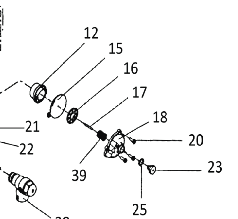

Vokera linea 28. Error 04, water pressure OK. Micro switch is not pressed.

My thought exactly. I dont have service and instalation manual unfortunatelly. In the one you provided there is a DOMESTIC FLOW SWITCH / FILTER P/n 1488. I wonder if this has anythign to do with the problem - it has electrical connection:

Vokera part no 6872
Part 6867 is the bearer plate that diaphragm sits on and spindle is part no 6888
I mean the diaphragm was replaced with good quality part.
Everything here seems in order.
Item 17, the plunger passes through part 23 and is attached to item 16 which itself rests on the diaphragm 15
In idle state, the spring retracts the plunger. System water is exerting same pressure on both sides of diaphragm
When the pump runs, differential pressure is created across the two ports
This differential pressure is applied to the flow manifold
+ve pressure is present base of diaphragm and -ve at the spindle side- spindle pushes out
Spindle will not push out without pump run; if it does then there is a defect
Greater differential is created during heating mode as indicated in post 12
Item 1488 is present in every combi boiler by Vokera in one form or another. This part tells the boiler hot water is needed.

The pump was replaced. 3 days on, the boiler works as expected.
The old pump was not stuck/seized - rotates freely. When it does rotate.
Seems like a weak pump - I am not sure what 'weak' means, but it seems the pump can not produce enough pressure to operate the plunger as described in the above post.

Weak capacitor. Said it multiple times. Would have cost £5 for a new one and its just a case of undoing a screw on the box on the side of the pump, pulling 2 wires out and pushing the new ones in.
