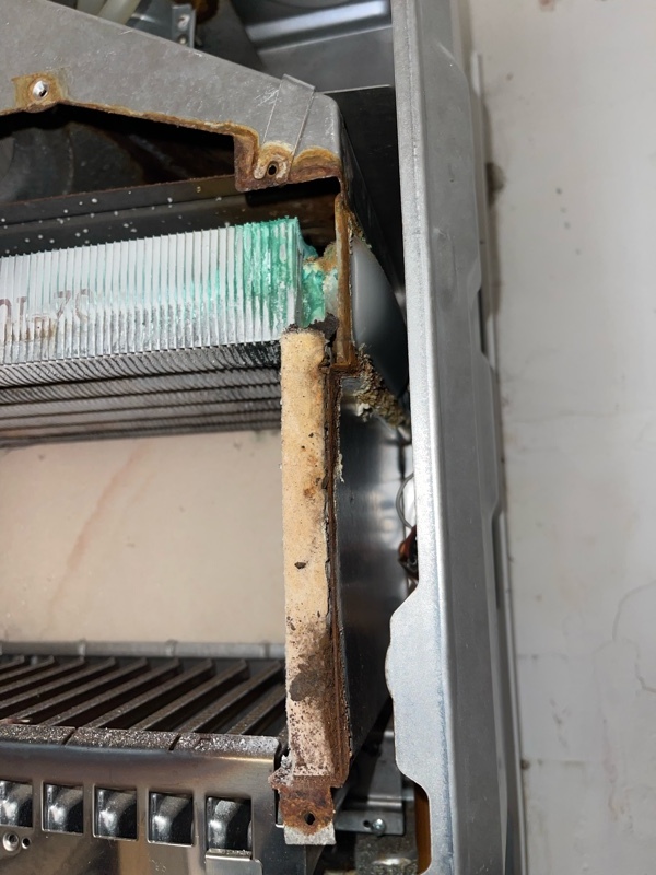

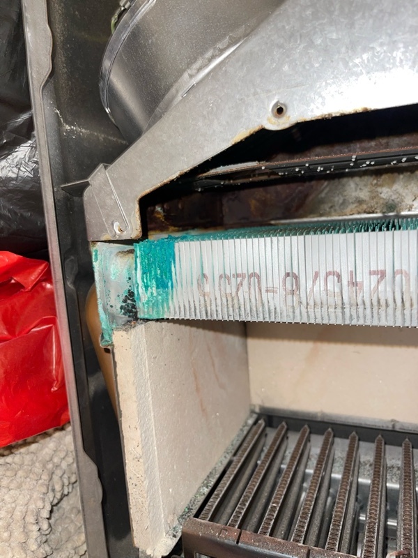

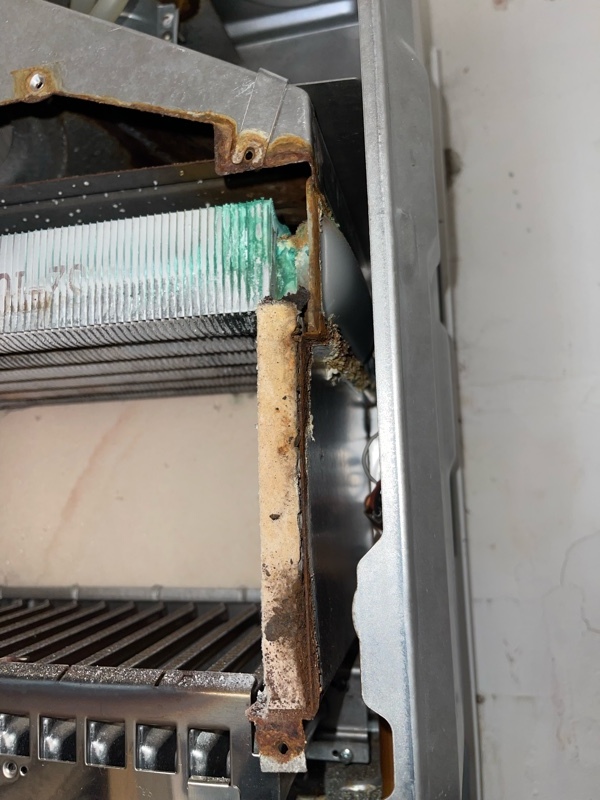

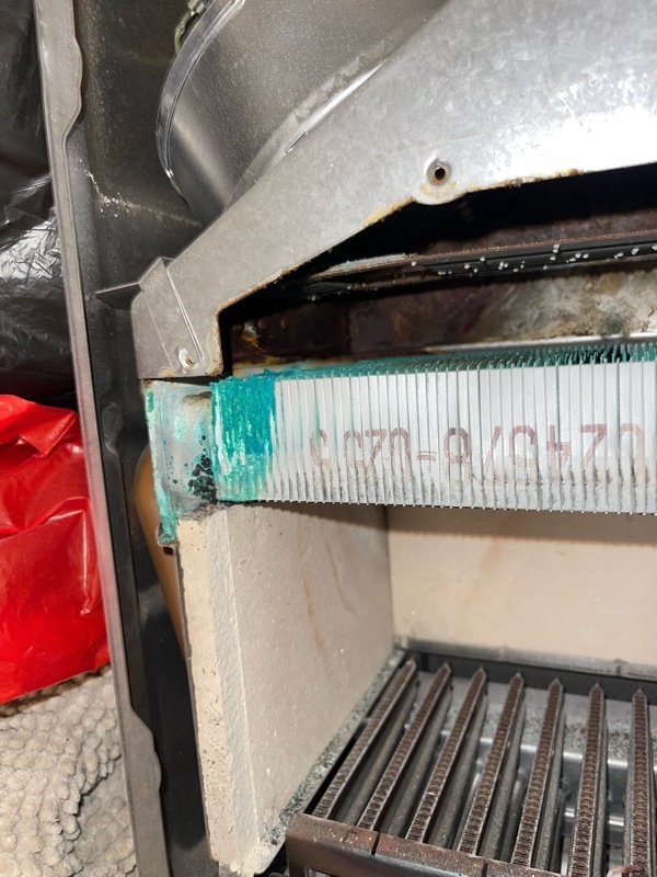

I think it's the main heat exchanger that needs replacing - my boiler has been losing pressure for a long time - at least a year(about 0.2 bars each day). The pressure was having to be topped up every few days. Had several companies out to look at it. No-one could find the issue. Told me it must be a leak on the system. Then after finding a video on youtube I convinced someone to have a look at the heat exchanger and this is what they found (see attached photos) and concluded the heat exchanger had been leaking.
I've been quoted £495 plus VAT to suppy and fit a new "heat exchanger" is what it says on the quote.

Ah, I understand. I would be happy to pay £300 but I'm thinking with the boiler being 20 years old it is maybe not worth paying to have it fixed?
It would appear to me that not only is the main heat exchanger needing to be replaced but there are several other parts that are corroded and could present a problem ...
So I think I will just phone around for quotes for a new boiler...
