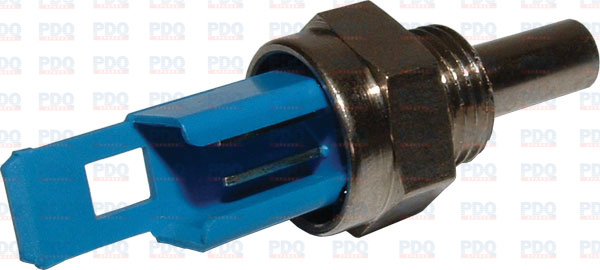

Hi group, we have a Vokera Syntesi 35 boiler, just had an fault with the expansion vessel which has been resolved by fitting an external one in the loft, ran for a week but now I am getting an error code 07 which denotes a faulty thermistor. I would like to replace the secondary thermistor, is there an easy way to drain down the boiler without having to drain the entire heating system?

Fault code 07 refers to faulty PRIMARY thermistor 06 is the secondary thermistor, unfortunately the site rules correctly prohibit anyone from helping you with this as it involves work that only GSR can legally undertake sorry , you will have to get someone in
Update: Primary thermostat replaced by my local gas man, all has been well for the past two months (y)
