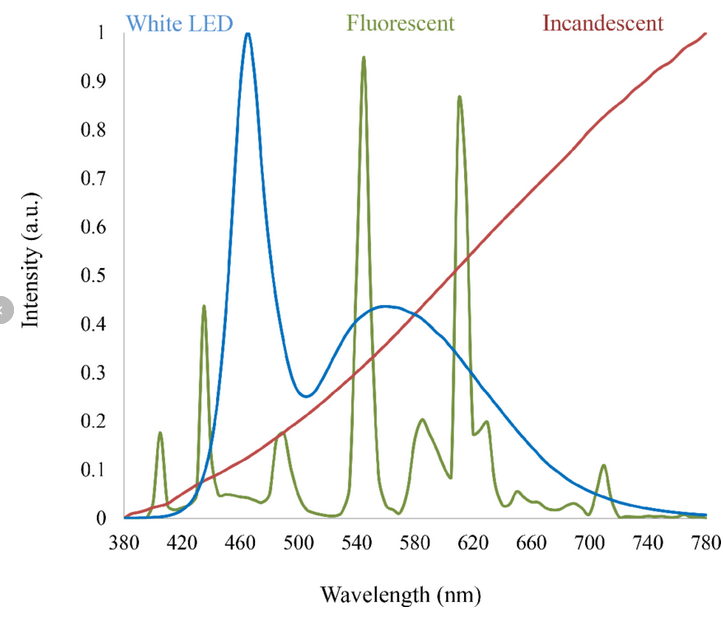

You can get modern LED's in various colour temperatures, including warm white. I defy anyone to tell the difference between my warm white LED's and tungsten ones, except by feeling the coolness of the lamp when running.
The spectrum of LED light is not continuous but consists of several peaks, it does not include much if any near infra-red
this chart from https://phys.org/news/2016-04-full-visible-spectrum.html
760 nm is the start of near infra-red ( 760 -1500 nm )
The spectrum of light from an incandescent lamps is rich in near infra-red.
It is likely that the lack of near infra-red that causes some people to find "pure" light uncomfortable.
Light has in the past always included some infra-red and the body finds it unnatural to have light and no perceptible heat.
Maybe the low light receptors ( rods ) in the eyes of some people do respond to near infra-red as well as visible light.
To perhaps be a little pedantic, what you show is a 'continuous' spectrum, albeit one with multiple peaks.
760 nm is the start of near infra-red ( 760 -1500 nm ) ... The spectrum of light from an incandescent lamps is rich in near infra-red. ... It is likely that the lack of near infra-red that causes some people to find "pure" light uncomfortable. ... Light has in the past always included some infra-red and the body finds it unnatural to have light and no perceptible heat.
That is all true, but I think that it applies as much to (visible) red as to IR. We all know that (visible) red light appears 'warm', and I would imagine that in a (visible) red-lit environment, people might well perceive a given actual temperature as warmer than if the lighting were further towards (or included more of) the blue ('cold') part of the spectrum.

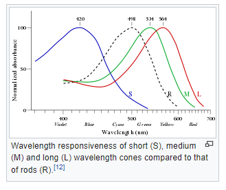

No. As you would know if you go out at night, rods are minimally sensitive to ('visible') red (red objects are almsot 'invisible' at night, looking 'black'), let alone IR (i.e. they are much less sensitive to red the 'red-sensitive' cones) ...
It is generally said that the upper limit of human visual perception (as above, dictated by {'red-sensitive} cones) is around 740nm. Many other animal species (particularly birds and insects) have a much lower upper limit than that, being able to 'see' little, if any, red, but do have the ability to 'see' down into UV, hence below the lower bound of human perception. The only animals I've heard of that can 'see' (perceive) IR are some species of snakes, but there might be others.
