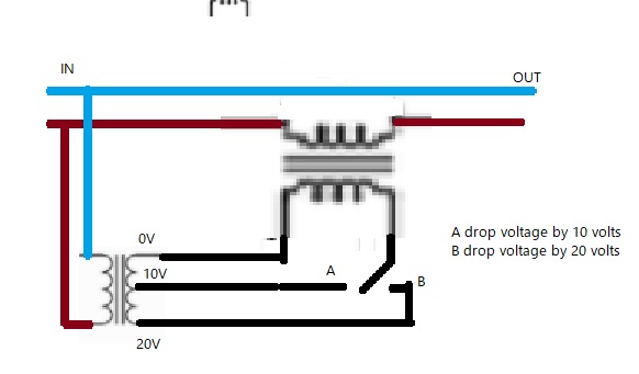

A roughly drawn image of how they work
The little transformer produces 10 or 20 volts AC which is fed anti-phase to the larger "transformer" thus reducing the voltage on the output by 10 or 20 volts.
The large "transformer" is not operating as a true transformer but as a type of choke.
In modern devices the little transformer is an electronic device.
The previous comment about them being a waste of both money and energy are valid. The only benefit is when supplying power to incandescent lamps where a lower voltage can prolong the life of the lamp. But then the same effect can be obtained using a simple step down transformer
Thanks Bernard, I get the principle now, I did wonder how they got the thing that small.
