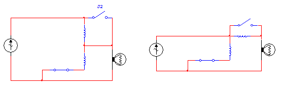

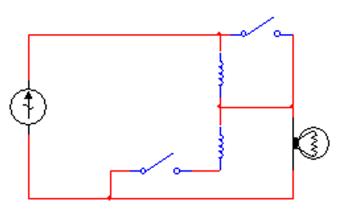

to drop the voltage be it called an auto transformer or a buck transformer it really does not matter. The 8 amp rating does limit its use some what but some how one needs to switch the 27 volt winding at the top in and out of circuit as and when required. You can't short it out as it is on the same iron core. So if two linked relays one normally closed and the other normally open short out the top coil at same time as opening circuit to bottom coil you could switch in and out the 27 volt without actually ever removing the connection as long as the top switch is never made at the same time as bottom switch it will work. Likely from the video that is what the semi conductor devices which burnt out did. Likely bottom switch was the semiconductor switch and top one the relay. However that guy is way beyond my level and if he could not work out exactly what they did then very little chance of me working it out.
Should the relay stick and not release before the bottom connection is made there would be a huge current likely to burn out something. The idea of using an auto transformer to drop from 415 volt to 380 volt for imported items pre-harmonization is well known and I have worked on sites where there was one such auto transformer at the base of every tower crane. However to switch in and out a 27 volt reduction is very different from a constant 35 or with single phase 20 volt voltage reduction.
If the firm has gone then there is very little one can do but rip it out. With the limit of 8A there is little one can do unless you used the auto transformer just to power the lights. Since it does not save energy with LED or HF fluorescent then its use even with the lights is limited. Other than lights I can't think of any benefit in lowering the voltage. Why it even attempted to drop the voltage to sockets I don't know.
I would say it will take far less man hours to remove than to repair. And if the four semi conductor devices he showed have blown like in his example why would one think replacements would not blow in the same way?

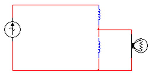

So to left is auto to right is buck thanks. Really not much difference does the same thing both shown as 203 volt with 230 volt input or 213 volt with 240 volt input. 27 volts seems a little on the extreme side and one would see a massive dip with tungsten lamps unless fed with a electronic transformer in which case no point in having the device. Would be interested hearing from some one with one fitted did they notice when if came in and out of circuit? If not then I would assume not working.
