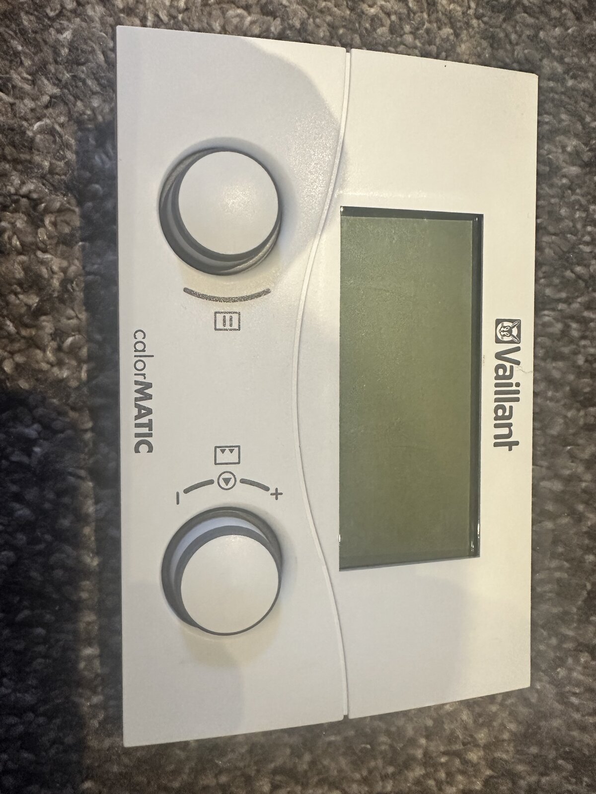

I have now added a VRC470 in the Facia of Boiler ecoTec 630.
So the Setup is as others with
- Nest 3rd Gen Theormostats for Heating Circuits - Nests Control Heating Zone Valves and the Boiler Switched Live RT (Terminals 3,4)
- VR65 with Cyl Terminals (Grey, Orange)
Without the VRC470 in the Boiler Facia, all works well, however Once the VRC470 is installed in Boiler Facia, the control of Demostic Hot Water charging is LOST. The VR65 is receiving the DHW Demand voa the Cyl Termsinal (Grey, Orange DHW Zone Valves), but for some reason the Boiler is either not getting the DHW demand signal or the newly installed VRC470 is inhibiting the DHW Charging.

Looks like I have solved it.
For anybody else experiancing this the solution was to Toggle the Settinings under Installer / System / Domestic Hot Water/ Cylinder - Active to Inactive to Active again, then it all works.
To be fair, having the VRC470 in the Facia as oposed to not having it, does not seem to have any benefit, as all the settings via the d. codes directly within the boiler / interface seem to still control all the temperatures (DHW, Heating etc), and the Nests control the rest.
Ok glad you solved it.
I was just going to post to check the CYL right hand terminal has 230V in the VR65/66 - that is what instructs the VR65/66 to enter DHW charging mode and boosts the flow temp to 80 degrees.
The advantage of the VRC470f (in my case) is the weather compensation with the outside temperature sensor. This allows the flow temps to be modulated, whilst still using the Nest's to control firing of the boiler and the VR65/66 to enter DHW mode.

It looks like my Ecotec 618 Plus is too old to have the D.043 register, being installed in 2008. No reference to it in my manual, I do have D.047 which reads the outside temperature from the VRC 693, and the VR65 is working to give the DHW override, so I guess I'll need to find a VRC 470 to make weather compensation work. Having lifted floorboards from front to back of the house, then drilled through some awkward brickwork to get the cable to the boiler, I'm fairly committed to this. Meanwhile I can play with the flow temps and range rating manually, a chap needs a hobby. Thanks to all here, I had given up on this as a possibility without spending silly money on a vintage boiler.
If you boiler is too old get the heating curve by d.043, it may also be that it’s too old to use the VRC470. I originally purchased a VRC430 thinking that would be ok to fit within the Boiler Facia to control the Heating Curve, but then found my boiler was too new (2017 I think) and so found the fitting would not take the Horizontal Pins (of VRC430) but needed the Vertical pins (of VRC470).
I would advise you to remove the boiler Facia blanking plate first to check what you have there. It just pops out from a couple of retaining barbs in the plastic. Ie you don’t need to drop down the whole PCB control panel.
Thanks again, you're right it's horizontal pins. My manual mentions a VRC400, so it looks like I need one of the earlier models. Do you still have your VRC430 by any chance?
£15 plus postage if you would like it ?
Apologies for not updating this sooner, but the weather has been unhelpfully warm for setting up weather compensation. Thanks to bwel, I now have a VRC 470 to enable my VR65 and VRC693 to work. In a well insulated 30s semi, pretty airtight with heat recovery ventilation, the Ecotec Plus 618 is overkill, even rated down to 7kw for the heating, so the anti cycling function can mean very little heat unless I set a target temperature of 28 degrees in the VRC470, for an actual room temperature of 20 controlled by a separate thermostat on the switched live S plan controls. I'm not convinced we'll save a lot on our gas bill, but hopefully after some colder weather and more tweaking, a more even and comfortable temperature will be acheivable without much human intervention day to day. I'll also gain a much better idea of requirements for a heat pump if/when the boiler expires, probably between 6 and 10kw modulating down to 1 to 2kw.
