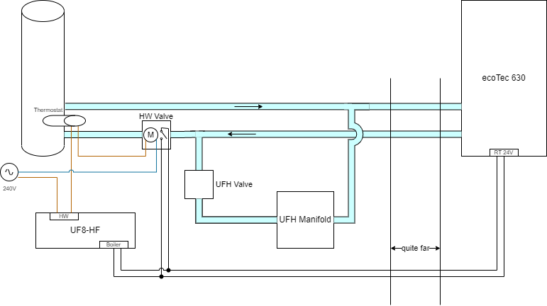

Hello all.
I have a Vaillant ecoTEC Plus 630 system boiler, in an S-plan setup with a HW cylinder and a UFH mixing valve. All of this is controlled via a Heatmiser UF8-HF wiring centre. The Heatmiser boiler enable contact is connected to the 24v RT of the boiler. The Heatmiser wiring centre's hot water contact switches 240v live to open the cylinder valve, and the cylinder valve's auxiliary switch contacts, is also wired to the 24v RT. All works well: when either the cylinder valve is open (and its auxiliary switch closes), and/or the UFH is on (and the heatmiser boiler enable contact closes), the boiler fires up and shows the radiator symbol. The trouble with this setup is that I can only have one flow temperature, which has to be set high enough to warm up the water cylinder: 65C. This means that when the UFH is on alone, and it requires a 35C manifold temperature, the boiler keeps on cycling.
My idea is then to have the boiler modulate its flow temperature: when UFH is on alone, it should be 40C; when the cylinder is on, it should be 65C. Possibly, the boiler should also have different heat partial load settings, which appears to be possible with Vaillant controls.
Reading on these forums, I came across this thread. In it, post #6 suggests that you can use the VR65 wiring centre as a dumb switch which sends a "call for DHW" signal when the CYL contact is closed. He says that "If boiler receives both 240v on RT for heating and eBus command for DHW charging the cylinder charging mode will take priority. When DHW charging is finished the boiler will return servicing RT request."
This is exactly what I want to do with my boiler, but with two variants:
1. Vaillant don't make the VR65 anymore, so I want to use its replacement, the VR66. The manual for the VR66, on page 6, says that you can use it in "Monozone mode (position 1) with VR65 functions". So it sounds to me that whatever was done in the above thread with the VR65 could potentially be done with the VR66 in this mode.
2. Instead of using 240v RT, I would like to keep my 24V RT setup.
Like so:

Aha, but my setup is S-plan, so no 3-port valve to worry about being stuck in the wrong position. The two 2-port valves operate independently.
The heatmiser wiring centre will still remain the brain of the system. It normally takes care of closing the UFH valve and Boiler contacts, that is regardless of the demand for HW. The UFH manifold has a mixing valve, so whatever temp the boiler's flow may be (45 or 65), the mixing valve will take care of stabilising the manifold temp to 35C.

My H/W valve has a switch inside which is voltage-free if you don't put any voltage through it. I *could* connect it to a 240v live contact, but I would rather work with low voltages throughout if it can be avoided.

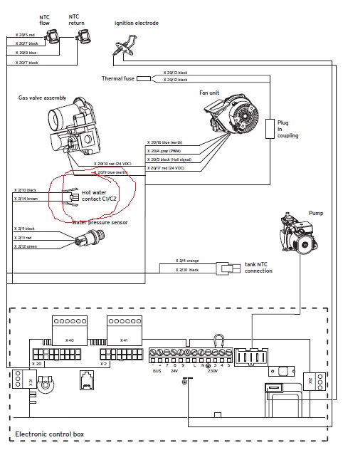

No need for a vr66 or any other Vaillant controls call for DHW using the C1C2 connection on the boiler harness (close to call, no volt) this creates a priority call for DHW at the set power and temperature. Exactly as you want!
You'll have to cutoff the plug and put one of your own on to connect - contact is a legacy of the old solar thermal controllers and the storage combi's -I keep expecting to see it deleted each time the model gets an update but it's still there and damn useful for accessing the twin stats with a Sundial plan!
I think the harness colour changes on current models so check in the right manual.

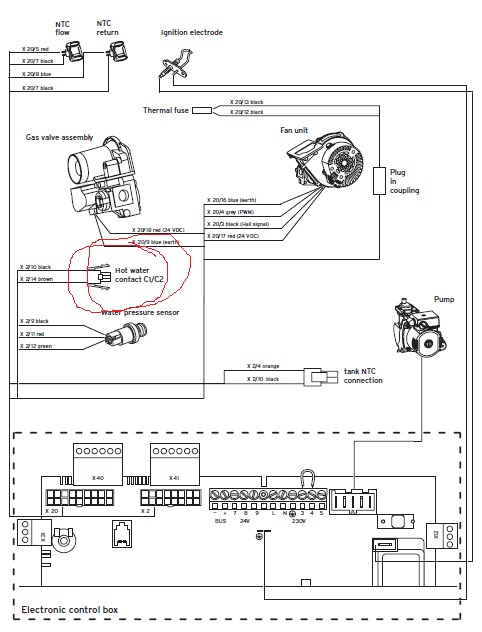

Reeealllly? I will try that today, 100%. If it works it will save me 70 quid + 20W running all the time.
