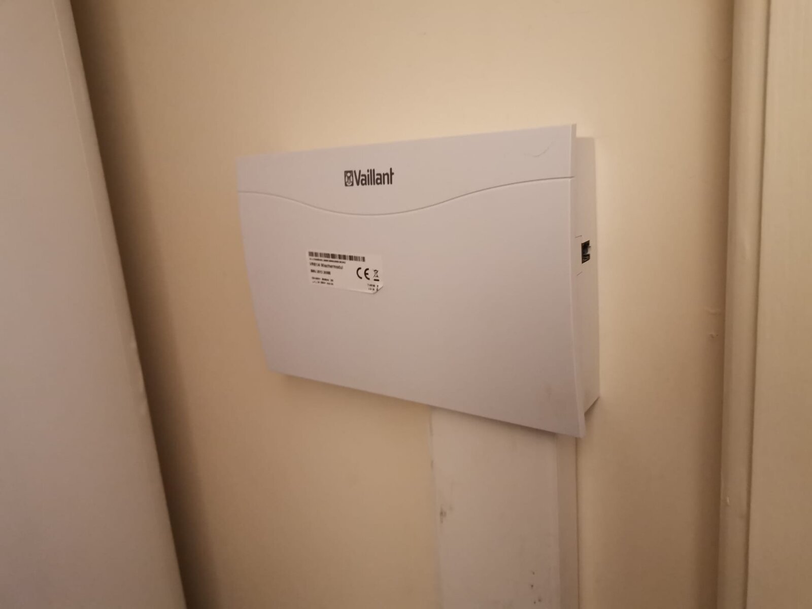

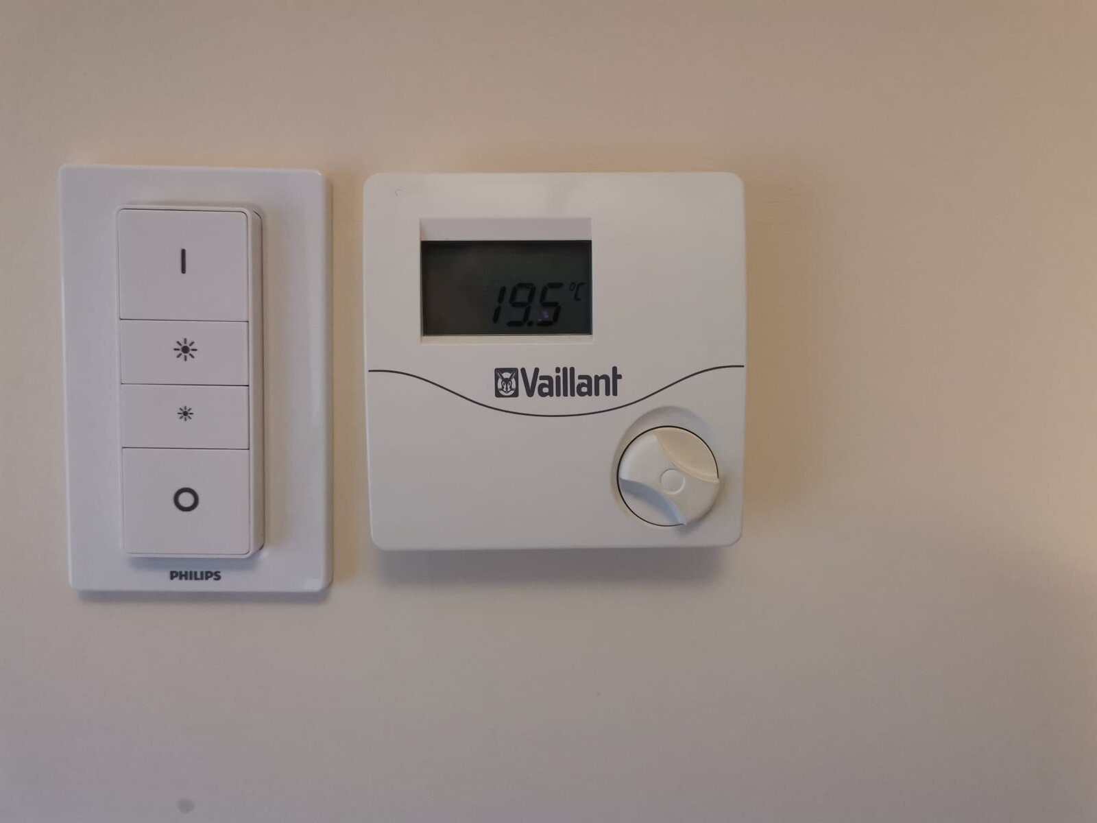

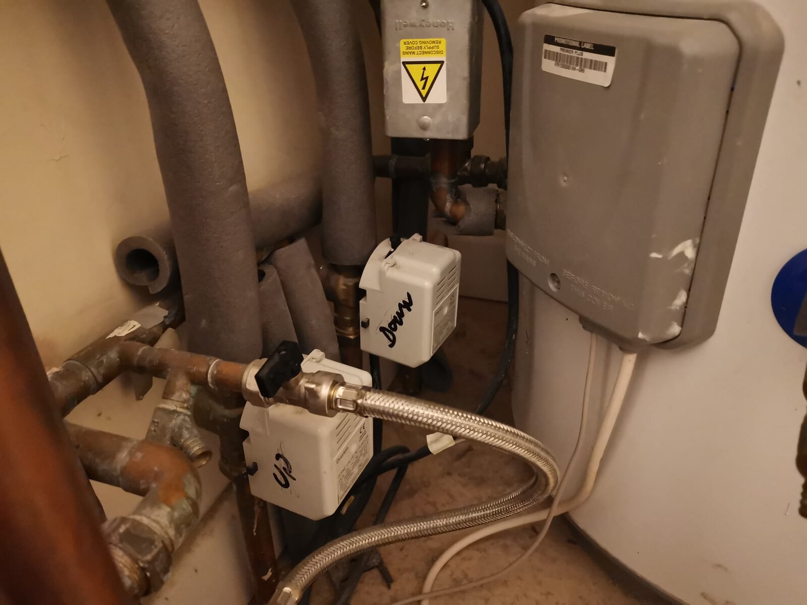

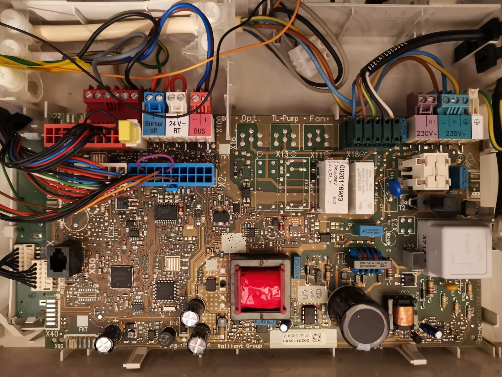

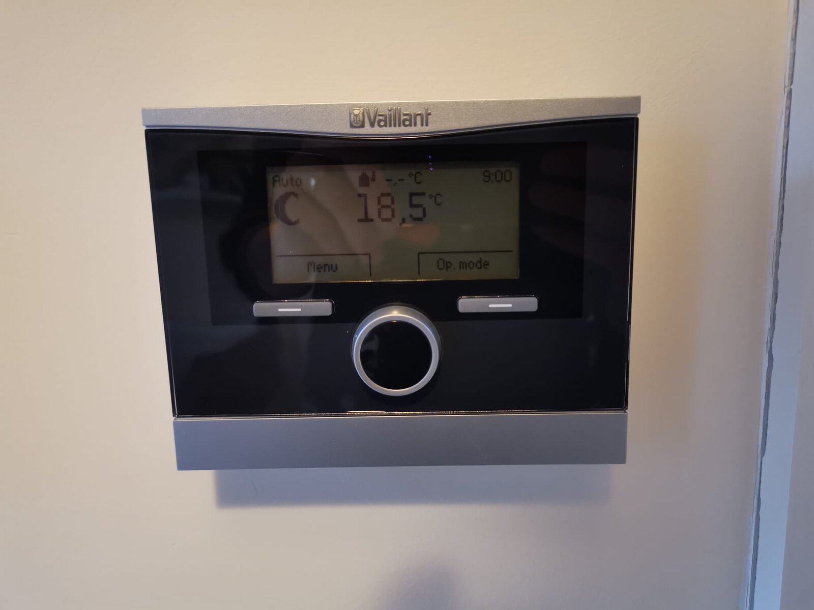

I have a Vaillant Ecotec plus 612 (heating and hot water tank) boiler which is on a 2 zone (upstairs/downstairs) configuration. There is a main thermostat/controller downstairs and a secondary thermostat upstairs and a VR65 mixer controller next to the hot water tank. There is also 2 valves next to the tank that work for the zone temp. There is also an outdoor mounted weather compensator.
I want to install a nest 3rd gen in place of my primary controller and a nest thermostat E in place of my secondary thermostat. I have attached picture of the boiler circuit board, vr65, both thermostats and the valve. Any advice on where to wire into will be greatly appreciated.

I haven’t dealt with the Vaillant wiring center beforehand, but you’re going to need to decommission the whole eBus side, and connect certain parts to the 230vac side. Also that 24v link will need to be removed. However I should point out the boiler case forms part of the combustion circuit and needs be checked afterwards, you’re also working on what looks like an unvented cylinder, which you may need to be G3 registered. What I don’t understand is, why you want to swap out Vaillant modulation controls, for basic on/off switching? (n)

When I've been asked to look at something like this in the past, I usually find (unless the thermostat is actually faulty) that this symptom is a result of either bad plumbing design / installation, or the thermostats have been installed in the wrong places. All thermostats regardless of make simply sense the air temperature in the area in which they are located and open the zone valve to which they are connected when the heating is required and close the valve when it's not.

It's definitely bad design, when it was first installed, they had wired the valves up to the opposite thermostat, so down stairs stat was controlling upstairs valve etc.

You would be ill advised to replace that set up with nest,you are going backwards not forwards
Thanks, would you be able to explain a bit more as to why this would be a backwards step? What should my Vaillant system be offering that Nest can't?

The nest is wired directly to the zone valves, with HW ON wired to the VR65/66 to instruct it to boost the flow temp to 80 degrees when heating the cylinder.
