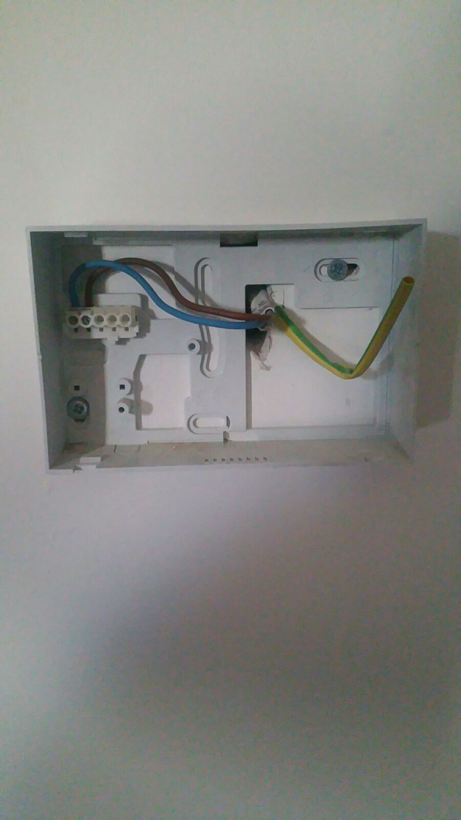

Your boiler is wired up using Vaillant's proprietary controls. They operate over ebus and the vaillant thermostat directly controls the boiler. This is why terminals 3 and 4 on the boiler are joined together. In a traditional system, your thermostat would control the boiler SL to operate it.
Does your CH have a motorised valve? If so, you probably have a Vaillant control panel (VR65) to operate it. If you remove this, you will need to ensure the Nest is wired through the motorised valve to operate it, and the valve would activate the SL on the boiler. (Edit - saw it's a combi, and therefore will probably not have an external valve - the boiler has an internal diverter valve).
Nest gen 3 supports opentherm and this would work best with your boiler. You need an additional vaillant opentherm module to use this, though. IMO, the nest working with on/off control is perhaps a retrograde step compared to the Vaillant thermostat you have currently.
Just to add - Dan is very knowledgeable in this area and genuinely helpful with his contributions. Fact is, you have showed a complete lack of understanding of even the basics of this installation, and so for your own benefit, I think his advice is spot on. You're best off getting a professional in if you really insist on having the Nest fitted.
According to you, I may show complete lack of understanding of basics of this installation but one thing you can't take away from me or deny is I have the tenacity to learn and I went as far as showing this by stating what goes where
I'm not sure you've read Dan's post properly. It's actually very descriptive given it's an illustration! The wires going to your Vaillant thermostat are low voltage ebus connections, not L(ive) and N(eutral). They can be disconnected from your boiler's ebus terminals and used in T1 and T2 to power your nest thermostat.
The heatlink will be positioned near to the boiler with terminals 2 and 3 being connected to the boiler's terminals 3 and 4.
The heatlink L and N should be connected to a fused spur, not directly to the boiler.

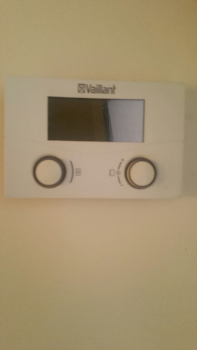

Can someone clarify which Vaillant control unit that is in the picture and is it powered via ebus or does it require mains power with wifi comms?
They are actually Brown and Blue like in the picture and not the black and grey on the boiler attached to the ebus... please see pictures.
First thing you should do is put a multimeter to them and see what voltage is across them.
More than likely they are going into a wiring box somewhere, which is why the colours do not match.
