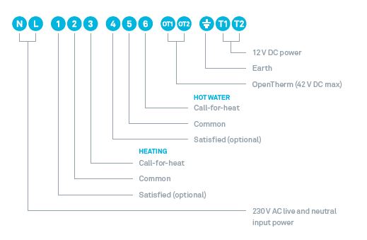

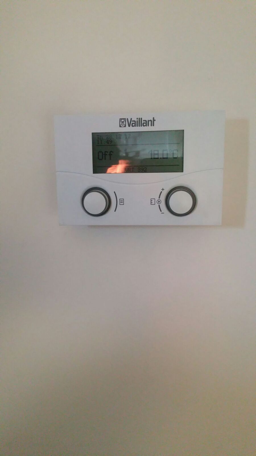

Thanks Jackthom. apologies if I didn't make myself clear enough in my original message. I do know what a thermostat does and how it works. Please see attached my vaillant thermostat.
The issue is that the Nest manual doesn't cater for exact connection which the Vaillant ecotec Plus 831 has. As you can see from the Nest manual, 1 & 2 must go into the boiler which my boiler doesn't have. And 6 which is for hot water - again my boiler hasn't got.
I believe the following should be the case but I'm not entirely sure hence my question:
I think I would need to remove the link (red) 3 and 4 on my boiler
Then connect Boiler 3 to Heat Link 2
And Boiler 4 to Heat Link 3
and of course, connect the Live and Neutral from boiler to Heat Link.
T1 and T2 isn't available on my boiler which I think is for controlling the boiler on a low voltage should I not want to use the frequency from Nest (?)

You are correct about the connections required between boiler and Heatlink.
Sorry I failed earlier to spot the two wires, grey & black, in the boiler "bus" terminals.
You already have a Vaillant ebus thermostat connected and will have to remove those two wires to let the Nest have full control of the heating.

Thanks again, jackthom.
Just to summarise:
1) Remove the grey and black wires from bus terminals
2) Remove red jumper wire from 3 to 4 in boiler
3) Connect L & N from boiler to Heat Link
4) Connect Boiler 3 to Heat Link 2
5) Connect Boiler 4 to Heat Link 3
6) Replace the Valliant thermostat on the wall with the Nest thermostat using the two wires in the wall
Hoping the above will be sufficient to power the boiler, control heating and hot water? As i
What do I do with T1 and T2?
could you possibly explain how hot water will be powered and control with the above connection. Still at a loss here.
Thanks for your reply
1 to 5 are OK
6) You can power the Nest directly using the 'usb' lead power adaptor. No need for T1 & T2 to be connected if not required.
If the Grey and Black wires do go all the way from the boiler to the wall thermostat directly you could use them to carry the power using T1 & T2, provided there is enough spare cable at the boiler end to reach the heatlink.
As for hot water, it's a combi and only provides hot water when you open a hot tap. There's just no need for any other timing control from the Nest.
