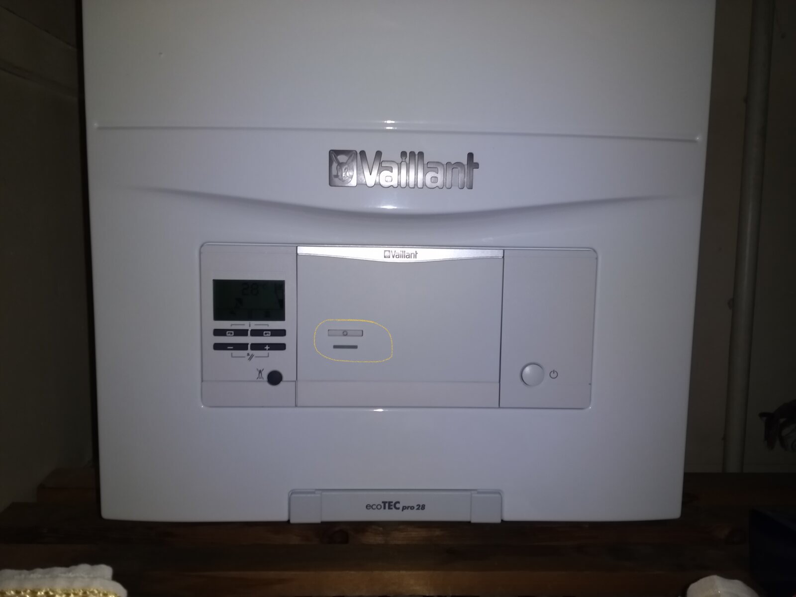

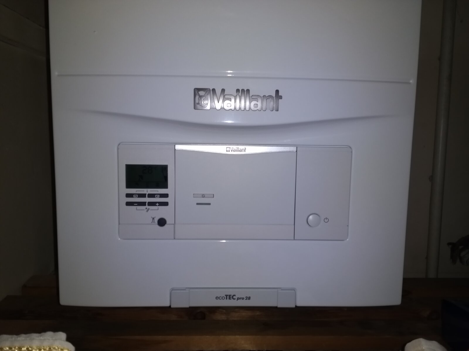

Ok, firstly - no need to remove the boiler cover. The receiver for the wireless unit might be the plug-in type on the front of the boiler. Can you post a photo of the front of the boiler?
This is the boiler Chris

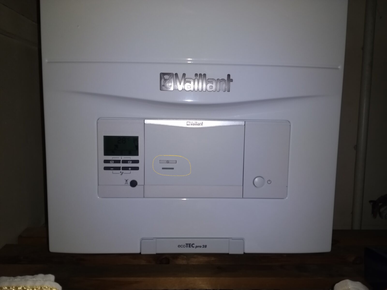

Ok, I have edited your photo, circled hello is the bottom and led which I refer to. It appears that the led isn’t lit, is this correct?

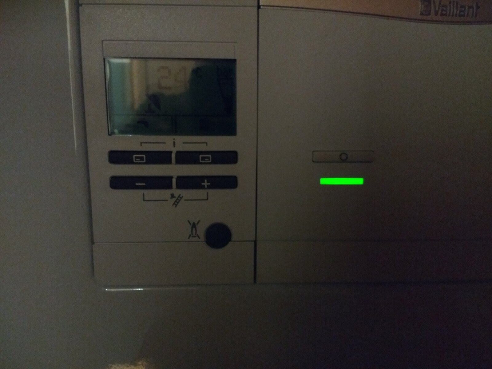

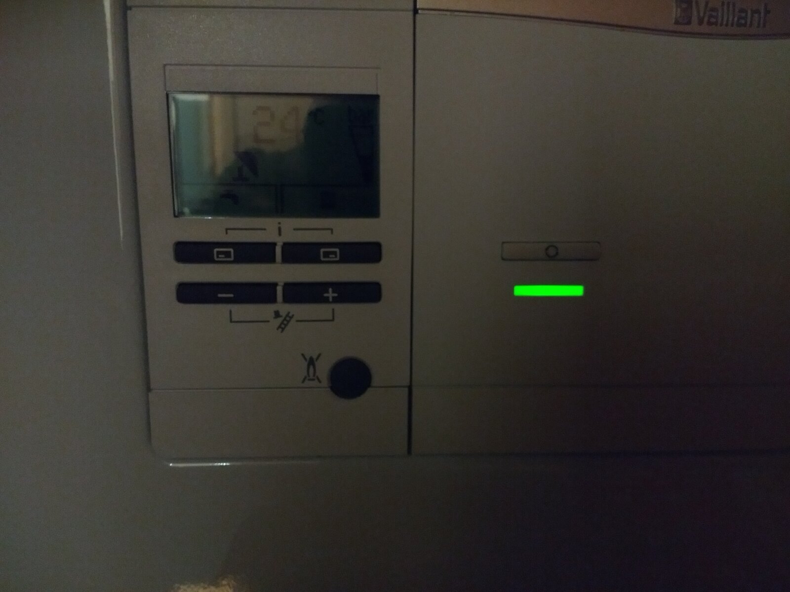

Chris, please find better photos, one taken with flash & one without so led green light shows up.

Chris, do you know the normal procedure/sequence of linking the boiler and stat? Is it a case of turning boiler off at electric fuse point for 3 minutes and taking batteries out of stat and then turning boiler back on and putting batteries back in etc?
If the green light is on solid, then it’s already paired up. Take it out if summer mode, and set the boiler temp to at least 62 degrees. Set room thermostat higher than the current room temperature, and let me know if the boiler fires.
the green light is solid but the stat was not showing anything, it was basically blank compared to before removing batteries.

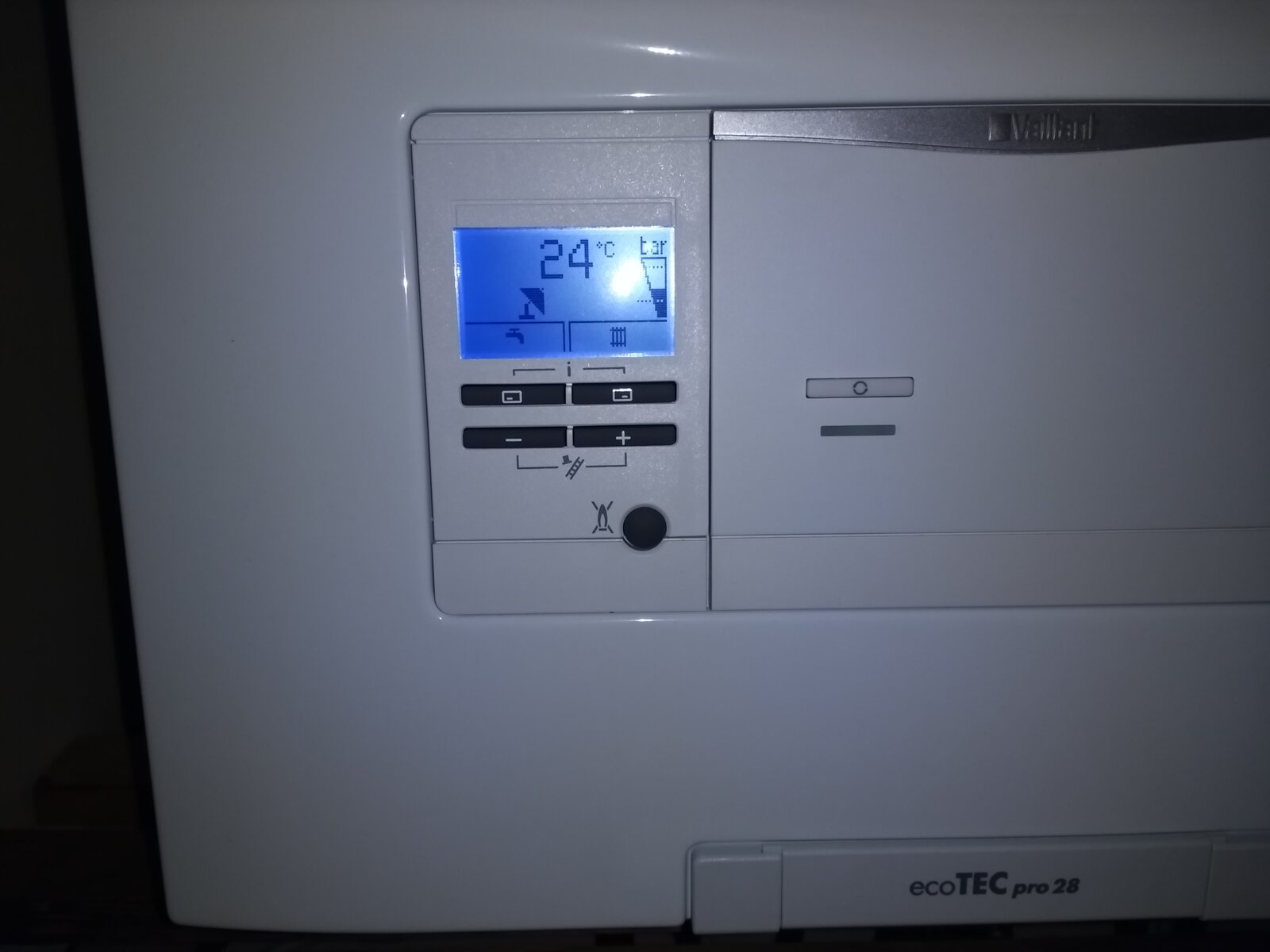

I have taken batteries back out and then re inserted them and at last are getting the different options showing.
Stupidly I pressed the ignition button on the boiler and fired it up so will wait until it goes off and then turn the 'desired temp' up again to see if it fires up.
What setting/mode do i need it on so i can operate it manually rather than have set times etc.
Also the display on the thermostat used to go out........now it is staying on all the time!
