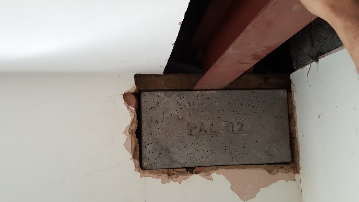

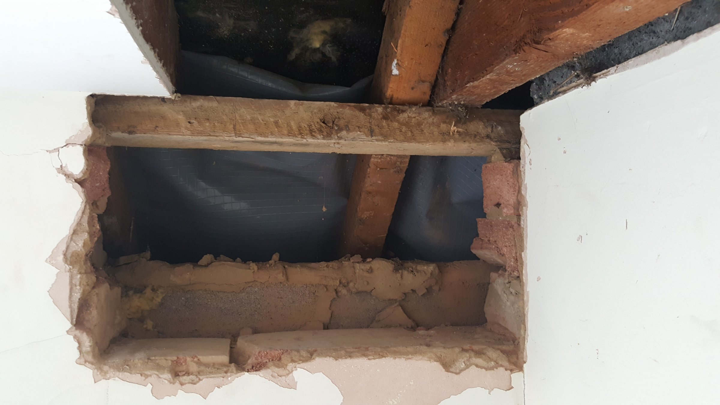

I'm removing a chimney stack in an upstairs bedroom, so I'm installing an rsj and some trimmer beams to support the stack. Doing my planning I thought the wall plate was on the outer skin of our cavity wall but it's not it's about 30mm back from the inner face of the inner skin.
My question is, can i cut a small section out of the wall plate to site my rsj?
Thanks in advance
Brian

The section I've opened is to fit a padstone as stated by my SE. The steel will be running behind me out of the hole in the picture if that makes sense. I think I can get the padstone in with the plate sat on the top of the stone and just cut a 10mm section out of the timber plate for the upright of the rsj.
Does that make sense?
Effectively the plate would run both sides of the steel up to the centre.

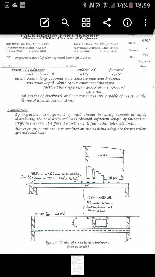

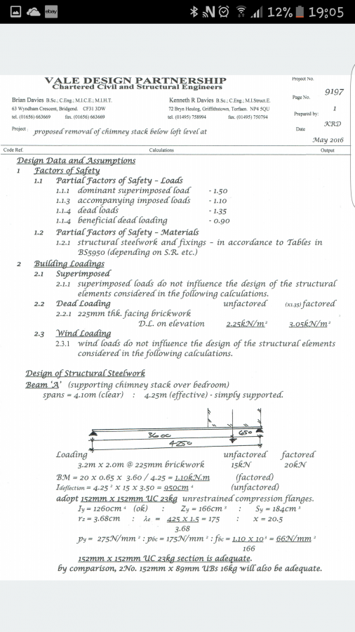

Have you submitted a plan and calcs to BCO, and has he visited the site?

I have now submitted a plan and calculations but when i was looking at the layout from the loft I thought i could see the plate sat on the outer skin. My error.

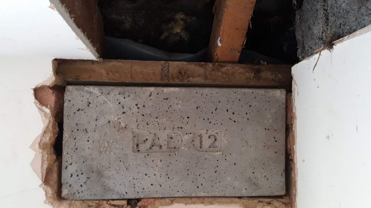

I'll attach another photo making it clearer what I'm asking.
So the steel going in is wider as it's 152 x 152 but you get the idea.
I want to cut out the hatched section on the timber plate to feed the steel toward the outer wall.

Can you post the plan that was submitted to BCO?

Note: that at the moment you have a bearing of approx. 40mm - that wont work in my book.
I know, that's why im asking can i cut the plate? Then the steel will go back the further to match with the plan.
You obviously dont know:
Above you claimed a 30mm bearing on brick, and a proposed 10mm notch out of the wall plate (40mm) - nothing was indicated about notching deeper than 10mm.
I haven't viewed your plan so how can I comment on it?
Sorry it's hard to explain not being a professional builder.
What i mean is cut right through the plate removing a 10mm section? So the rsj can go further into the wall to achieve the correct bearing?
You just cut out the wallplate as necessary. No problem. The corner of the beam may need to be cut off to match the roof line..
