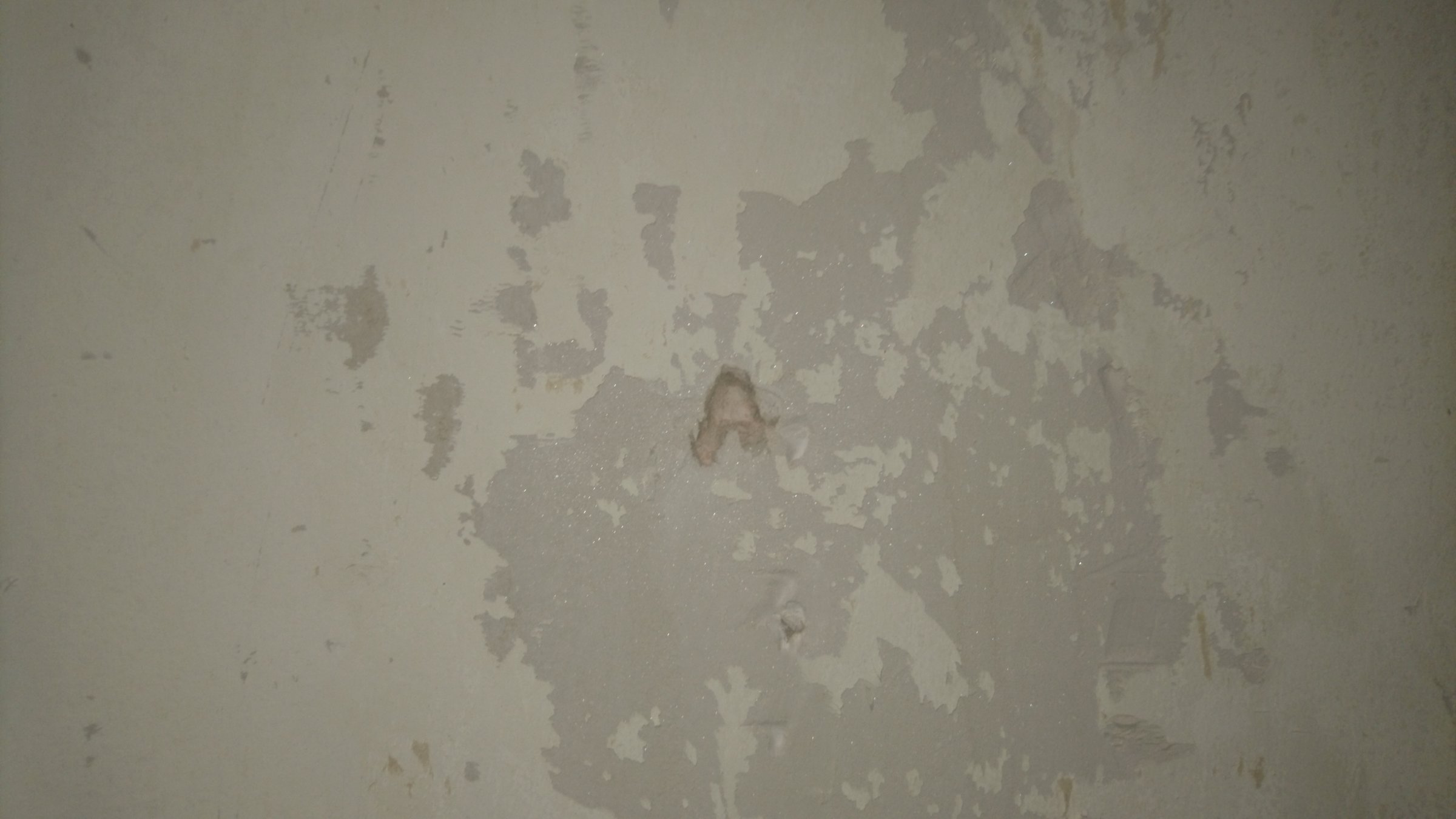

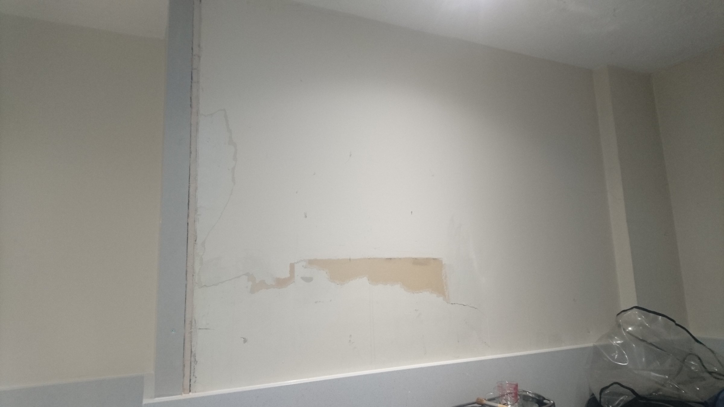

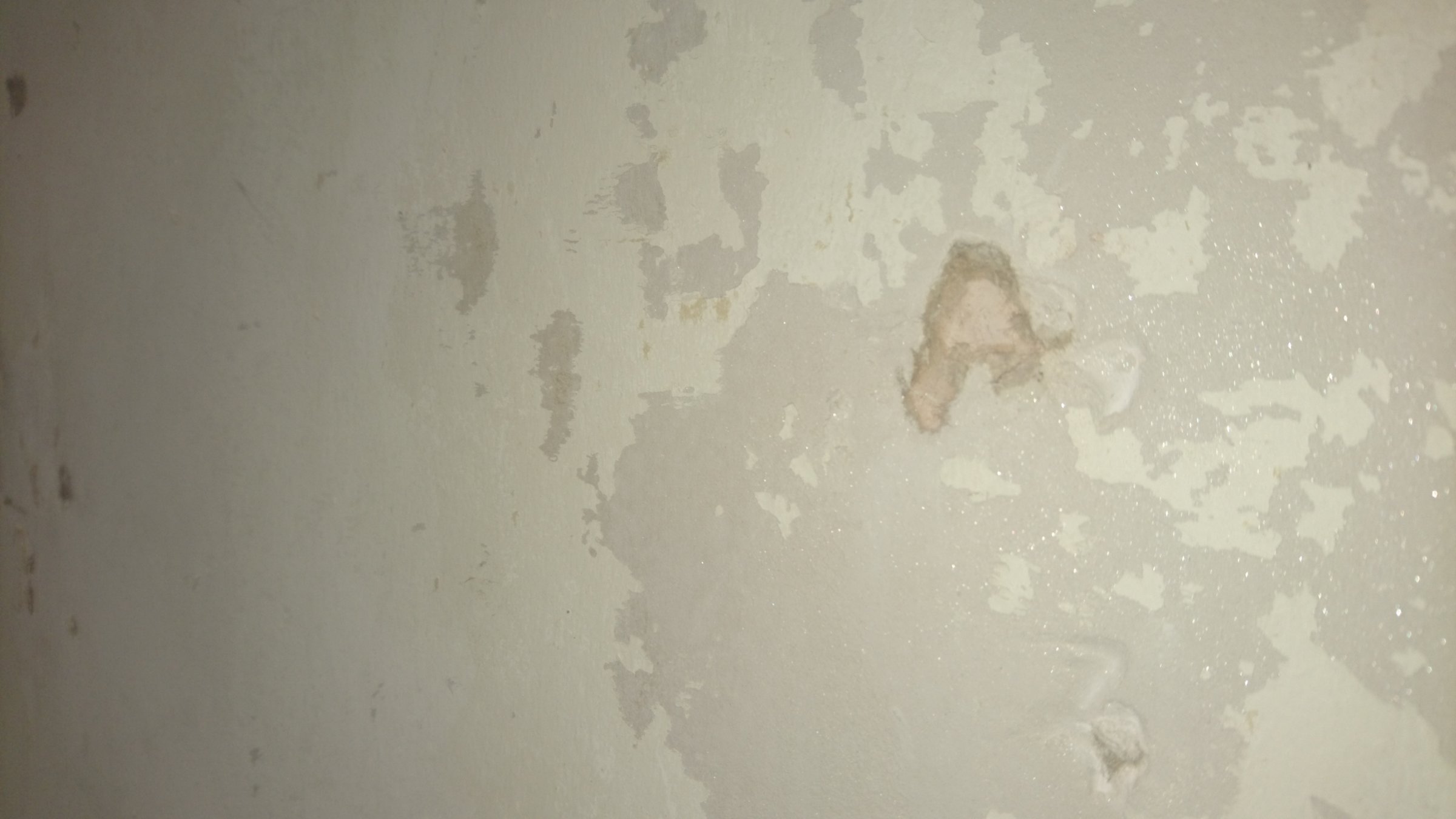

Ive only just got round to stripping the wall and heres how it looks
The paper came off pretty good but in some places its taken the paint with it leaving a few areas of exposed plaster and the rest is flaky paint.
What were those additional steps that id need to take to prep the wall for skimming?
