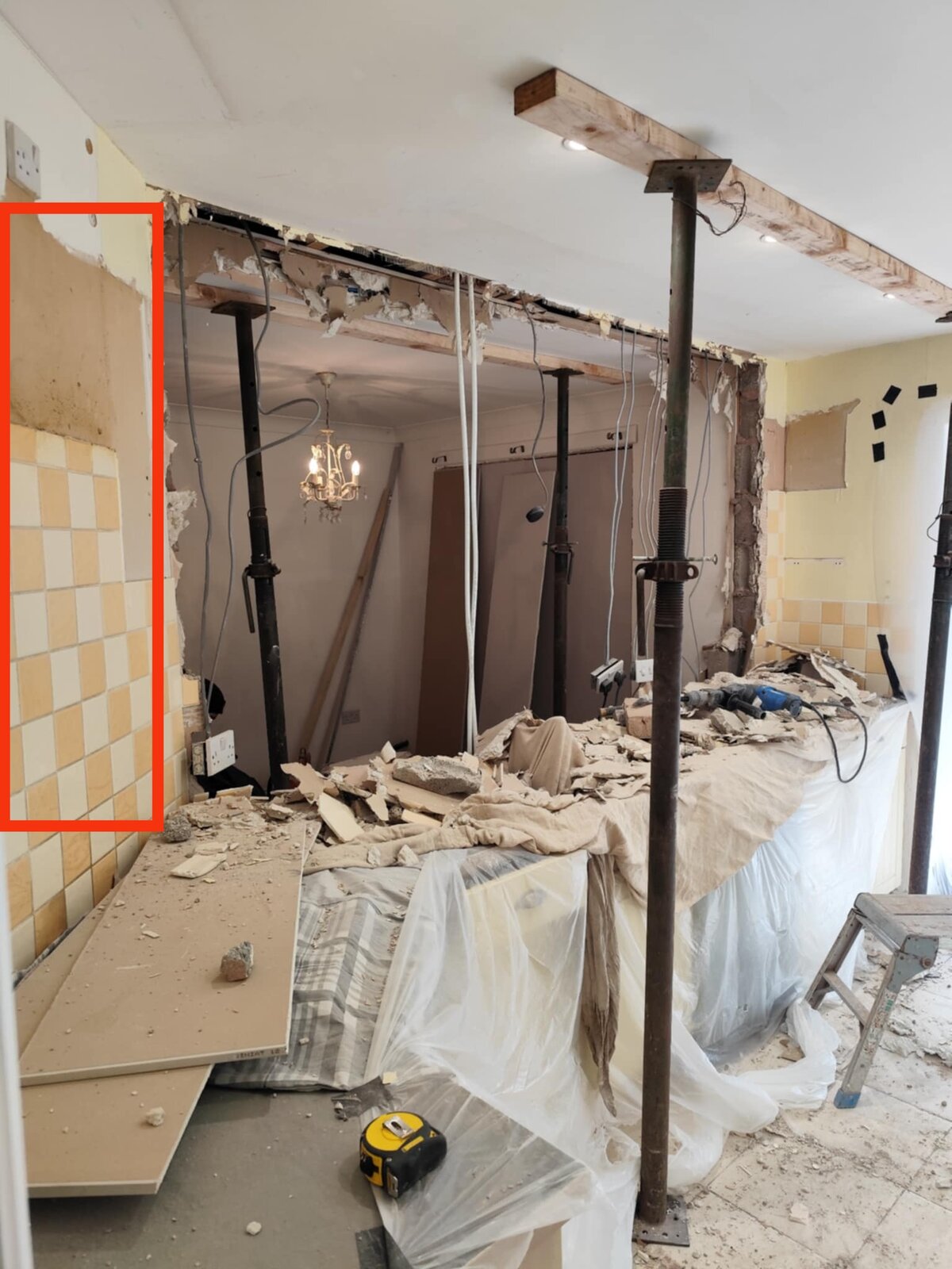

Hi, I just had removed internal bearing wall and installed steel beam. Just I'm not sure if brick wall will be strong enough to hold it because beam sitting on one brick pile which 20cm deap. I have attached pictures how much of brick wall I have. Do I need to enforcement for that wall or it's fine.

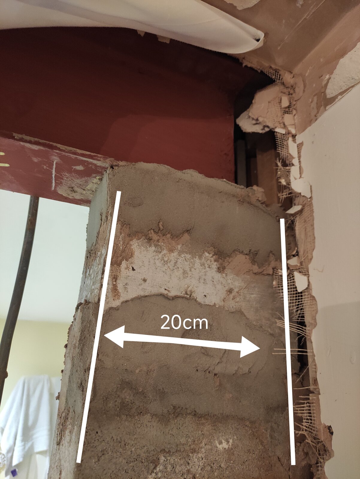

That should be fine, most steels require a minimum 150mm bearing, you've got another 50mm on that so nothing to worry about.

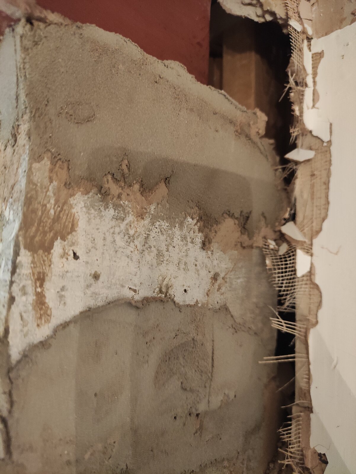

I mean steel beam sitting on brick 15cm . But wall only 20cm wide of one pile of bricks. Do you think that wall stable enough to hold that ? Many thanks

I didn't get one. Builder who took down the wall told me I don't need. He told me it's fine like that. But I'm not sure if that small part of brick are stable enough to hold or it's have to be fully removed brick wall and instead install steel support.

you need structural calculations and building regs to do that
how do you know the wall isnt supporting the roof or providing lateral stability for the house?
what is the wall bearing on at the bottom
all those questions require a S/E to decide

I mean how wide is the actual wall its sitting on?
if you are meaning its effectively a 200mm wide free standing wall, then no thats no good

Can you take a photo from the other side of the opening as that nib is probably part of a wall rather than just a 200mm column on its own.

Yea the wall it's just 200 mm wide and behind doesn't have anything.
That means I need call structural engineer and rebuild that wall?

Do you know the height of the padstone? Looks like it's been packed top and bottom with mortar
From another side it's have wall builded 45° angle
but it's just timber and plaster board wall I have marked in red. Picture was taken before steel beam was installed.
Do you know how that single brick column can be enforced in this case?

I'm seeing 1 acrow squint and others sitting on a tiled floor and only 4 used not good I fear. Is the pier new work? If so how is it bonded to existing:

You need to stop the work and get it checked by an SE and signed off by Building Control. As well as the beam, the padstones and the bearing piers, the beam itself needs to be encased in (fire) protective material.
