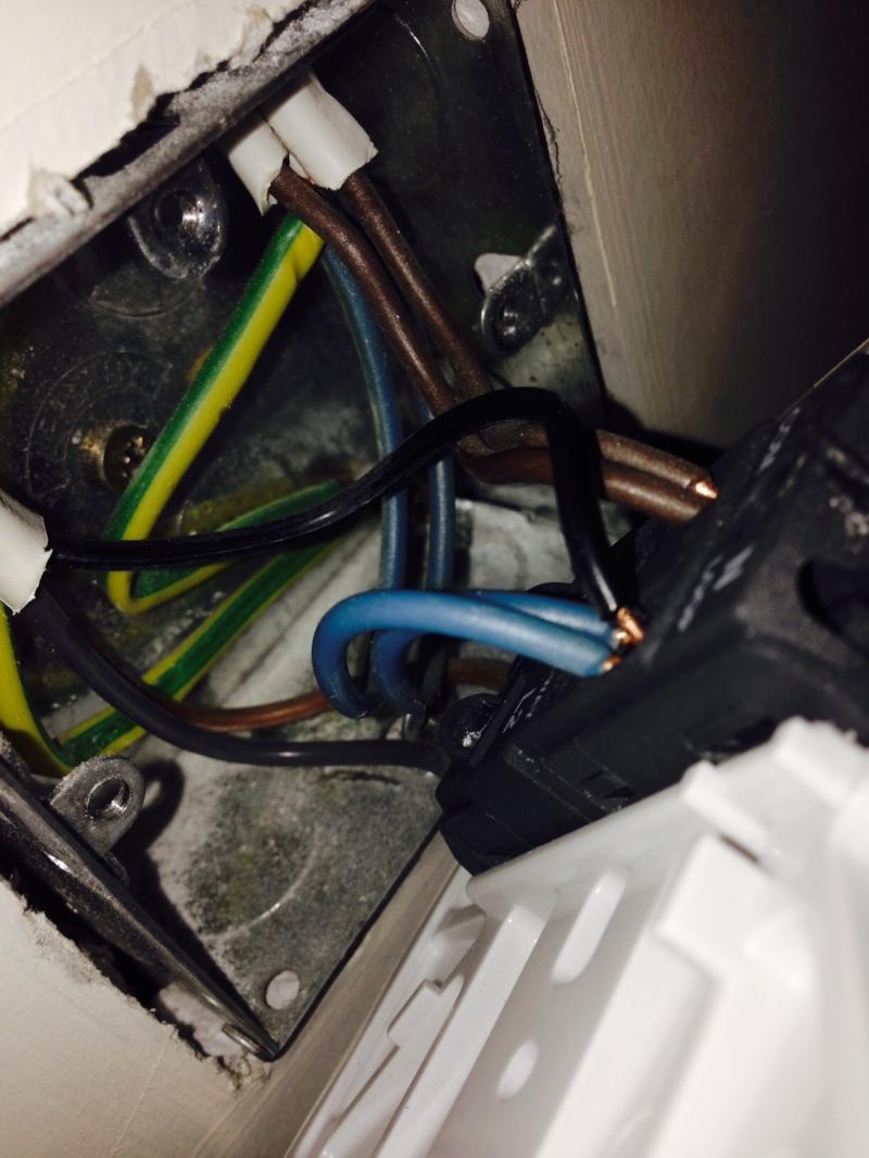

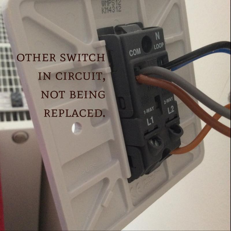

It looks like your three core and earth carries two strappers and a neutral.
In the switch you are replacing:
- Put the cores from the N LOOP into a terminal block, not to your switch.
- Put the two browns from the COM into the LIVE on the timer switch.
- Put the brown from the L1 into the L1(2way) on the timer switch.
- Put the black from the L2 into the LOAD on the timer switch.
And then......
In the other switch your retaining:
- Move the black from the L1 into the COM with the other cable.
- If you find this switch operates upside down, either turn it around or move the brown from L2 to L1.

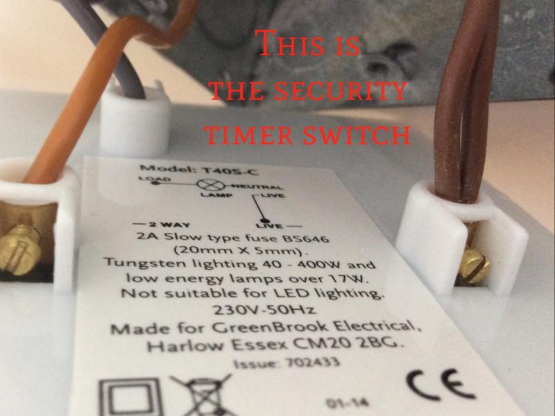

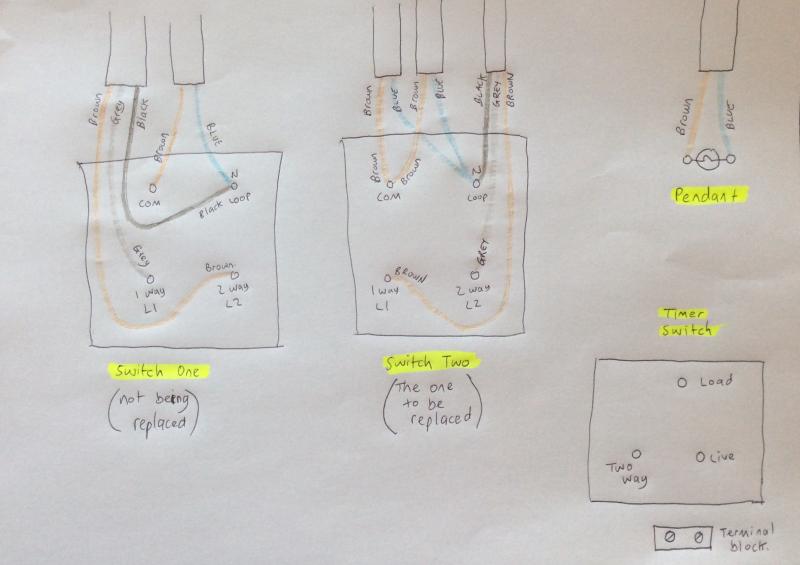

OK, Martin, first I'd like to apologise for the grey appearing as black to me in the light. I'll try to update my picture below for clarification.
Second, I tried your suggestion, but the light is not coming on. There is definitely power getting to the new switch though, because the times are flashing. The circuit has not tripped either.
I'll attempt to post pictures here again (of what I have done followed by a better illustration of what cables are going where).
(apologies to those who seem to be offended by me asking for help and not posting my own pictures, but praise to Martin and John who seem to have a helpful nature).
Looks OK to me.
Are the neutrals in a terminal block together at the timer switch?
Does your pendent have a lamp in it, and is it more than 40watt if a standard lamp, or 17watt if it's an energy saver?

1. Yes, the neutrals are in a together.
2. The bulb was a 20W energy saver, but as it was a cheapy one, I've just replaced it with a 100W, but now it remains on (even after switching both switches).
Any ideas?
Just to be clear - are you saying that the 20W energy saving lamp would not come on at all (regardless of what you did with switches) but that when you changed it to a 100W lamp it will not go off (regardless of what you do to the swiches)?
