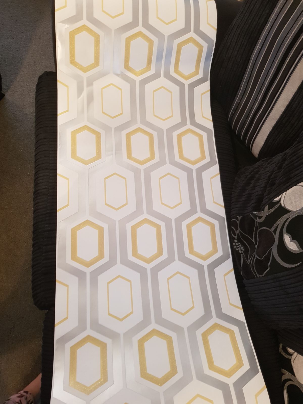

So I'm wallpapering this weekend.

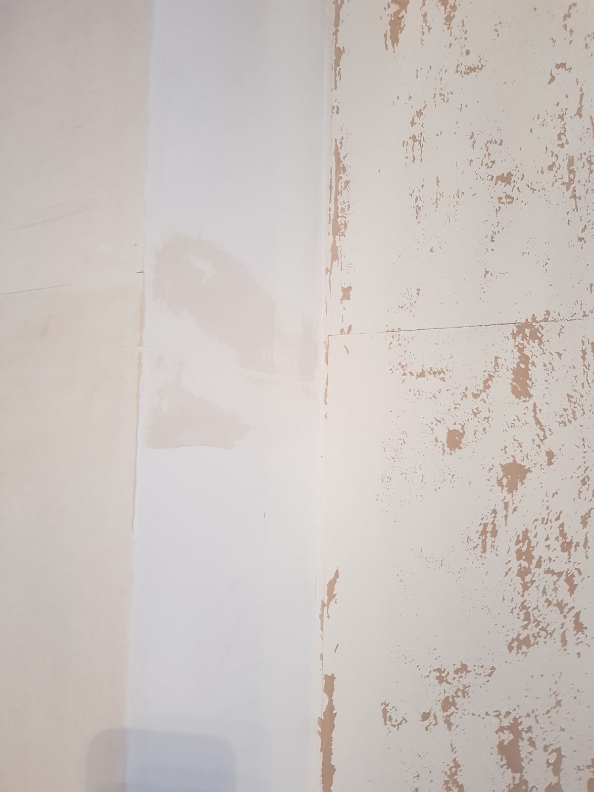

This is the corner hurting my head, what's the best method?
The first corner is not even at the top, out by around 2 cm.

If it's out at the top, then you've just got to decide at which point you want to match the pattern back in. You'll take the pattern into the corner, and then match it up from there. it'll be out either at the top, or the bottom, but it's best to se where you're eye falls, and then work from that point.
Level up the paper facing the room, overlap the corner by about 10/ 15mm and Make adjustments to the Pattern on the return.

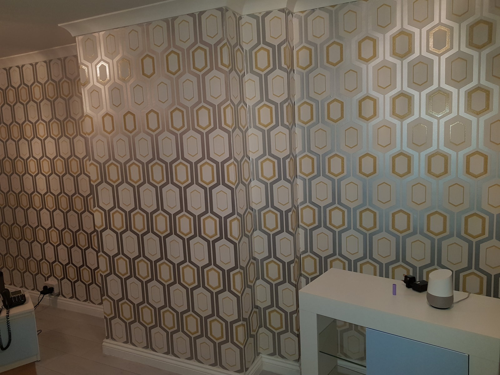

cheers for the help guys,
Got it all done, worst corner was out by about 15mm. Just done my best to match up as close as possible. The OH was happy enough but would have liked it perfect. Will just need to furnish and decor around the imperfections.
This is the finished result.
I'm happy enough, but next time I think I will get someone in to straighten up the corners better.
