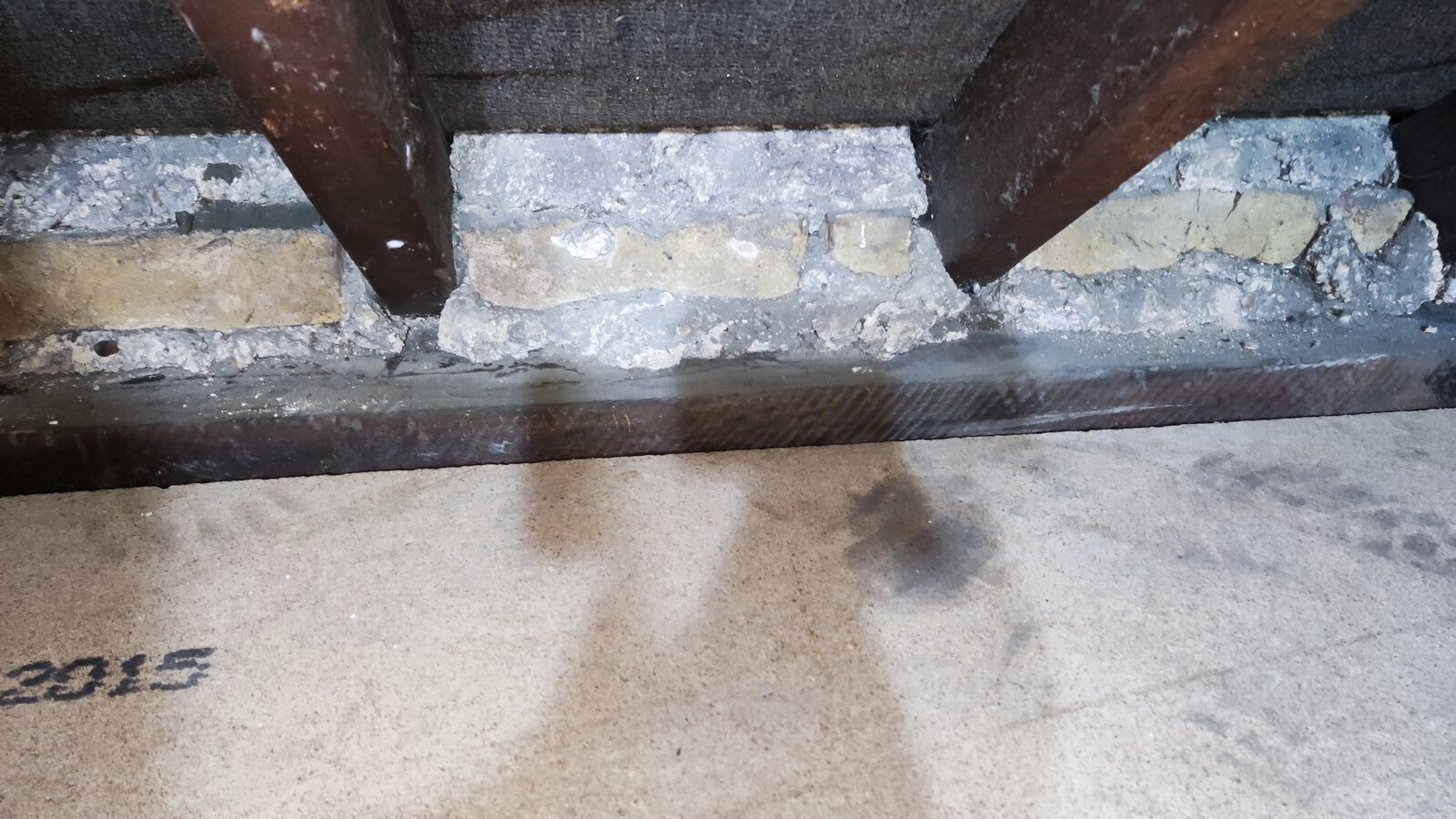

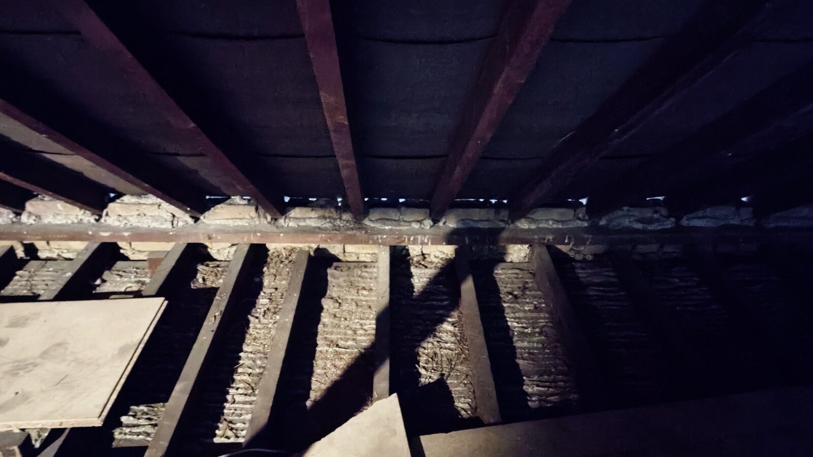

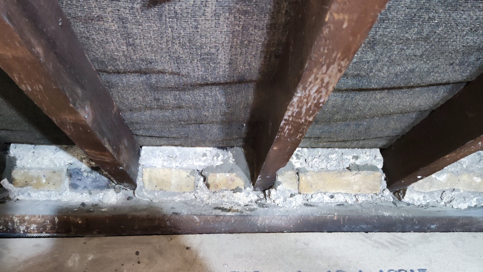

My property is old vicotiran house in a London borough built in 1889.
The loft has a course of brickwork laid on the wall plates and appear to have been stuck down with lime mortar.
The bricks are moving and the mortar is crumbling and lots of gaps appear everywhere.
It is obvious the mortar was not designed to hold the bricks down onto timber wallplate.
There is no external soffit installed and these bricks could easily fall outside.
Not sure how to secure this and fill gaps.
I am tempted to go over the existing mortar gaps with someting like Bostik Rapid Setting Cement is that a viable option?
Are there such things as straps I can tie bricks to wallplate?
Any advise much appreciated.
Photos attached.

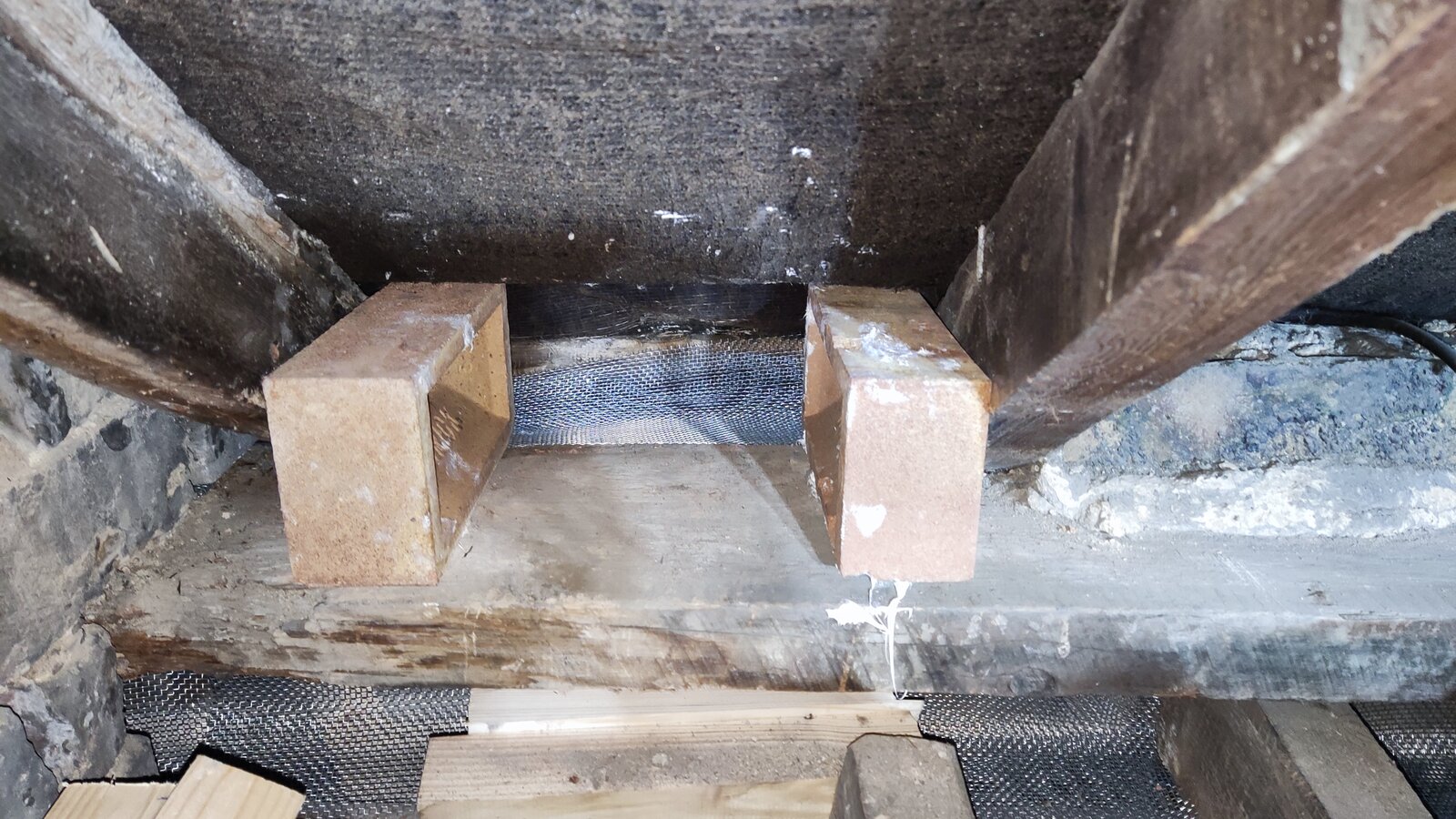

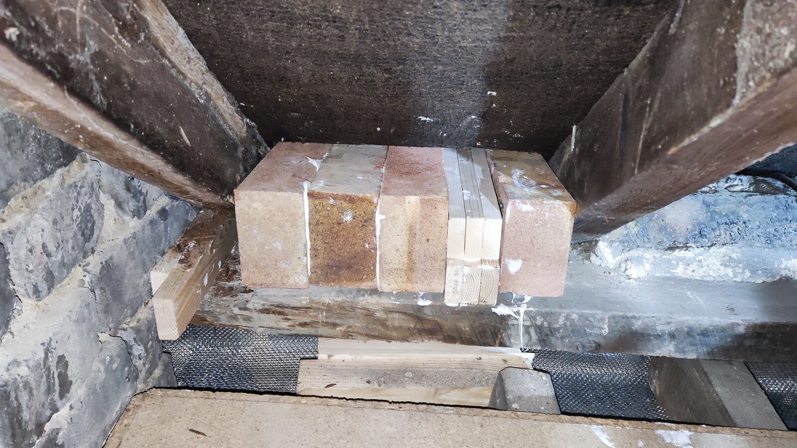

BTW, in one area the brick was completey coming away so I installed a new soldier course to close the height and adding some mesh in lieu of a proper soffit which I don't have. Bricks were glued to the wall plate using hybrid polymer Dura+ and these mesh is just friction fit against rafters and the fascia

Not sure I'd bother doing anything, if those bricks have not 'fallen out' since 1889, there's a good chance they won't by 2089.
You don't want to block up what bit of ventilation there is currently, your new soldier course bricks look to be touching the felt, I wouldn't repeat this process for the remaining rafters.
The bricks are infill to block up the gaps, on the whole, it looks dry up there.(y) but the rafter where your soldier course looks a little damp, prod with a nail, is it soft?
Totally agree in regards to ventilation. I'm going to secure the bricks somehow because I am paranoid, it doesnt take much to push them over. And perhaps mesh over the holes to prevent birds and mice from intruding. Many thanks for taking time to respond.
Ah, yes there are telltale signs of a prior leak and rainwater damp course along the the parition wall and nearby rafters it looks like it'd been patched up long before I arrived (2007). The sarking felt is in good nick looks like it was put in around 2004/5.
