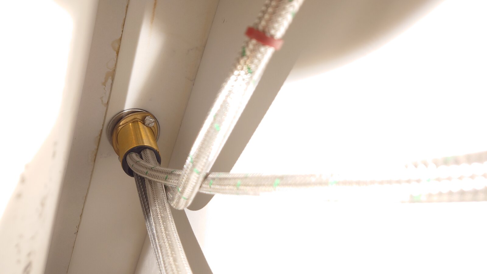

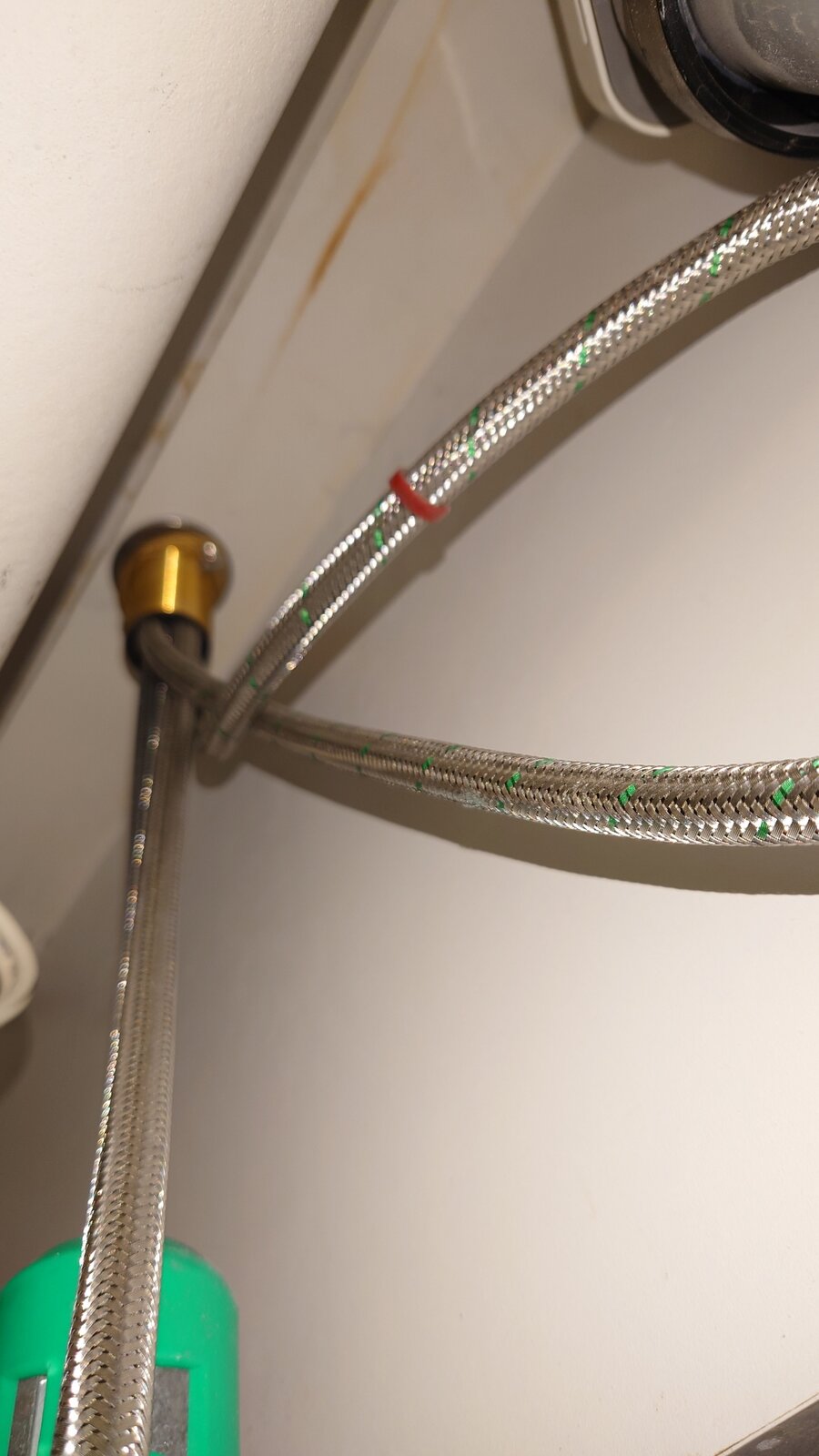

Here are some shots...
Here's a quick video to help see it all at once. Sorry about it being sideways, I couldn't convert the video to get it to stand upright.
All relatively straightforward. Turn off the water valves and loosen those flexi's (3/8"). The small bolt in the big nut under the tap loosens and that then releases the big nut to be unscrewed. Old tap removed.
new tap should be a reverse with the big hut, may not have a small nut to lock the big nut but that's not an issue. Trouble may be with the new flexi pipes and whether they are 3/8" or 1/2" female ends, if they are the former then fine, if the latter then you'll need 3/8" female to 1/2" male adapters (with either rubber seals or PTFE tape) for the valves. or swap the valves for 1/2" ones.

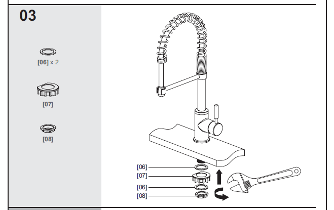

Don't know what plastic part you think is used to screw into the bottom of the tap to secure it to the sink as those parts are usually metal.
From the manual, I'm referring to these parts... 6, 7, and 8. We were convinced we had kept those all these years and they're nowhere to be found.
6 - will be sealing washers 7- looks like a spacer/support 8 - is the locking/securing nut.
They are all needed, so if you don't have them then all you can do is go to the manufacturer, if known, and ask if they can supply them. You could try the nut from the old tap and see if that fits, they are sometime the same size.
