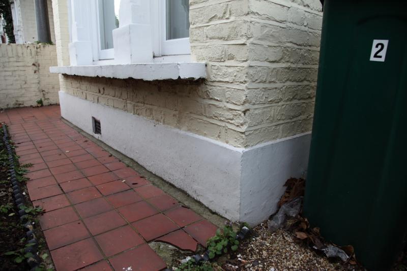

After the great posts above I've read a bit more about the 'rising damp' thing. I am wondering if my damp issue in the front rooms is caused by a concrete skirting around the front of the house. I need to check but it might be bridging the damp course. Maybe I can take some snaps and post them here. Any advise for what to look for would be helpful. There is also a concrete path running down the side of the house.

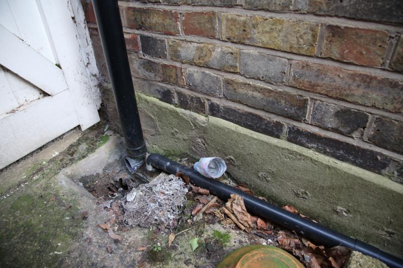

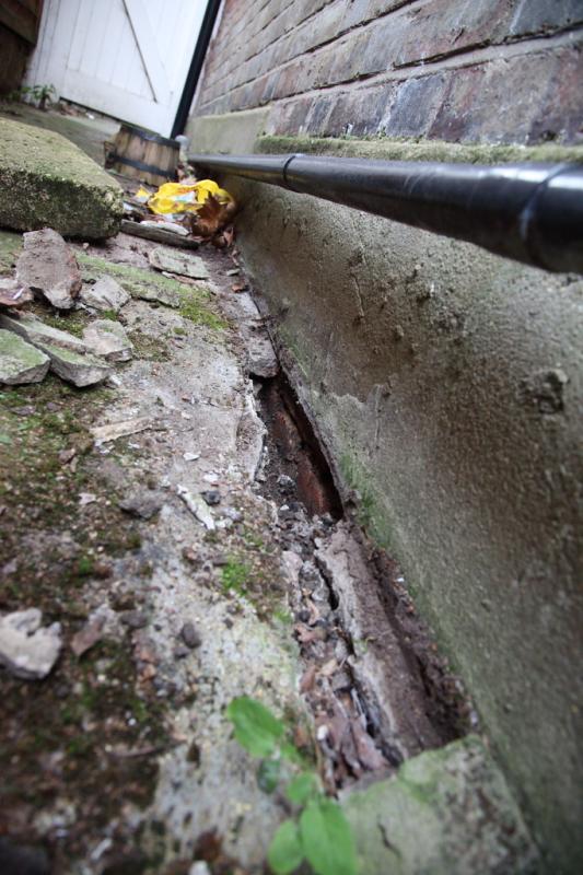

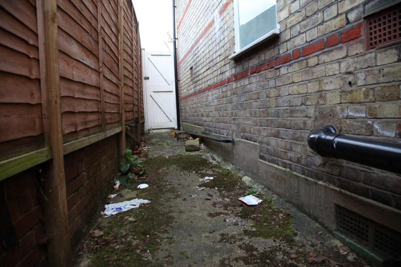

Here are a few images: If anyone can shed any light on if there is a potential cause of the damp it would be great. I'm thinking that the water is getting between the skirting and path.
Side of house, this the wall that's damp. Pretty much from the corner, towards the window. There is an incline towards the gate.
There is a drain in the corner which takes the bathroom sink & bath waste. Sure this isn't how your supposed to do things. The bathroom waste pipe will be removed when renovated
This is the front bay, with concrete skirting

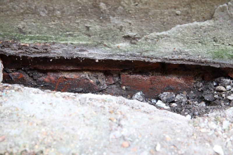

The join was cracked between the concrete path and skirting, I removed a bit and you can see the brick and soil. Is this an issue?
