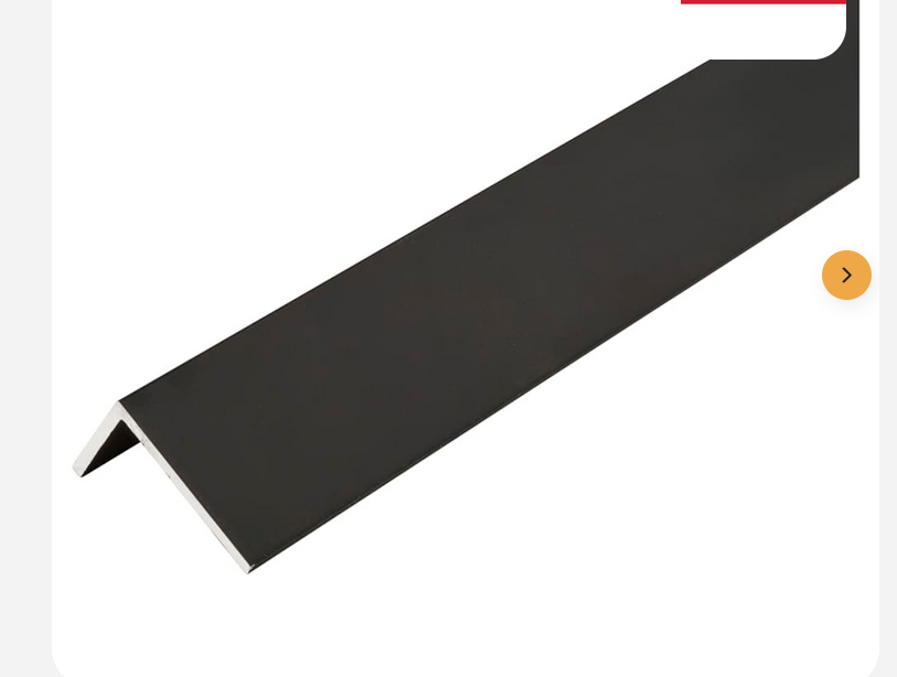

I thought about putting some bracing on the back of the door, maybe some lengths of solid wood, glued and screwed to whatever sheet material i end up using.
i also thought of using something like this on the edges and wrapped around the back of the door to maybe add some rigidity to it, Thought's anyone ?

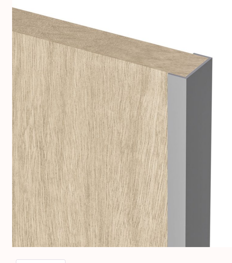

Also looked at "C" profile like this, but obviously this means having some of the profile trim on show on the front of the Sheet material, which i was trying to avoid. " C" profile would give greater rigidity though !!

I think timber would take up too much depth, your C channel is the best idea for rigidity as for protruding onto the face you could just get C channel the same thickness as your door and rebate it so the channel sits flush. Alternatively, a T channel might work if you router out the back of the door to inset it. If you don’t have the tools, you can always find a local joiner to supply the doors cut to size and rebated to suit. (they could also have a finishing department to get them factory sealed as well)
