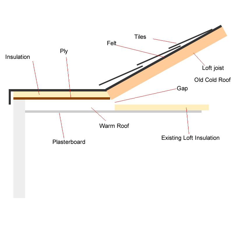

Hi All,
I hope this is the right place, I have recently had some building work done but am perplexed by what has been left on the join between the new flat warm roof, and original pitched roof (cold?)
I have done a sketch of what The situation looks like, which I hope makes sense but the short and long of it is that from within the old "cold loft" you can see into the "warm" roof. This to me does not seem right as surely all the heat from the new build is going straight into the ventilated old loft and then lost?
Can someone with the appropriate know-how give me some feedback on what can be done to fix this (if it is incorrect?)
I will post some further images shortly taken from inside the loft which i hope will further illustrate the point.
Many Thanks

Its wrong and theres no point keeping the void open -the warm roof is closed so offers no ventilation.
I would think the warm roof need closing with vertical insulation.
Loft probably needs some form of tile vent to replace loss of eves ventilation and maintain cross flow.
Thanks for the fast reply, can anyone here recommend an appropriate product to seal the gap with? I know some of the insulation boards are foiled on one side for moisture purposes, I don't want to inadvertently cause another issue by trying to sort this one.
Many Thanks
Its going to be virtually impossible now to create a perfect seal so you may as well use the loft insulation and monitor the loft. you could put in a few lap vents to help with air flow.
