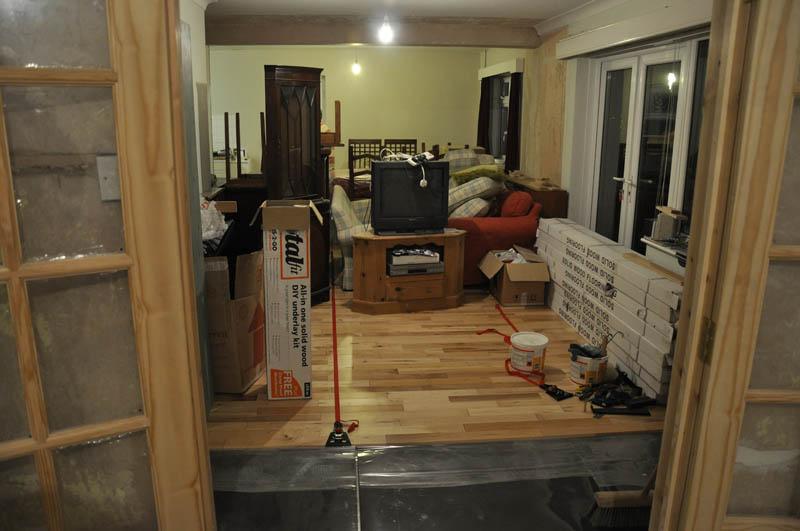

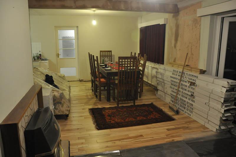

you can see the gap here (and around the rest of the room in fact) when the floor was laid 2 years ago. The gap round the hearth is probably the same as in this pic!:
Here is another image to give an idea of scale:
The room is probably 6m long, you can see the chimney breast on the left in both pics, and the bulge is approximately 8 boards wide, and extends out to the right of the TV unit in that second pic.

Those photos are 2 years old - not recent, so there is nothing stacked, and only the furniture remains. I just posted them to give an idea on layout, fitting, and size of expansion gaps.

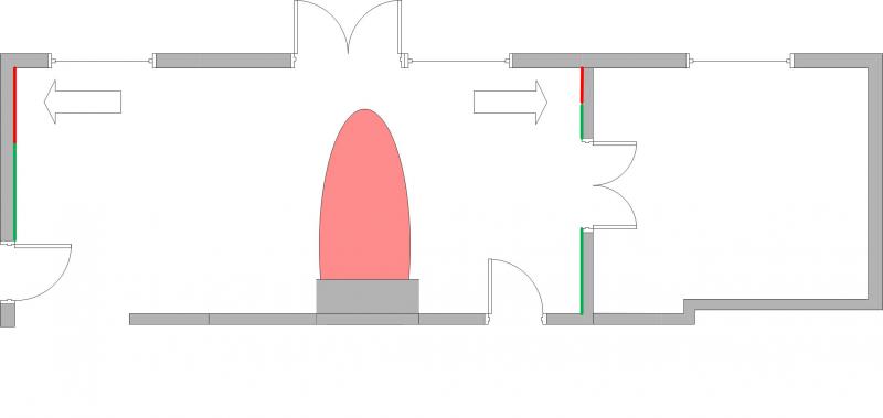

I do appreciate what everyone is saying, really! :D and I'm really not in denial about it :p Can I just sanity check what I've done / what I'm doing?
This is a plan of the rooms with the floor. It transitions between the main room and the study through the door.
There are no signs of damp, and no history or accidents / recent decorating to suggest it. However we are having a new fireplace fitted next week, and will be getting some plastering done, so obviously this couldn't have happened at a worse time.
The warped area is marked in pink around the fireplace - and it probably extends in that kind of pattern. The fireplace is the only part of the room without any kind of fixed skirting - there was a loose wood shround covering the expansion gap. Opposite the fireplace is the patio doors, with a step, and the transition has beading glued on, so I can't remove this, however there is no evidence of expansion around it.
We've put slabs (the new hearth) on the bulge to flatten it and push the floor back down to see if we can find where its stressed.
I've removed the skirting at each end of the room (and on any small walls, such as around the fireplace, etc) to check the expansion gap. Where the lines are green, the expansion gap was clear, and at least 15mm wide.
Where the expansion gap is red, it had closed up. I've now chiseled out to create approx 10mm expansion gap.
I haven't taken the skirting board off the study wall yet - I'm guessing that as the expansion gap around the door was still clear, it would suggest it hasn't expanded too far into this room, if at all.
I can't picture how a floor pushing into the 2 top corners would create a bulge on the opposite wall in the middle of the floor, so feel like I'm missing something, however the expansion gaps in green are completely clear.
Any thoughts? Have I done the right thing so far? anything else I could do?
