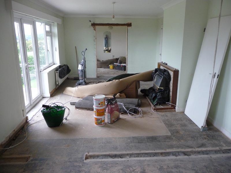

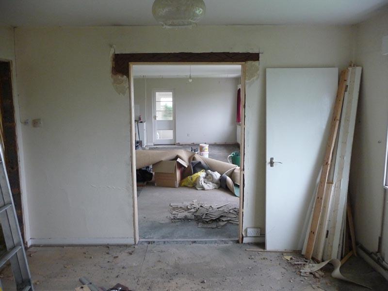

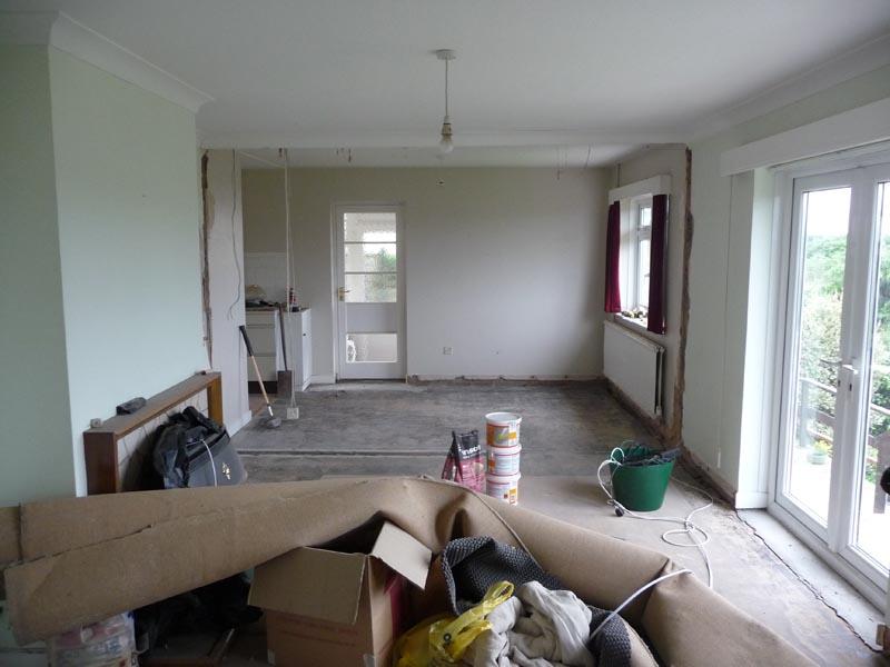

Now to a creative question.... These are the rooms I'm flooring:
As you can see its fairly long. I'm also exntending the flooring through the gap (which is now a door) into the study. All in all about 40m^2. I'd been advised it would be normal to run the floor length ways, but because of the length of the room I'm worried that it'll look quite stark and featureless. I was thinking of putitng a width ways row in every 2 meters or so, and perhaps run a width way row at each end of the room, and through the door to break it up and create a pattern.
Any thoughts?
Truly appreciate your help! :D
