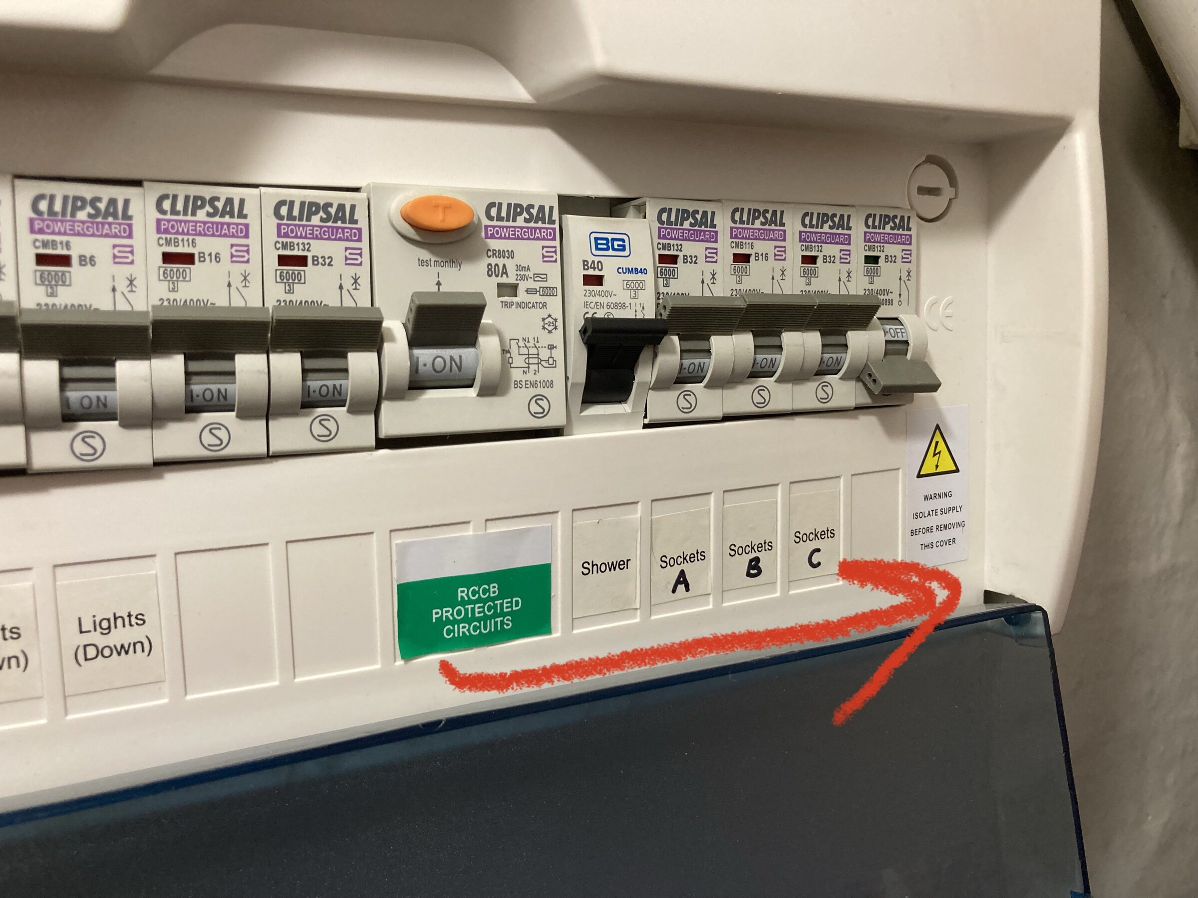

Asking for a relative - washing machine tripped the circuit this morning.
It isn't the socket or plug. It seems to happen a few mins into cycle when the water is heating.
Any washing machine people out there willing to say what order to check things next and hopefully find the fault? (my next thought is that water might be leaking or the heating element has gone faulty)

Update on this, for sake on completion. The machine trips as soon as it's turned on.
So, I doubt we are going to spend too long on it - it might be time for a new one. I might take the back off and check the brushes , and have a quick look for obvious leaks.

Switched on where, socket or machine, if the socket it's worth a look at the suppressor & any wiring fixed to the frame of the machine that run from the input to the front.

Yes, soon as switched on at socket.
Thanks , I will give it a look over
What kind of multimeter test can I do on the suppressor ?
Disconnect the output first & see if it still trips, if not it would seem like an internal short circuit in the suppressor no need to test with multimeter. Not sure exactly what sort of readings you should get across each pair of terminals, but not short circuit obviously. Are you talking about an mcb or rcd tripping. If rcd look for short to earth from each terminal.
I'm going down there later today so will check all of this out, thanks for reply
Ok, there was no problem when the suppressor was disconnected , so the fault is further along. It was beyond my knowledge to check anything else except the brushes , but upon inspection the motor is 3 phase induction motor, so I dont know what to do now, but maybe let my son know to buy a new one? (and get a long warranty)

What make & model is it, I've never worked on a machine with that sort of set up, as I said the only other simple thing you could check is that the wiring harness is not chaffed & shorting to casing. You still haven't said what is tripping.
