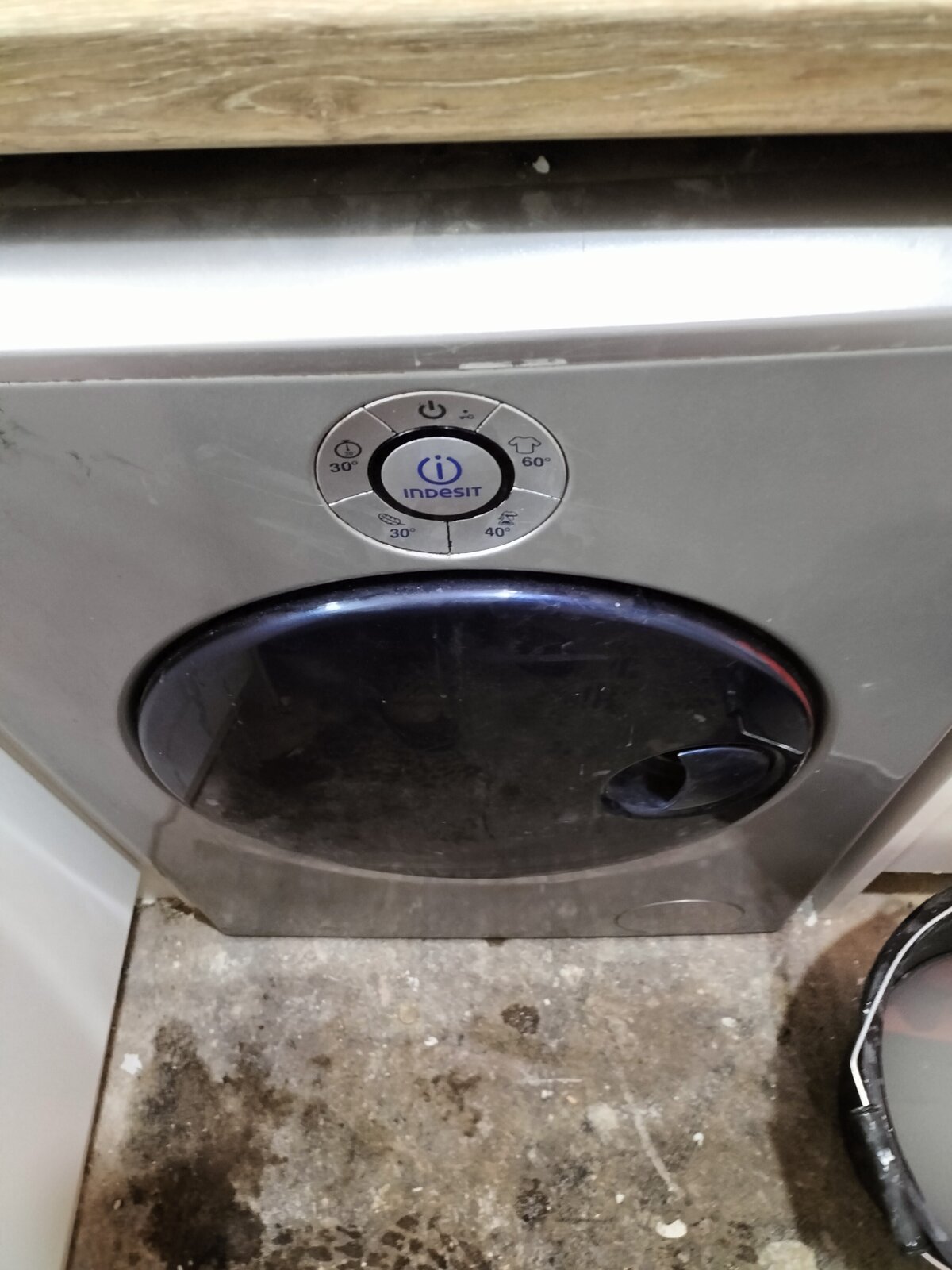

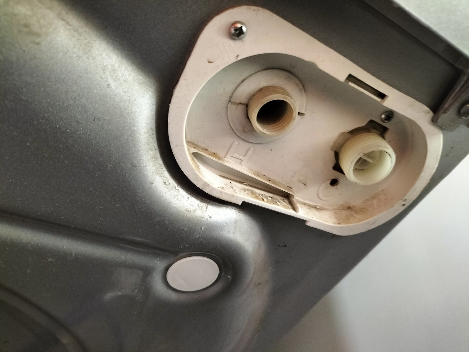

Does this need a cold and hot feed or will it work on cold only? Any need to cap off the hot?

You could connect cold to both if that is the only supply you have.
You used to be able to buy a Y adaptor, to enable both inlets to be fed from the cold. It will work fine, fed with both inlets from cold.
There is a hot there does it need hot or would it work ok on cold? But there would I have to blank off?
Easier just to pipe to both?
It will likely need water flowing in via the hot connection, yes. With no water going in at all, it will likely stall the machine. It will turn on the hot valve, then expect to mix hot with cold, to get the water temperature down to the correct temperature. If the water is too cold, then it will heat the water up, then begin the wash.
Blank it off - no, there should be no need.
Yes! It seems the only way..
Washing machines used to use/need a lot more hot water than they did, so they had hot and cold fill. More modern ones use so little, that by the time the hot has progressed through the house pipe work, to the machine, a lot of hot will be wasted. So modern machines do not usually bother with a hot connection.
